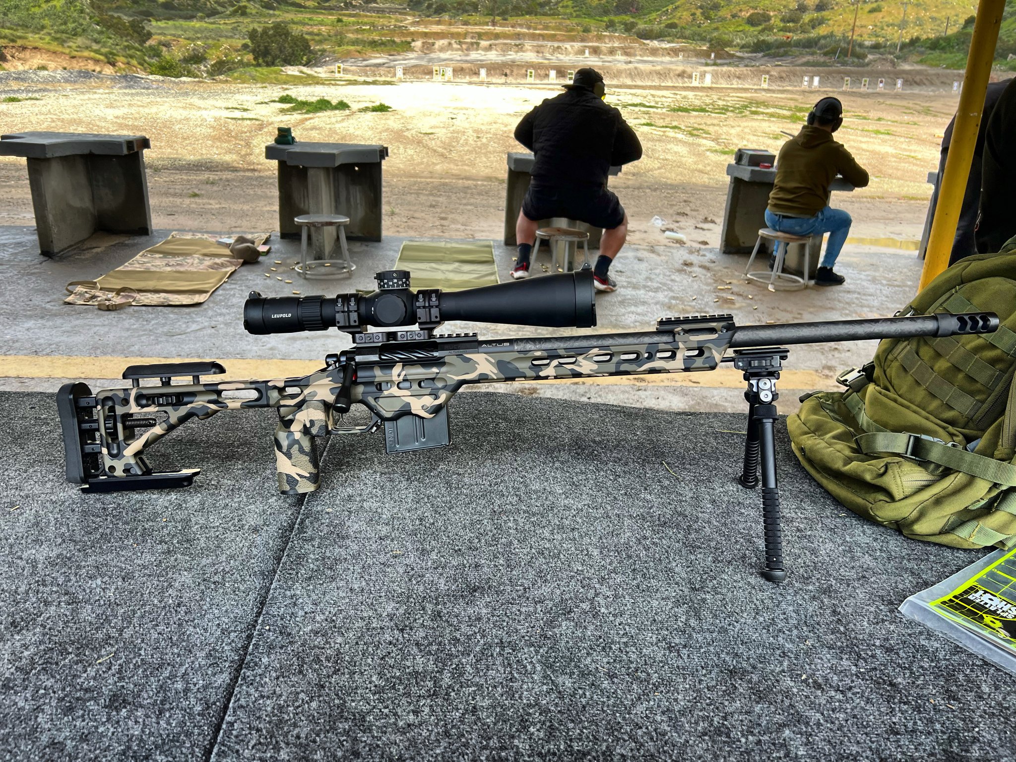

Hey guys ok I need some help.. my rifle is pretty accurate, and i have a leupold mark5 attached to it.. I’ll post a picture of my groupings.. but I’m having an issue, my scope is literally on the lowest setting for elevation, and I can’t get my aim right.. I have to hold under almost half a mrad to hit center.. why??? How can I fix this?? I have had a “prs shooter” try to help me figure it out but we couldn’t get the new zero lower than it is.. any suggestions????

Why is your mount so far back? I am going to guess you have shitty body positioning and eye relief. Please take a class on how to shoot a precision rifle, they will teach you how to setup the rifle. Your scope is like 3-4 inches to far to the rear.
In the picture it looks like you have a lot of gap between the upper and lower rings..... is it like that on both sides? What is the mount?
