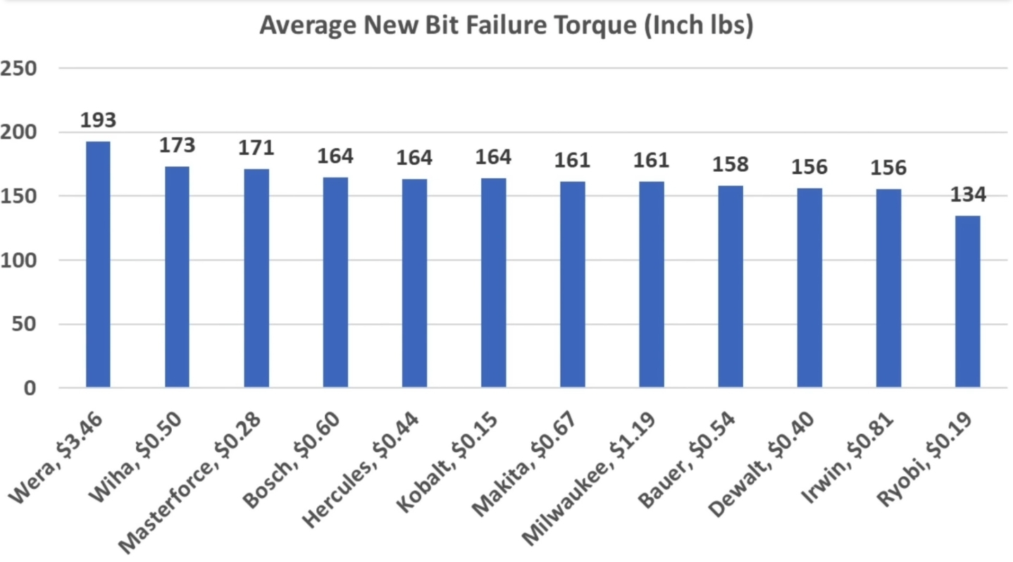

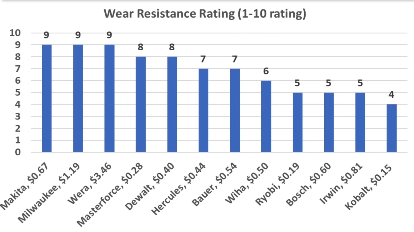

From Project Farm video:
(Wear resistance is shown on video but the scores are subjective, not measured.)
I know, not 1/4 bits but this data should correlate at some level.
