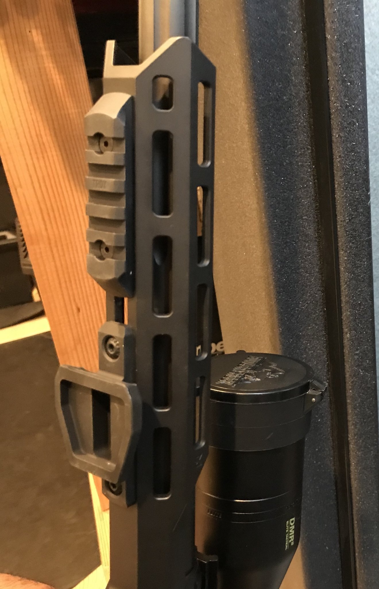

    I also have the 3 slot stealth chassis. Ran into the same issue. Not sure what your friend’s skill levels are, but it didn’t take too long to mark, drill and tap the chassis to move rails and plates farther forward or rearward on the fore end. Now I can run the rail for the Atlas, as well as the tripod plate.

    Guys, I appreciate all the responses. @Spblademaker we had the same thoughts as you when looking at his chassis. I imagine milling an additional M-lok slot shouldn't be too difficult, if it can be done in the area where the sling stud hole is, which is where you appear to have yours. I didn't think it would be too hard, since I believe Magpul gives you the specs for the slots on their website.
    Yeah. I did one where the stud was. And added one towards the magwell too.
