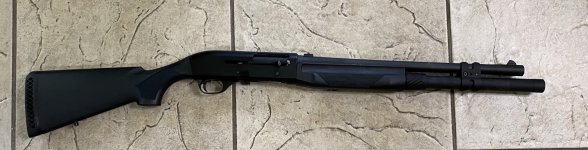

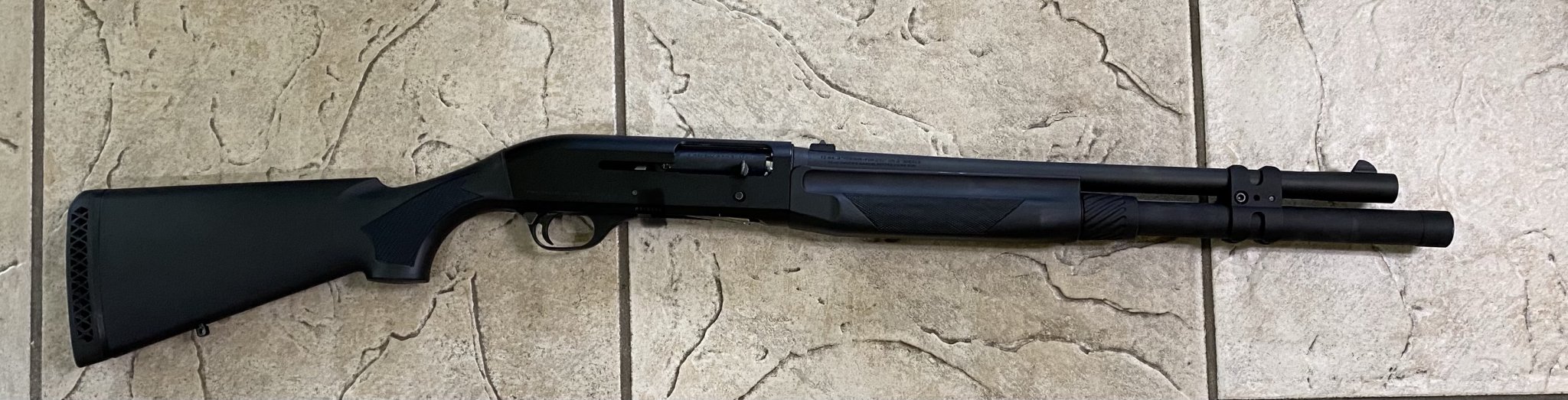

Terry, just a thought shotgun ammo has improved a lot over the last 15 to 20 years and all brands are not created equal try some different types you will def get better groups than you did years ago. also with screw ins if you have a full choke tube in and you want to switch buck to slugs on the go you might not have a choke in when your done and stripped threads on your barrel. I have 2 benelli's a hk one the first year they were imported and a custom cut job it has around a 10 in barrel they have served me well over the years im retired now but i still would not sell them.
