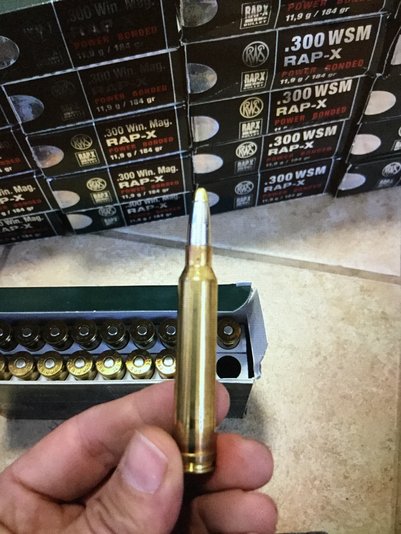

RWS as an average,makes robust brass(thickness/metallurgy).
I'd pull bullets,toss powder and drive an initial false shoulder...rather than be at the mercy of the belt.
Hint.
Drive an initial false shoulder? Please elaborate. The bullets in them are 184 rap-x and I have considered tossing the bullets, neck sizing and pushing some 178 eld-x in the. And leaving them long to make sure I am not hot on the charge.
So...Let me get this straight, your going to pull the factory bullet drop in a completely different bullet and call it good?.....If that is your plan do us all a favor and don't post in the reloading section why won't my load shoot..... SMH.

You are simply doing the oldest of Sillywet moves and contemplating building Mexican Match,which is an ancient standby. Standard fare to yard out shit projectiles(typically MilSurp Ball Ammo) and replace same with a bullet of repute. Have done it bazillions of times,though my preference is to yank the expander and grab .003" of constriction with a bushing die,to add uniformity and reduce ES/SD.
A false shoulder is something very different and the best way to afford finite control of headspace. It involves bumping necks to a greater bore diameter and then bringing them back down partially and using a portion of the increased neck diameter as a positive headspaced shoulder to index Virgins with.
1000 words.
Using 308 donors to yield 243AI Virgin form loads. As a rule,I tend to source Virgins in a greater bore size when possible,just for finite headspace control,out of the gate. Precision is bolstered as is case life.
Belted cases are amongst the worst offenders in excessive headspace Virgins.
Hint.
ive already got the round I want, don't see the need to do what you have done in your picture
