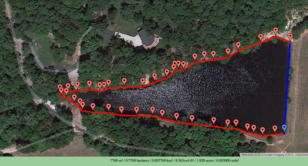

Here's what I use to measure acreage.
ACME Planimeter
For example, my pond.
