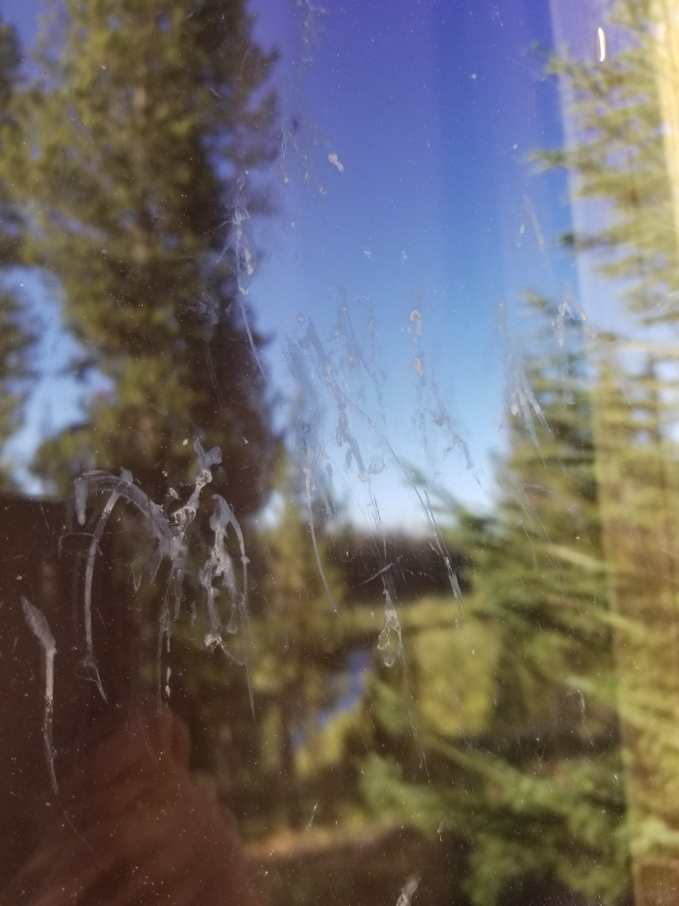

Here is a Grizz that attempted to gain entry in our spare bedroom. Permanently scratched the window surface, luckily the window is about 6' high so he wasnt able to shatter the glass. This is the second time it's happened.... we definitely have to be cognizant of Grizzlies to include securing bbq grill, door and window entries etc.
  • Wow
Reactions: shoobe01
