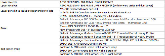

Happy New Year everyone,
I'm currently contemplating in building a budget AR10 for non-competition shooting. I would like to be able to shoot it in a standing and with a bipod and achieve a 1-2 inches MOA groupings. Currently, I have some parts that I came up (not complete) after doing some research and would need your opinion/suggestion on the barrel and BCG, which I have only little to no experience on the subject. Please check my currently parts list for my budget build
Thanks
So for accuracy on ARs, what matters is the barrel, that it's free floated, YOU, ammo, and the trigger. The rest doesn't matter that much (so long as it's all torqued right and at the minimum spec obviously). Some argue that the bling bolts (i.e. from JP) make a difference. Ive yet to see an empirical test, only mere theory.
I say as long as it's a new bolt that meets minimum specs (which it ought to be anyways if they're in business), you're just as fine as the rest. The carrier by itself makes no difference in mechanical accuracy.
Literally any Faxon will be near 1MOA with factory match ammo, from their pencil budget barrels to their "match" line (experience, plus skimming over the years on ar forums). I have heard mixed thoughts on BA, but i would expect <2 minutes with match ammo if you do your part.
Dont overthink the BCG.
Thank you for responding to my inquiry regarding my project which make a lot more easier which to route to take on the barrel. I was reading the build tread in the room and most of the builds are way....y out of my league. Some of the build that I saw, just by the price of there barrel alone is already 3/4 of my budget but the toy(s) that they have are nice :love:. My current plan is to piecemeal the parts and hoping to finish it within 6-12 months, if budget approves.
Faxon or BA - barrel
Toolcraft - BCG.
