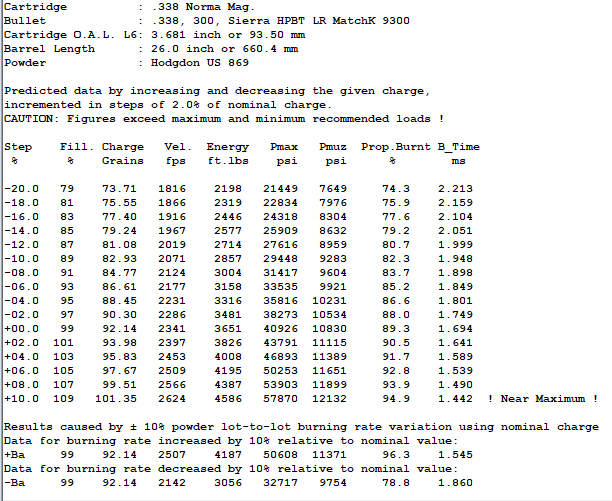

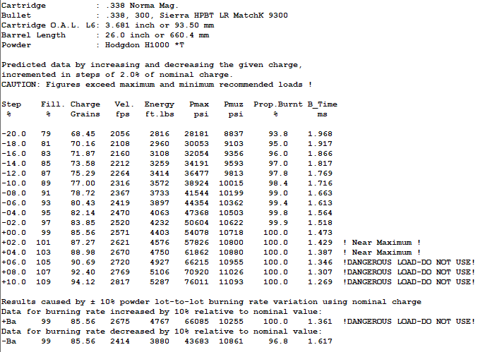

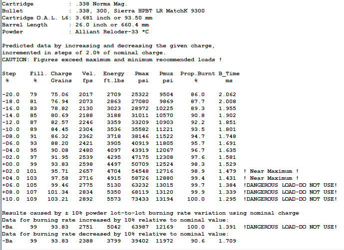

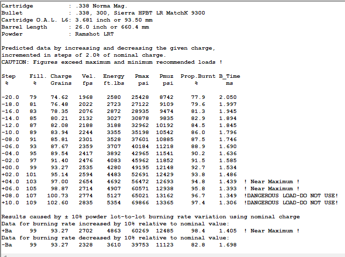

I need some QL help if anyone can provide, specs below:
338 Norma, CIP not SAAMI
300 grain SMK, Norma CC and/or Hornady A Tip
Peterson Brass
26” barrel
Powder on hand:
IMR 7977 and 8133
H1000
RL33
LRT
US869
I’m sure there is more info required that I’m not aware of and will get it if needed. Any help would be greatly appreciated.
Thank you
I'm your huckleberry....
Keep in mind, Quickload is NOT a substitute for checking loading manual data; it's just a tool to help guide you.
