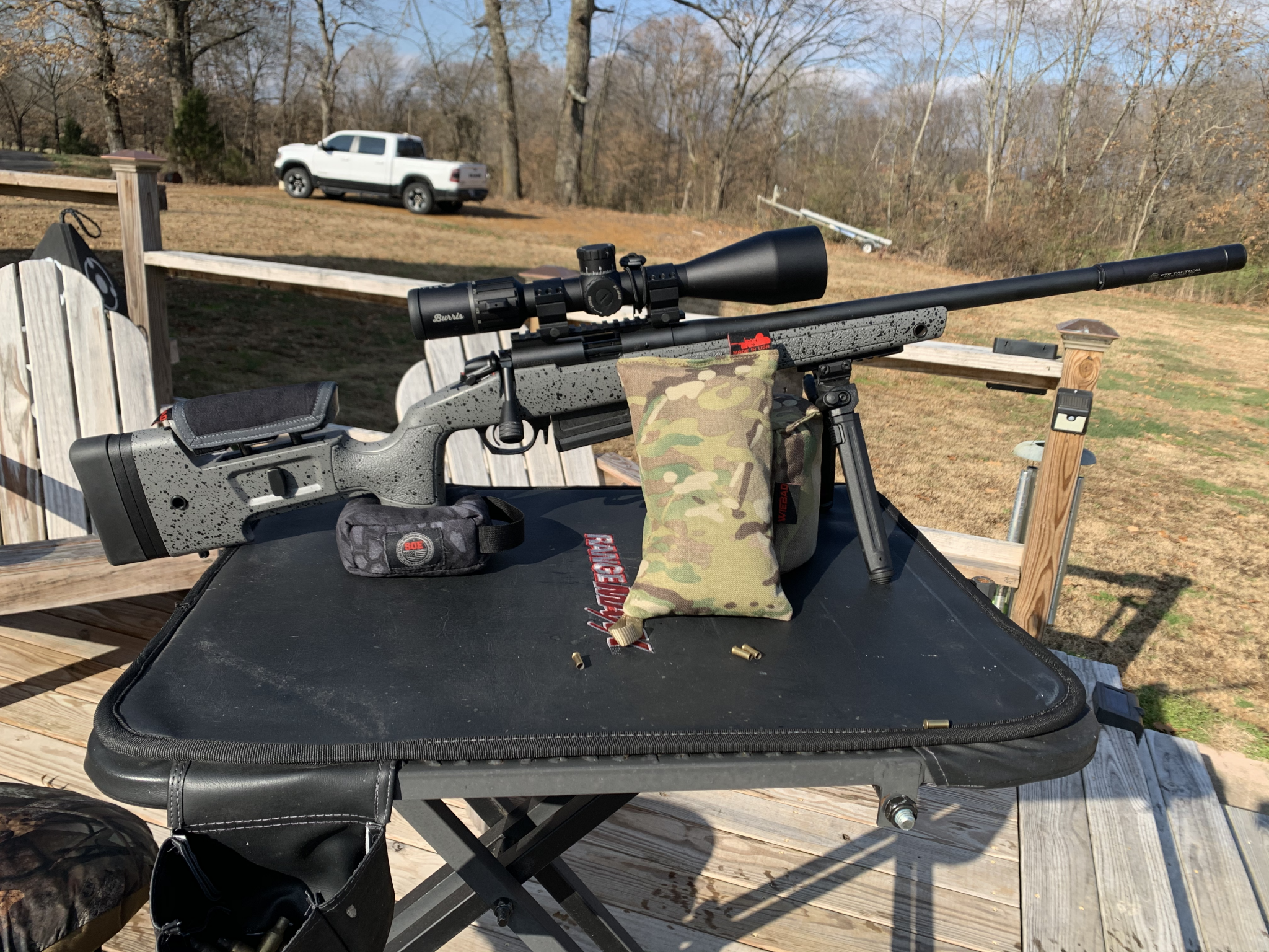

    I am running a 20moa LaRue on mine. I have the Burris RT25 with XTR Medium rings and have enough adjustment in the optic with a 50 yard zero to do 300 yards. I just replaced the rings with Lower Warren Tac rings and should have enough to get to 400 without holdover. I will find out this upcoming weekend if I get my rifle back from the Cerakoter on Wednesday or Thursday.
    • Love
    Reactions: x2cross
