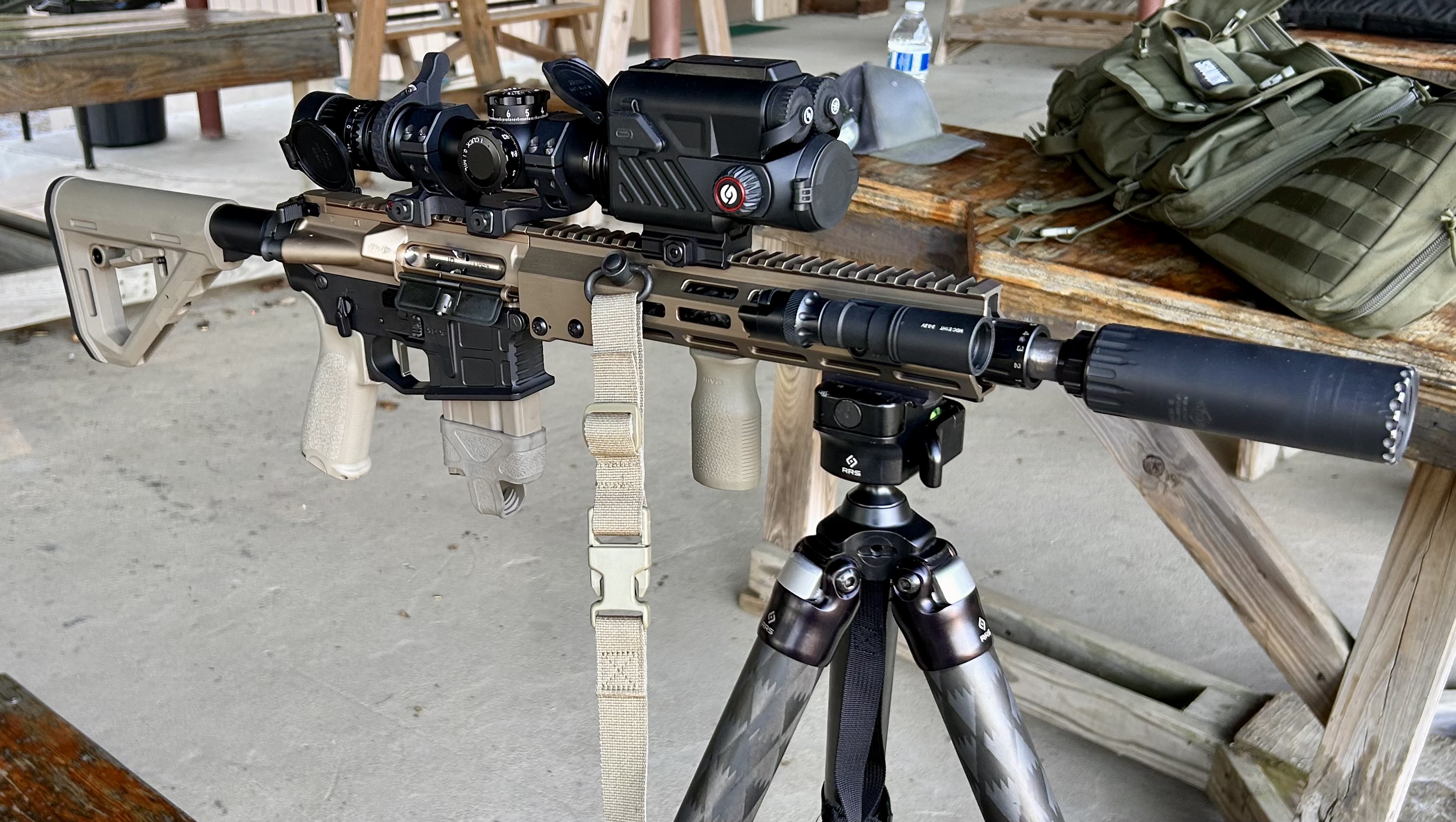

I went with a 12.5 Grendel. Barrel is Proof CF. I'm shooting Cavity Back Bullets factory loads 105 Grain at 2477fps. I set this up as my walk around daytime hunting rifle for hogs, deer, coyote on 200acre ranch in South Carolina and have a separate rig set up for night time Thermal. I did try a Guide 630 LRF thermal clip on last weekend and made hits on steel out to 500 meters. I use a 50 yard zero to get a decent MPBR out to 250yards. I would have no problem using this as my one and only rifle but I have a 6.5 CM with a Trijicon Reap IR that crushes hogs off a fixed platform for when I'm sleeping out all night.
12.5 Proof Grendel105 CBB
BC G10.48
MV2477actual
Weight105
Temp80
Wind0
Zero42
RANGE (YDS)VELOCITY (FPS)ENERGY (FT.-LB)TRAJECTORY (IN)COME UP (MILS)
024771430-3.000.00
50239013310.380.21
100230512382.250.63
150222111502.480.46
200213910670.960.13
2502059989-2.47-0.27
3001981915-7.94-0.73
Reactions: WeR0206

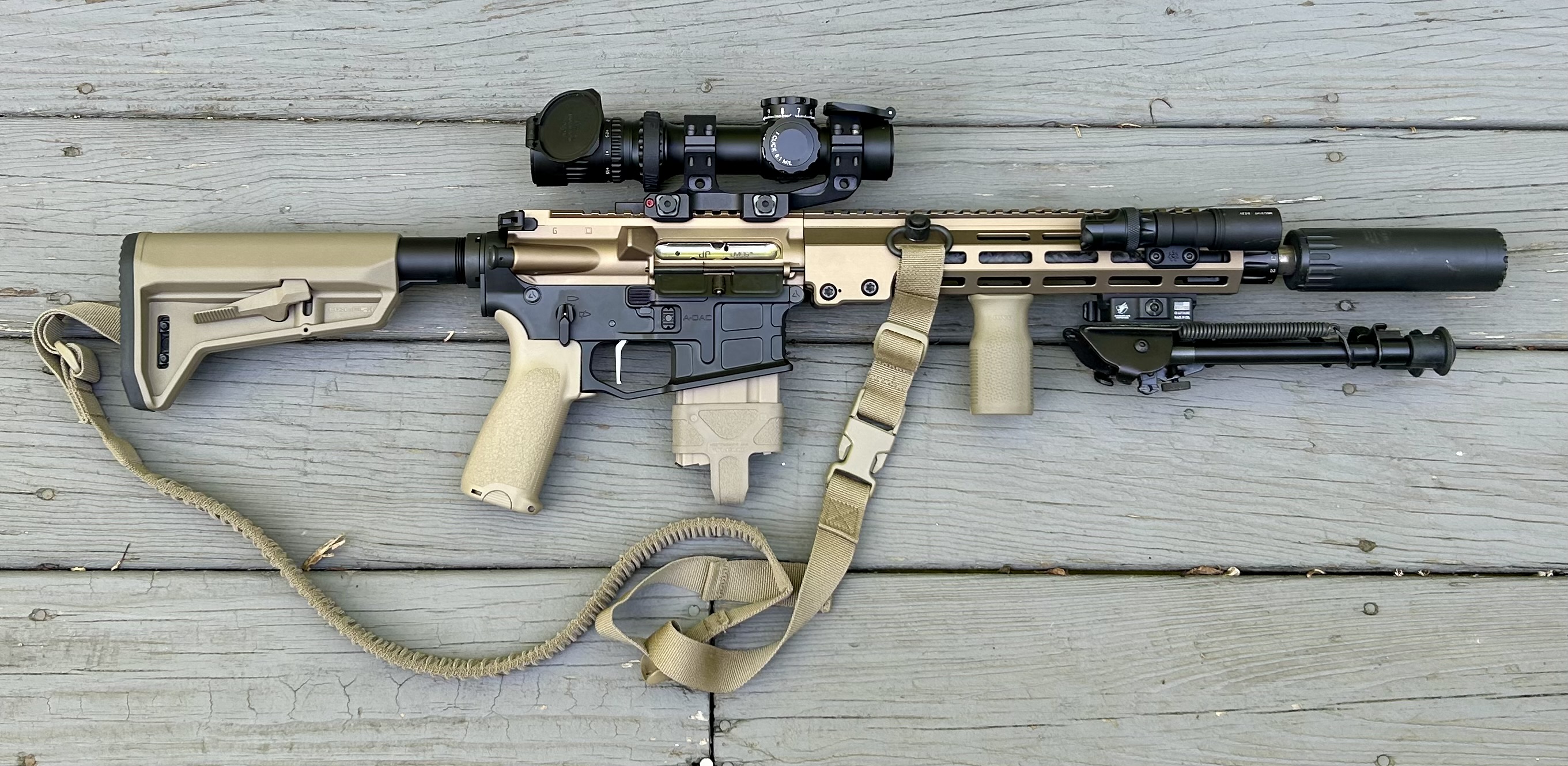

My main deer rifle for the last 14 years is a 12.5" 6.8 with an ARP barrel. Mid length and with an adj gas block works great with a can. My HD gun is the same setup but with a .223w ARP barrel.
The same length in a 6.5g or 6arc would work also.
