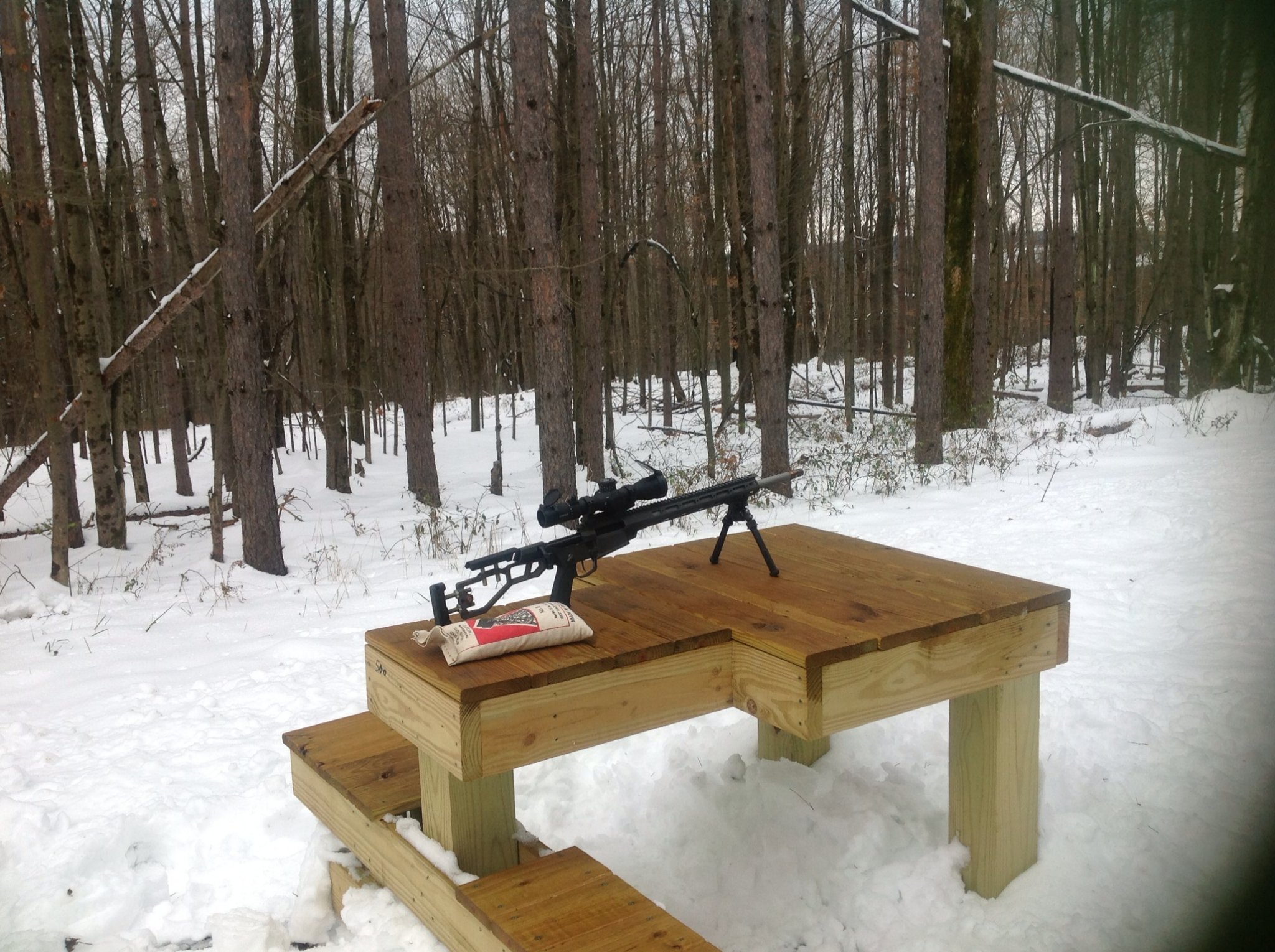

A local shooting range has a shooting bench built from a picnic table. It's modified into a T shape to allow shooting from left or right side. It also allows for prone shooting, and you're not lying on the ground. Pretty neat idea.
Another benefit when shooting from the sitting position is you can almost get perfectly straight behind the rifle.

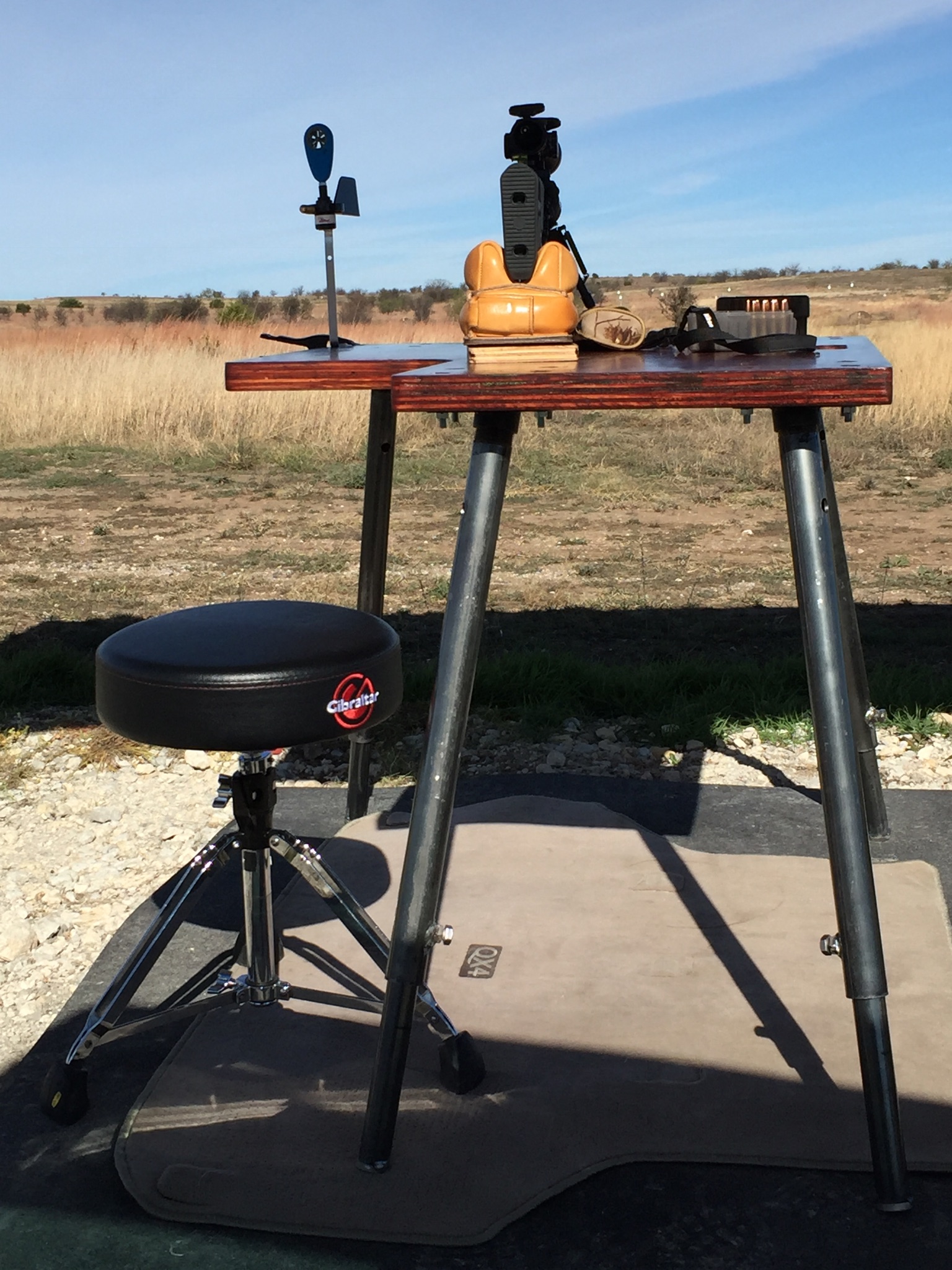

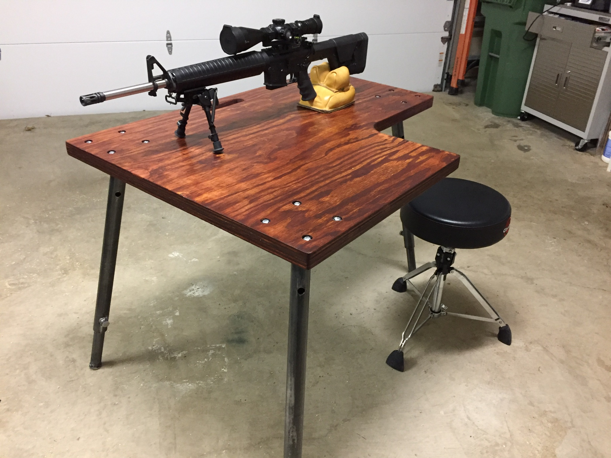

My bench is portable made from two thicknesses L-shapes of 1” plywood glued/screwed together and 2” pipe legs that thread into floor flanges that are attached to the bottom. The bench is very stiff and stays put even when shooting a heavy ass 50bmg. I also rounded the edges with a router and put on some stain/polyurethane to keep it in good condition.

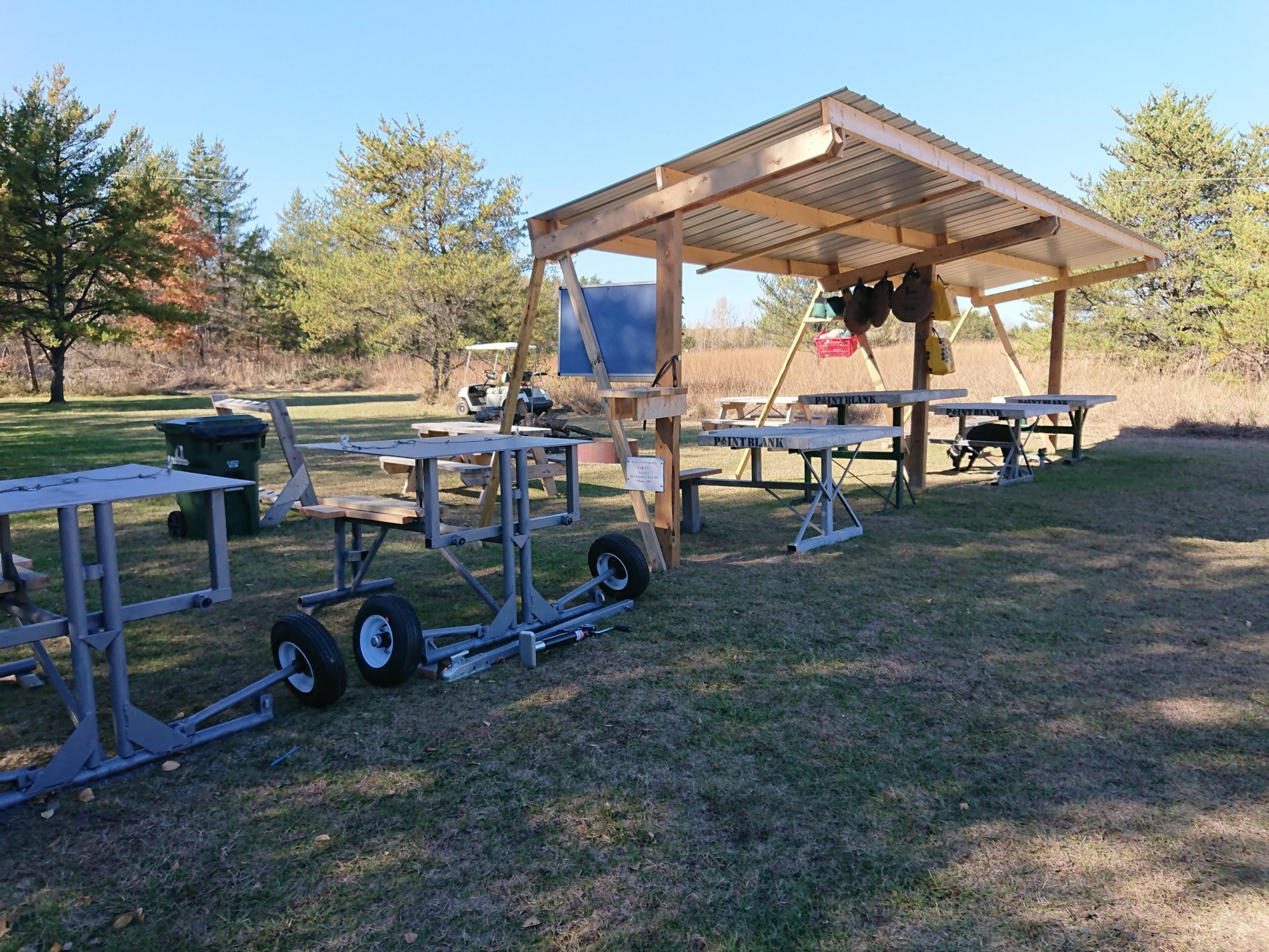

Here are 2 examples, welded steel, trailerable benches on the left, and poured concrete with steel bases on right. Concrete benches weigh aprox 600+

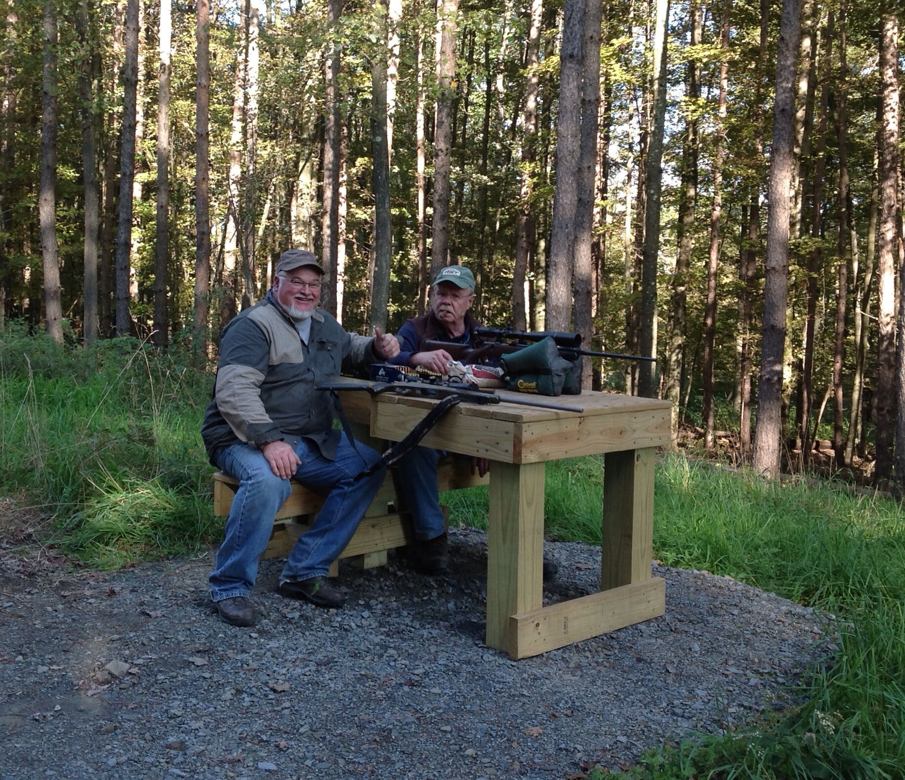

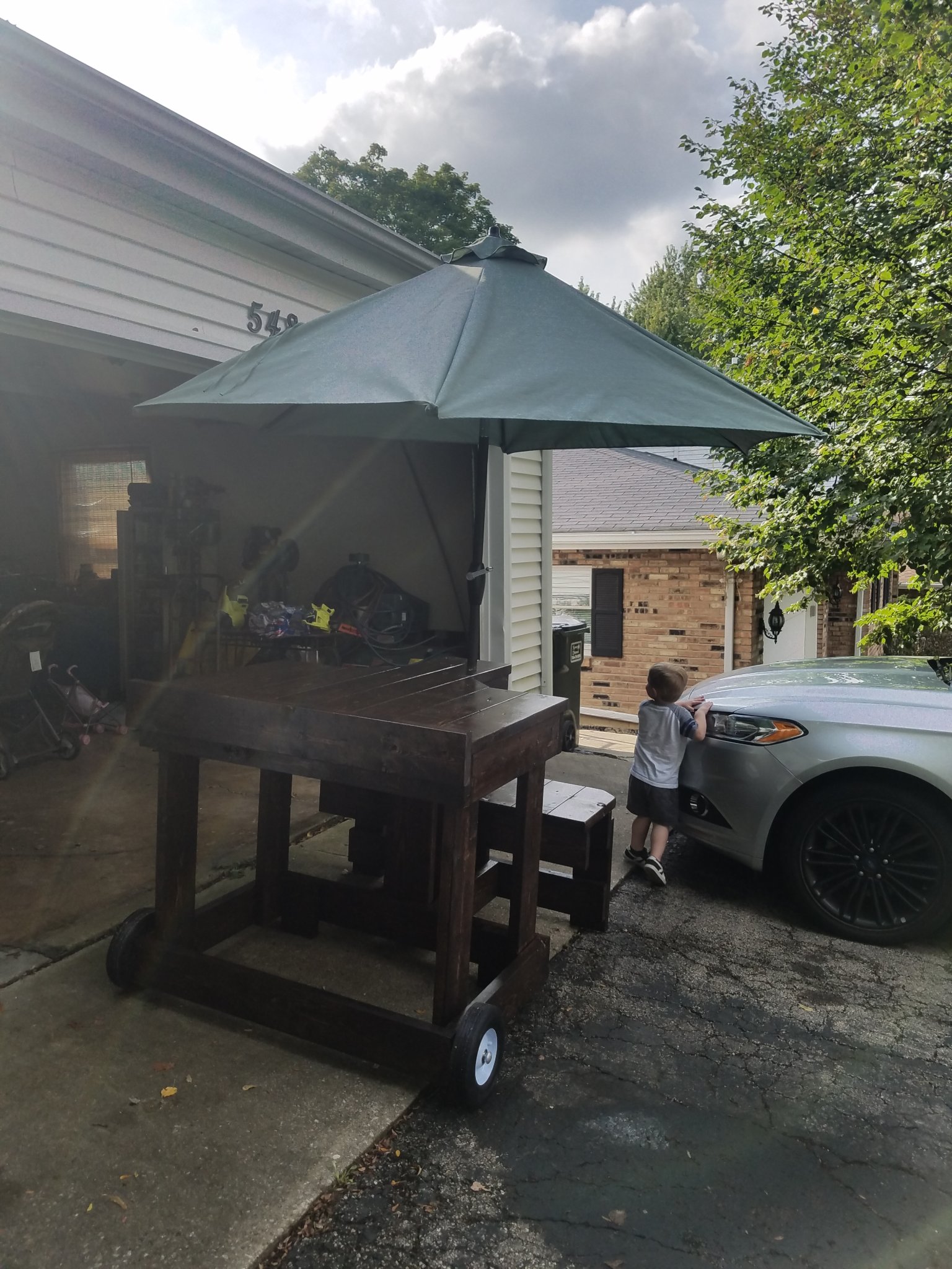

Built this one last year based off of a YouTube video. The wheels and umbrella were personal touches.

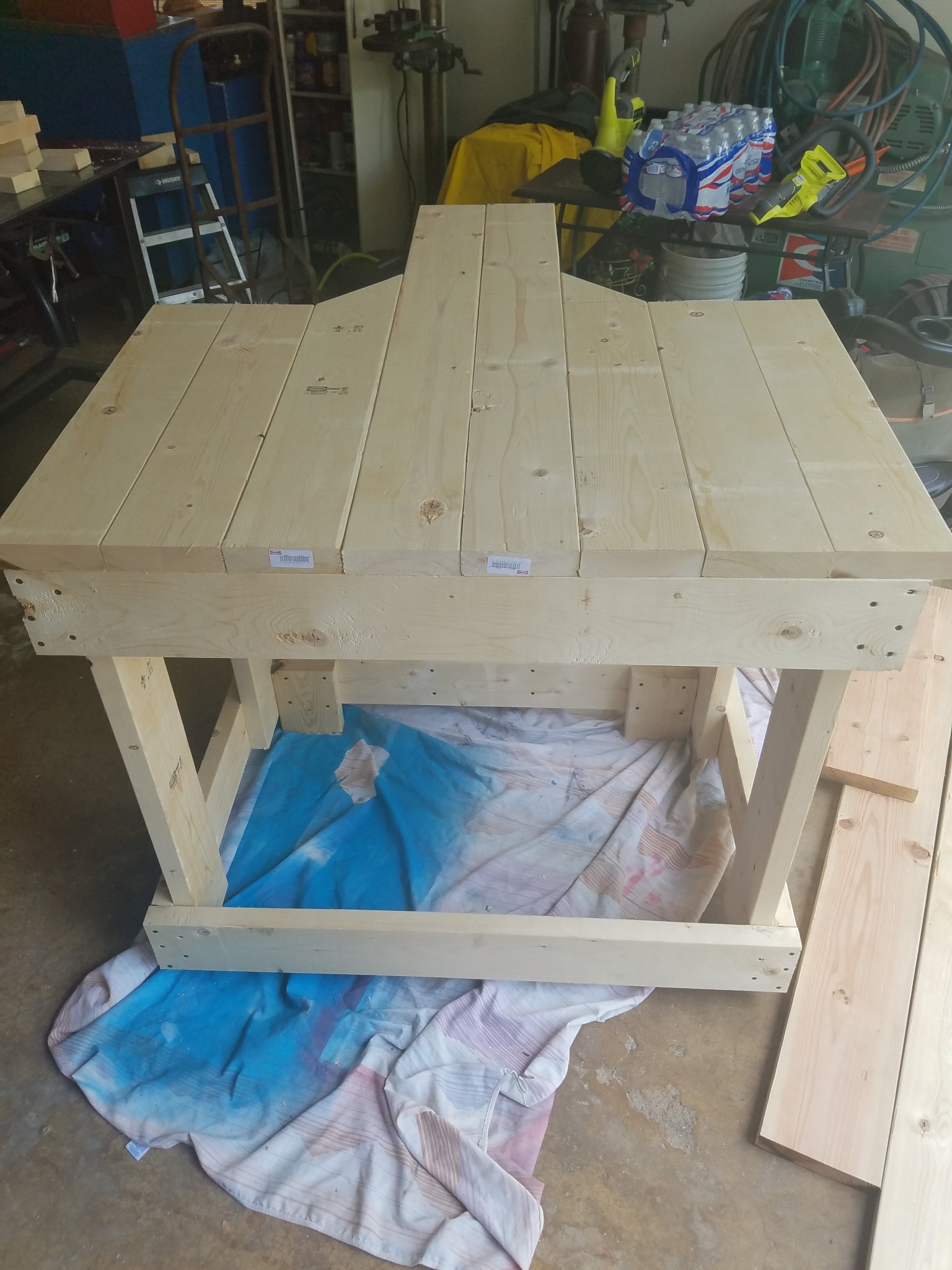

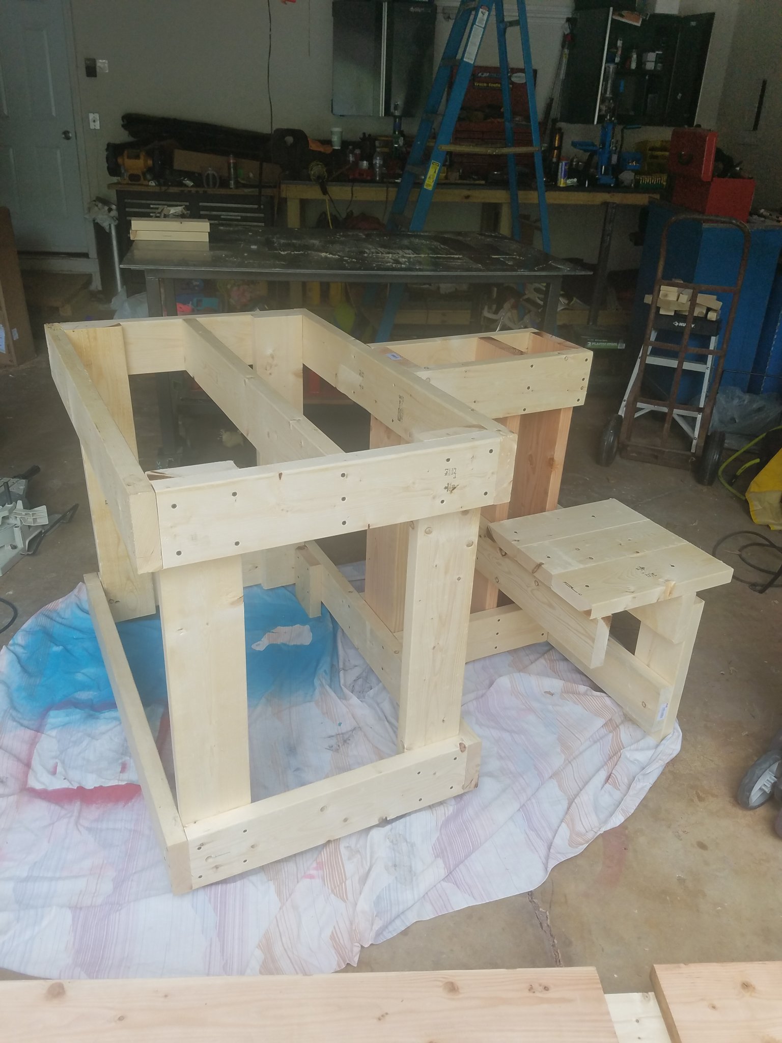

Did you decide on a particular shooting bench?

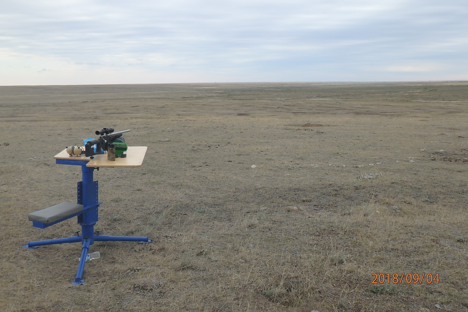

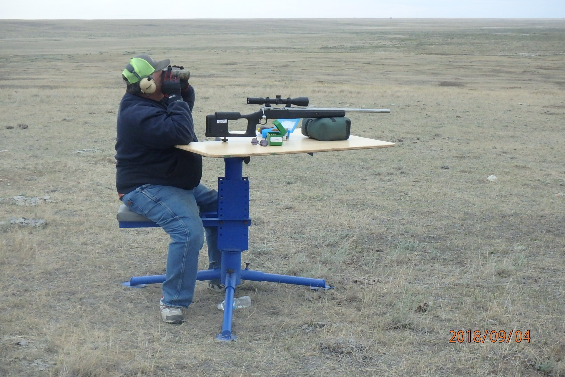

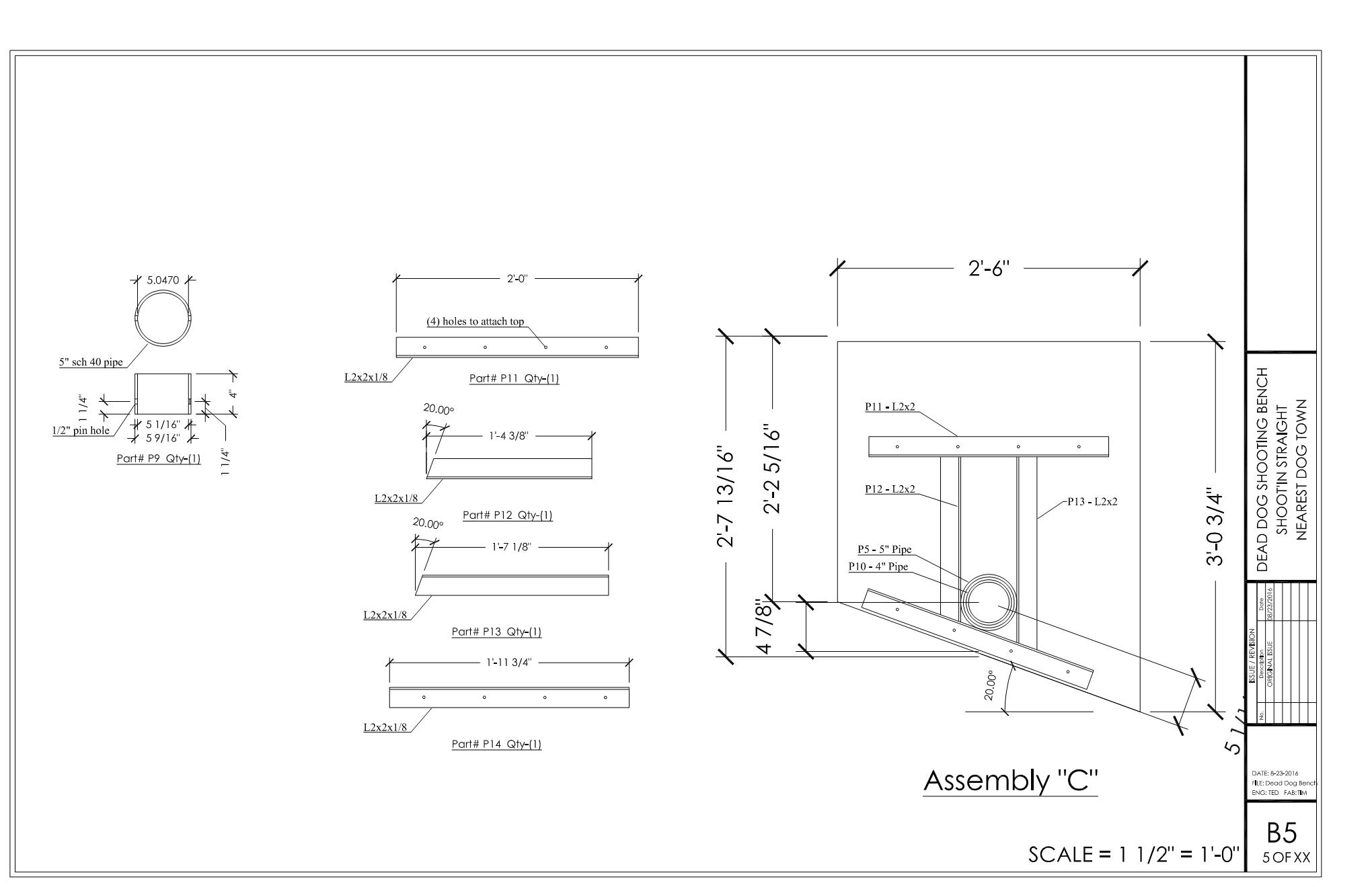

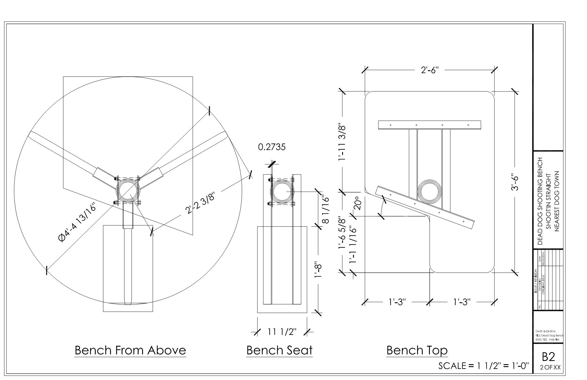

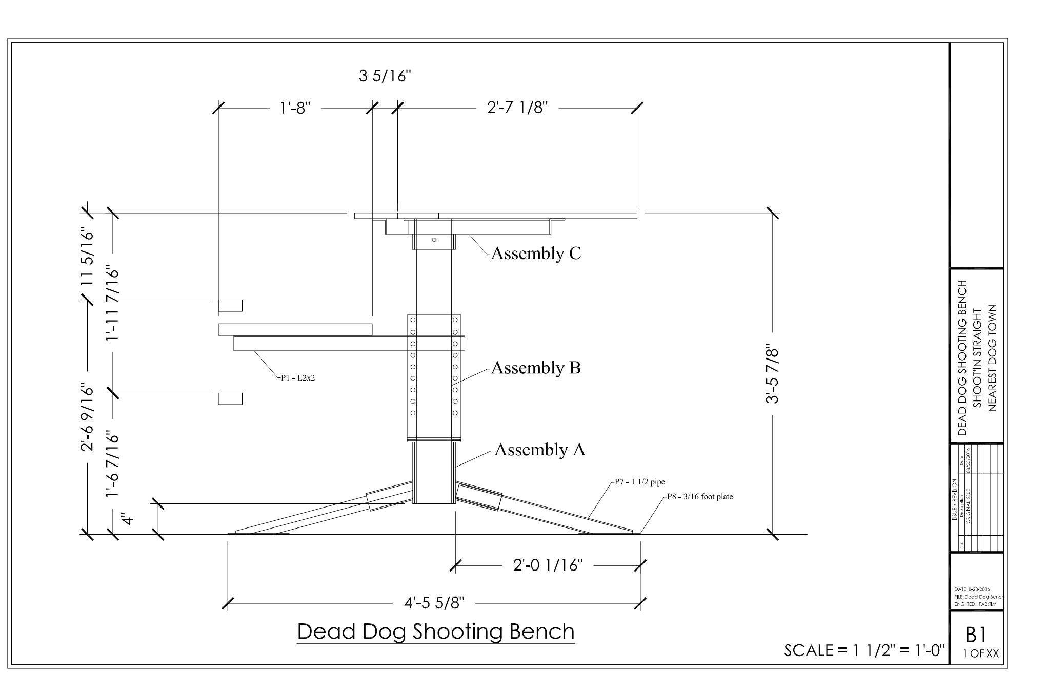

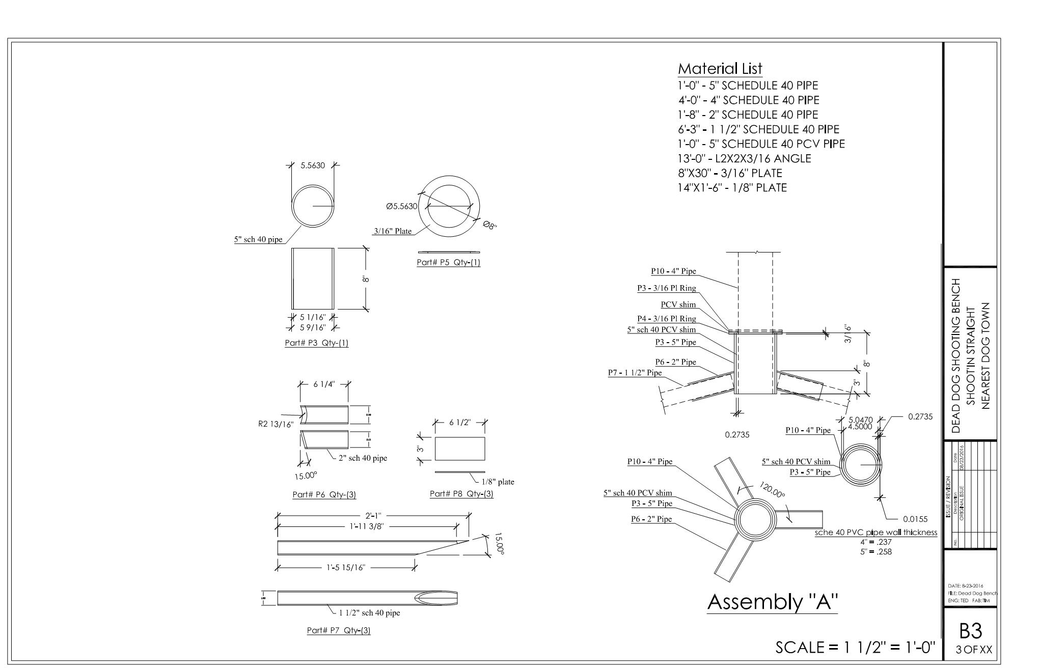

Here are the shooting bench my buddy and I put together a couple years ago. These are great because the can swivel and the height is adjustable. I know these are not a wood design but thought I would share so you can take from it what you want.
Here are the Drawings for this bench. Be careful, its about 50# when done. If I build another one it'll have lighter, thinner material.
Ted's Design Projects23 B1 (1).jpg Ted's Design Projects23 B2 (1).jpg Ted's Design Projects23 B3 (1).jpg Ted's Design Projects23 B4 (1).jpg Ted's Design Projects23 B5 (1).jpg

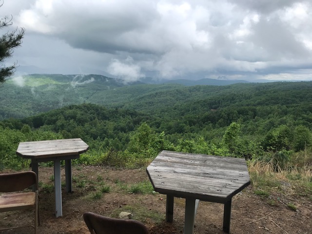

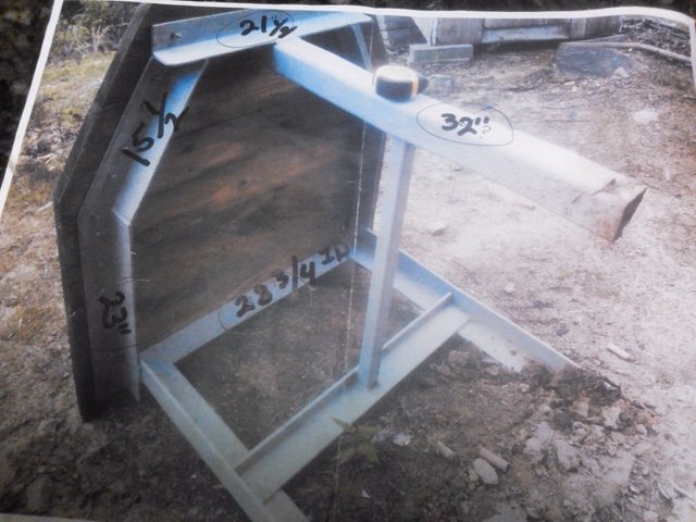

Here is a quick shot of the DIY bench a neighbor built on our family farm. Not the fanciest but it is solid as hell and can take the weather. Seat swivels and pivots on the rear leg, very easy to get comfortable and hit steel from 100-600 yds.
I can take more photos of details next time I’m out there.
