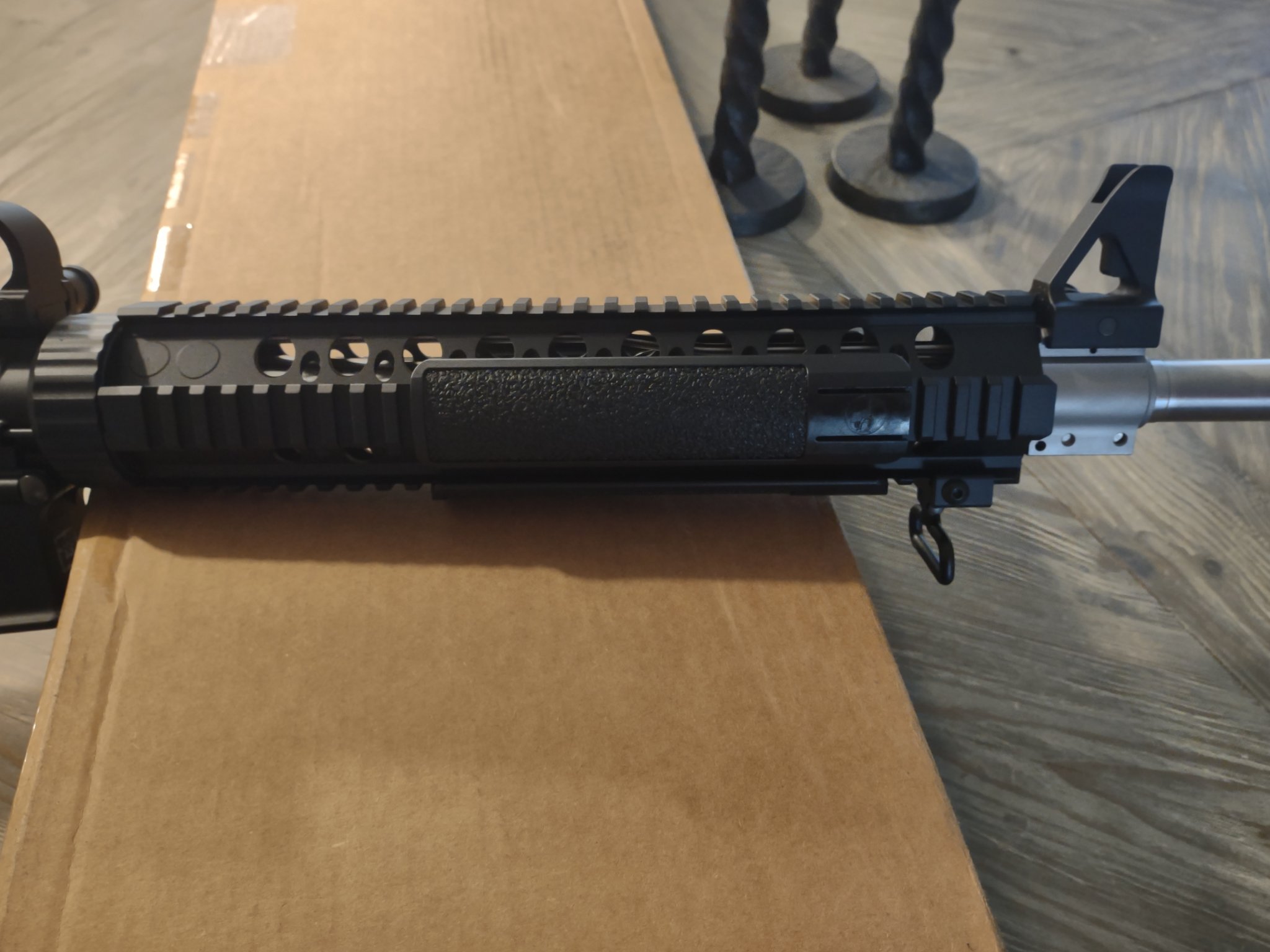

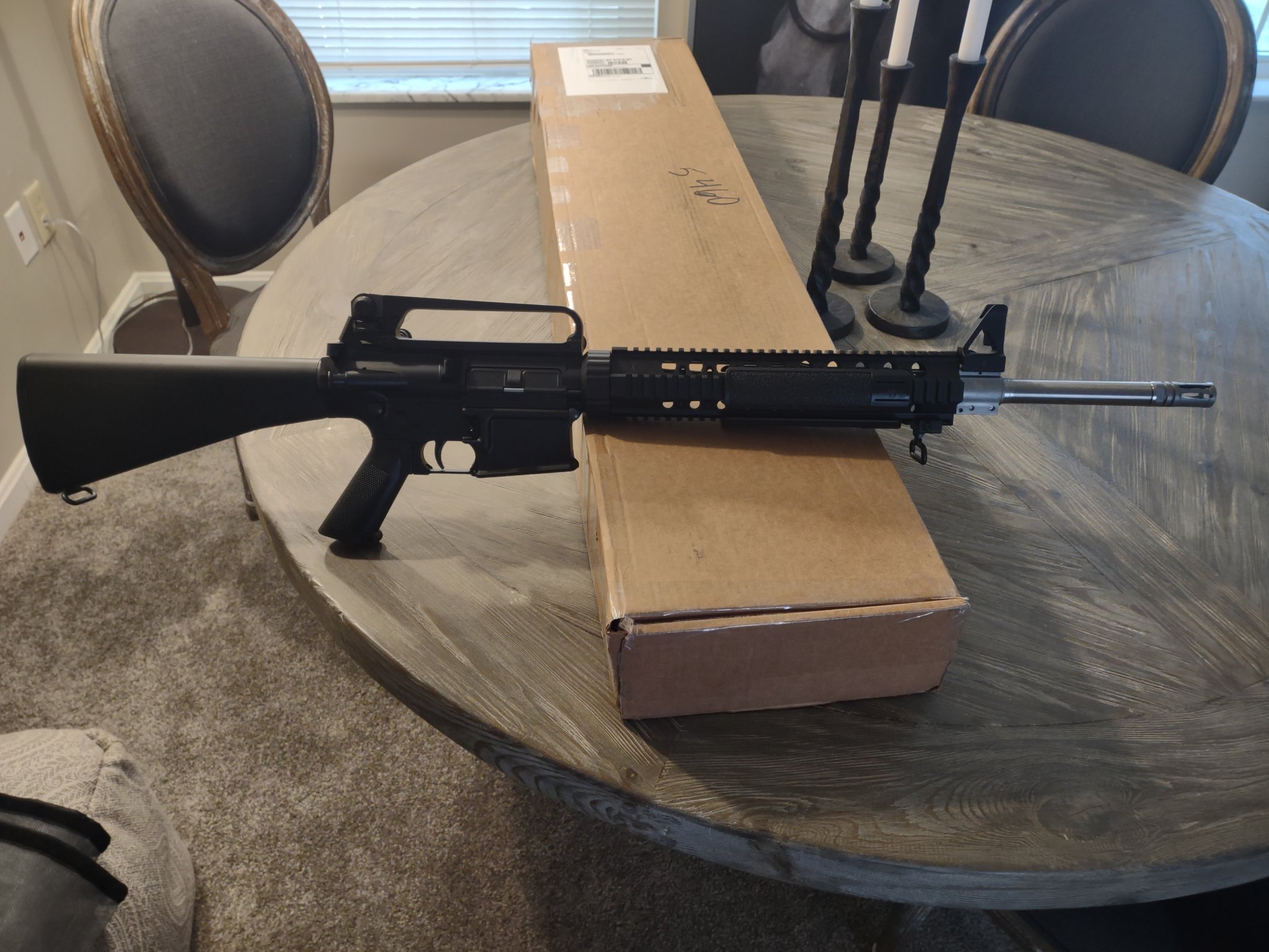

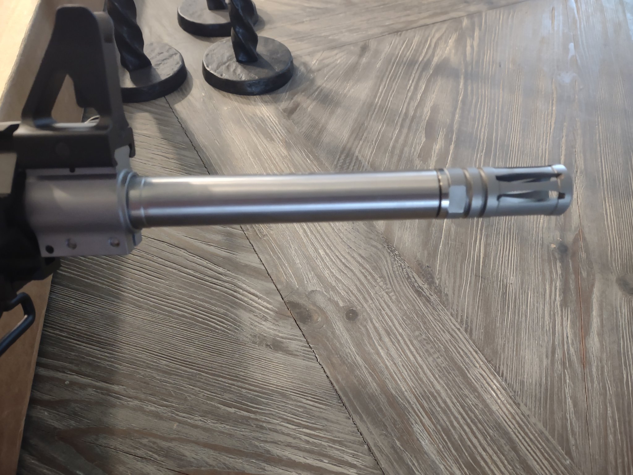

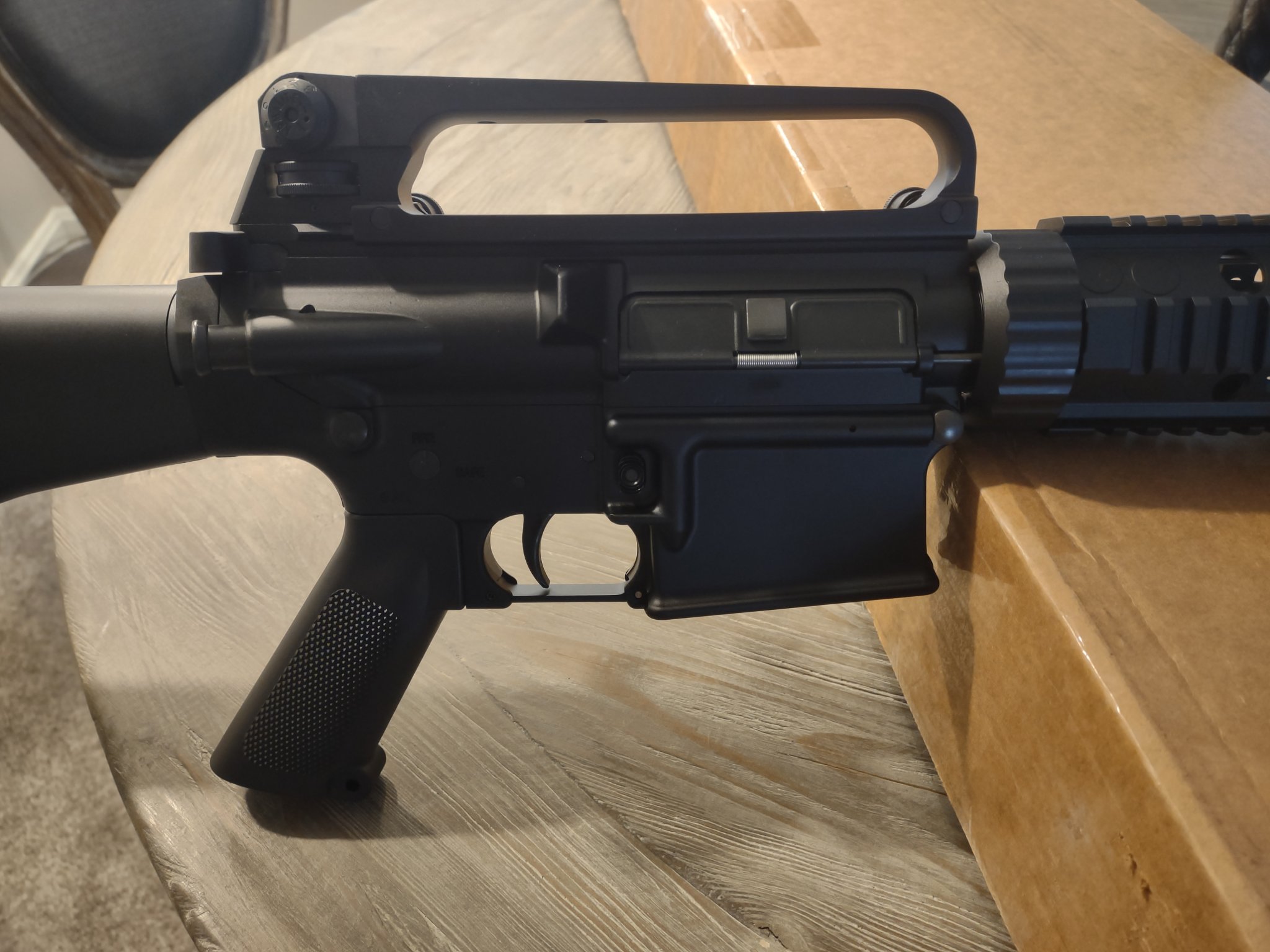

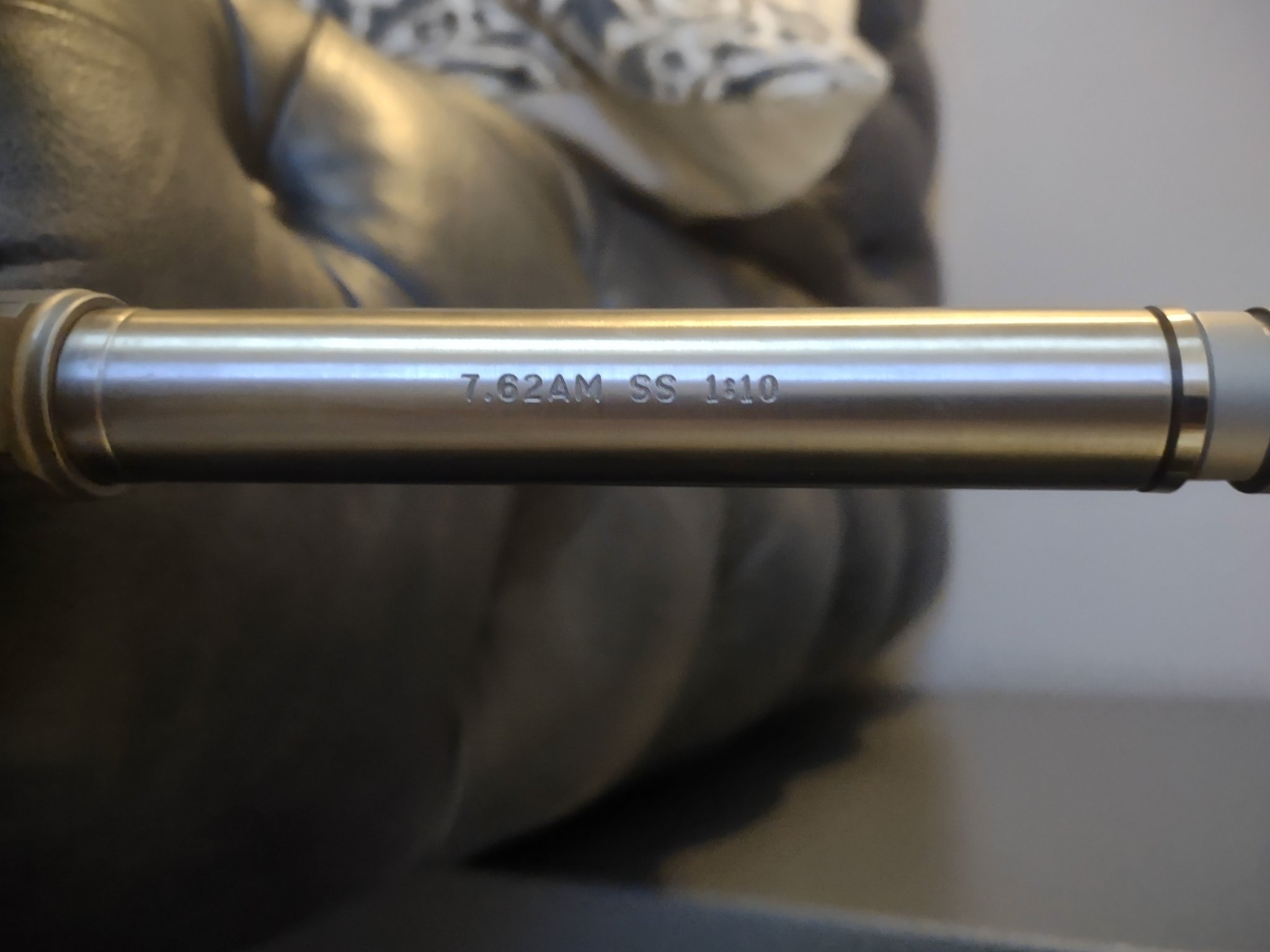

    I bought a new in the box older Armalite AR10 National Match rifle not long ago. My use for it is to do some target shooting and a little bit of hunting with it also. Right now it is completely factory. I want to change just a couple basic things on it. 1 is the hand grip and the other I am going to get a PRS Lite Magpul stock. The rifle has a 20 inch barrel on it and has no adjustable gas block on it. I need to know what quality buffer and spring would you suggest or any other product I should be using for this new stock I will be using. The stock on it now is the factory A2 stock I believe I will be replacing. I want a really good quality set up that will run the gun reliable. I was going to also change the trigger out but the National Match 2 stage trigger is really nice as it is and will leave it in the rifle. I have played around with a lot of the AR15 rifles over the years but not an AR10. Any help on suggesting a good quality set up to use in the PRS Lite Magpul stock I will use to replace the factory stock with will be a great help. I would like to get this stuff ordered and put together as it has been sitting in the safe for some time and I am itching to get it out and start doing some shooting with it.
    Thanks,
    Dan
