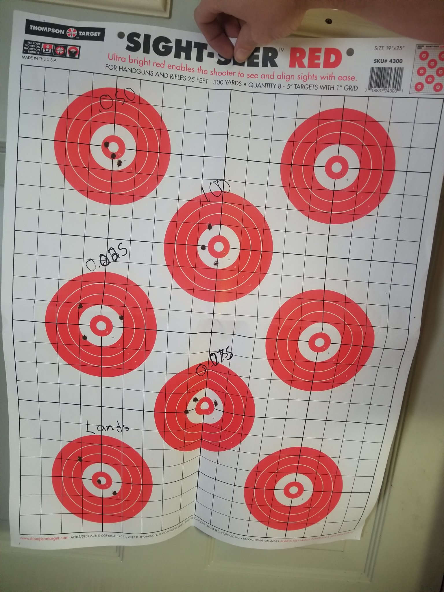

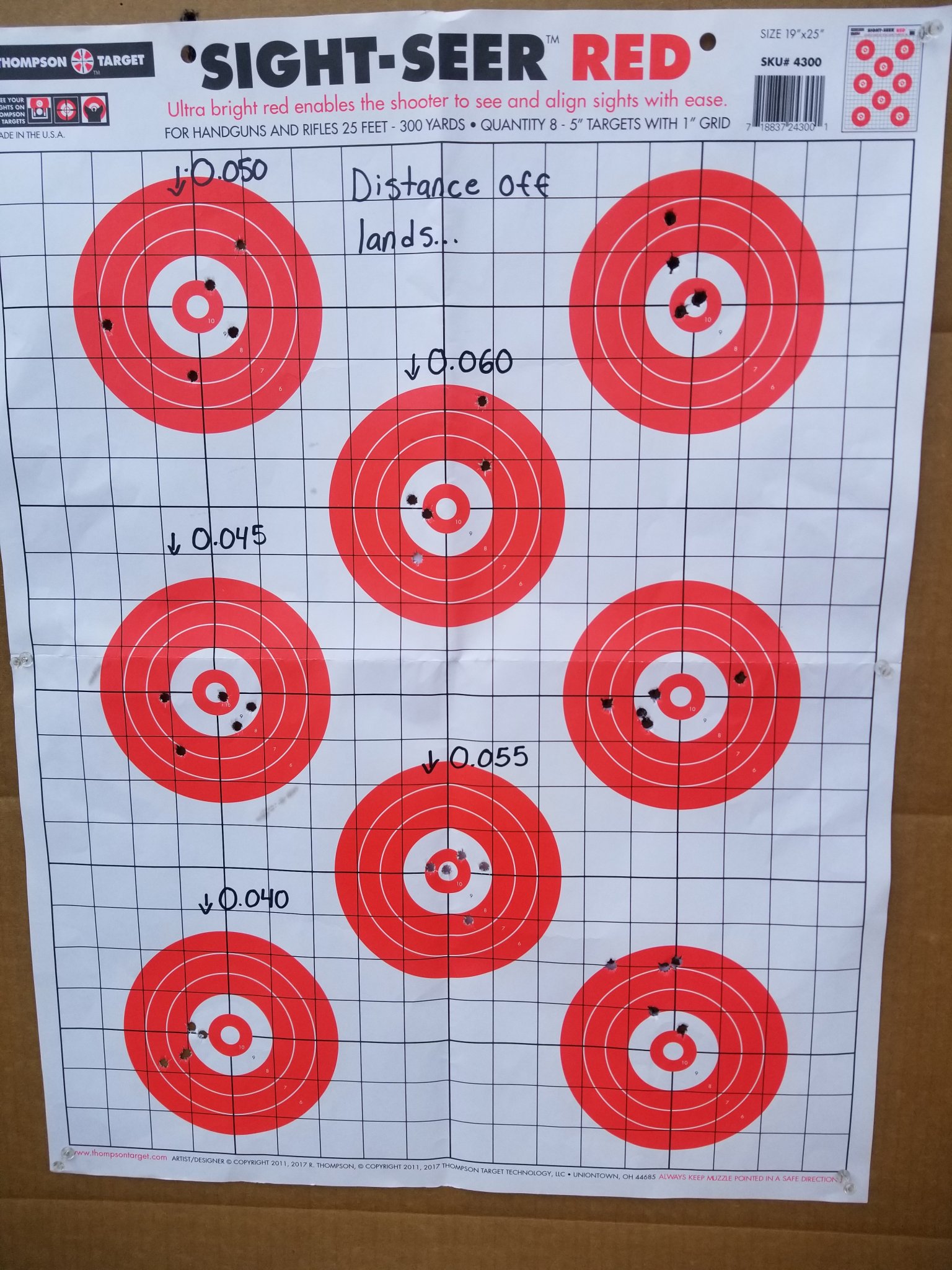

I been having trouble with getting acceptable accuracy out of my Rem 700 sps v in 243. So far all my experimenting has lead me to this. As you can see 0.040 and 0.055 off the lands has given me the best groups so far. 0.055 has given almost no vertical dispersion except for the one flyer which has been a bug yet to be worked out. Of the 2 tightest groups what do you fellas recommend i do next??? I am running the minimum load of h4350 with 90gr eldx.
I don't think I've ever seen any 243win group that bad.

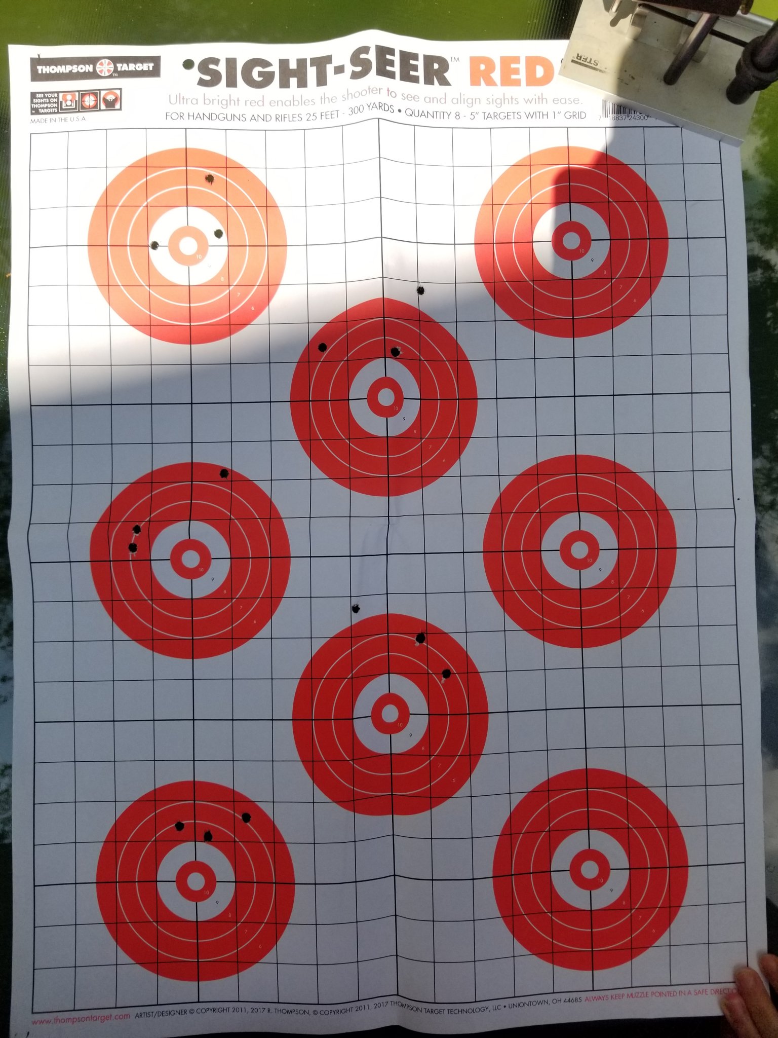

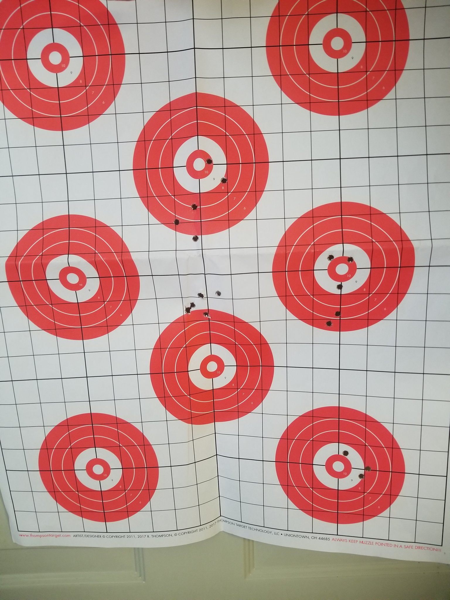

Yes i am shooting at 100 yards to get a load, I have tried every bullet length and powder combination 2 times. One day ill shoot a 1moa group the next week with same load will print a 4 moa group using the same ammo from the week prior. Action has been bedded and barrel fully floated with over 1/8 clearence from muzzle to action. Checked cold and warm. Forend has been completely filled with epoxy to stiffen up. Scope base, rings have been checked and torqued and locktight to spec. Scope is a swfa 10x42. The groups above from today are all the same powder charge. The same charge shot from the week prior that held 1 moa, thats the one 0.050 from the lands. This week it was a 2 or 2.5 moa group. Almost every group has mystery fliers for no apparent reason. Also taking advise from others on here i cleaned my bore squeaky clean and it didnt seem to help. Kept cleaning till there was no blue and clean bore. Actually tomorrow i will be heading back to the range again. Afterwards i put over 120 rounds through the barrel 20 Remington corelocks and 100 90gr eldx. Just am stumped and ready to give up on it.

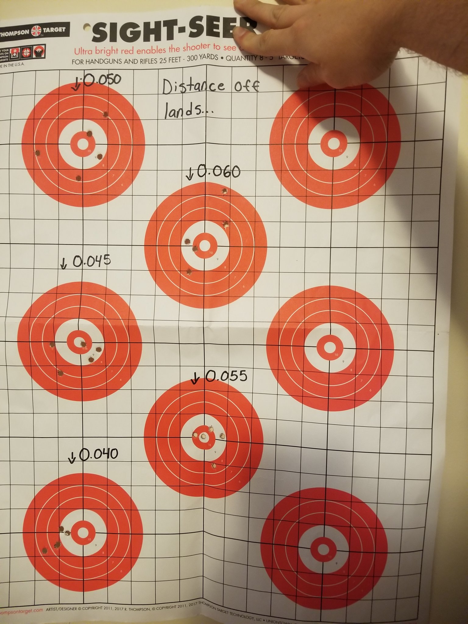

This is another 1 all the same distance from lands just different powder charges. From min to max. Just a sample of what i have already tried.
this was the 1st 20 rnds of factory ammo put through it. 1st 5 shot group was nice after that the rest of the groups got BIG. Next 75rnds with eldx was the same no matter what i did groups stayed at 3 moa. Different powder, bullet lengths from touching lands to factory oal in 0.010 and a few 0.005 increments, powder charges from min to max in as low as .3 tenths with no real break through. I find a promising loads then reshoot next day it turn into a 3 moa group. I dont have anyone in my area that i know of that shoots precision rifle to help me out.

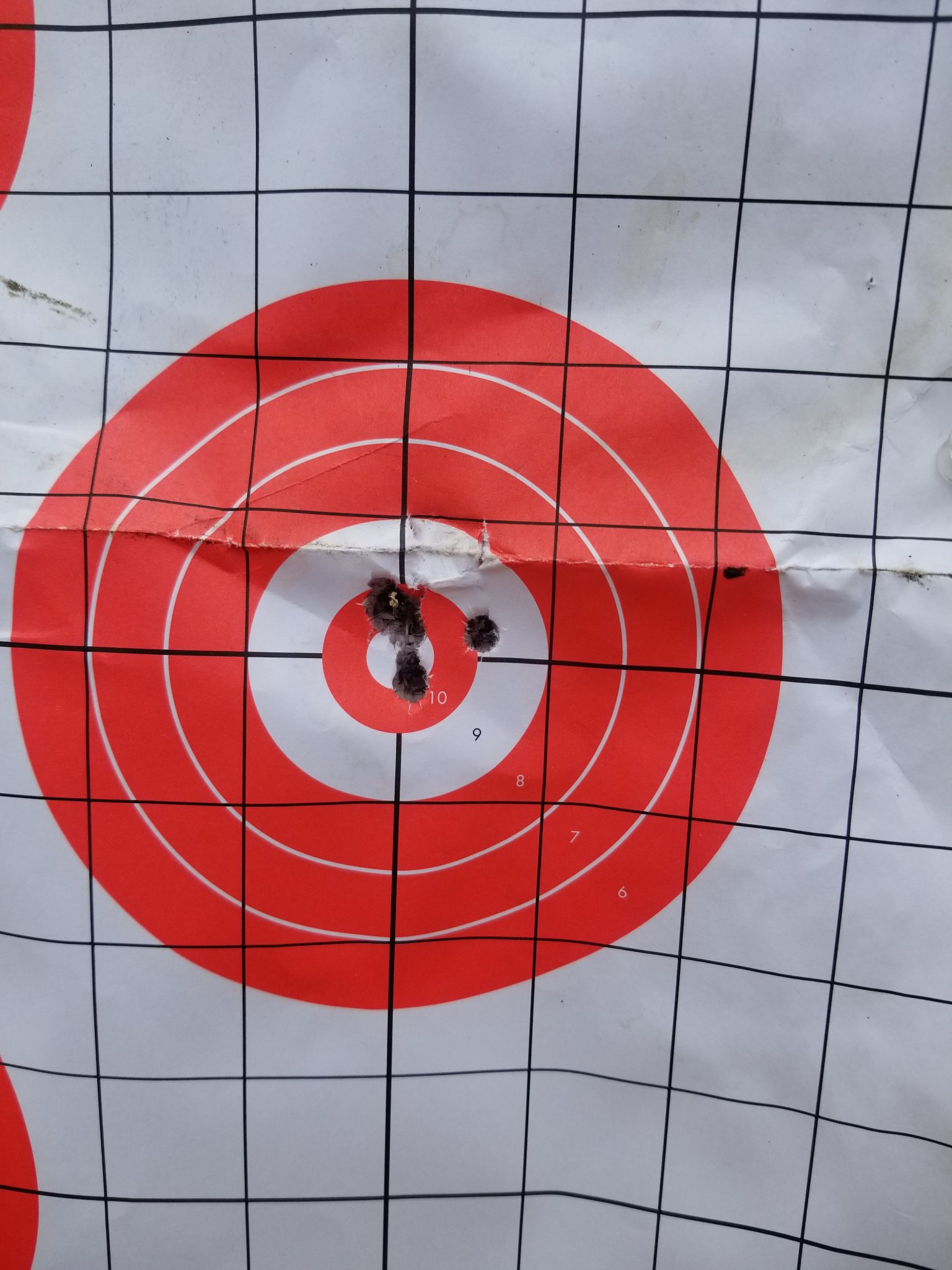

I think i finally figured it out, went ti the range with 20 rnds spit into 2 groups of the same load and shot 10 rounds which is the far 2 right top red dots with my swfa 10x42 scope, results were the same as before. Then i switched scope and front and rear rest and fired the lower far right dot also and again same groups. So out of frustration i grabbed my torque wrench and tightened my action screws to 65 in lbs. Which i thought was to much but ohwell, try it i thought. I fired the group on the lower black and green target. Group was fired with a warm barrel and didnt exactly take my time as i was frustrated but landed 4 shots right at .750 moa with one flyer..... i cant believe this whole time my actions screws werent tight enough. I followed the reccomendations of 45 in lbs. Guess it needed more.
Reactions: Rover31
Now i just need to find a different bullets, with my 7mm using a max and now using 90eldx in the 243, with both bullets i got random fliers like this... i always used hornady bullets but after the last few boxes i think they need to look into tightening up qc or something...

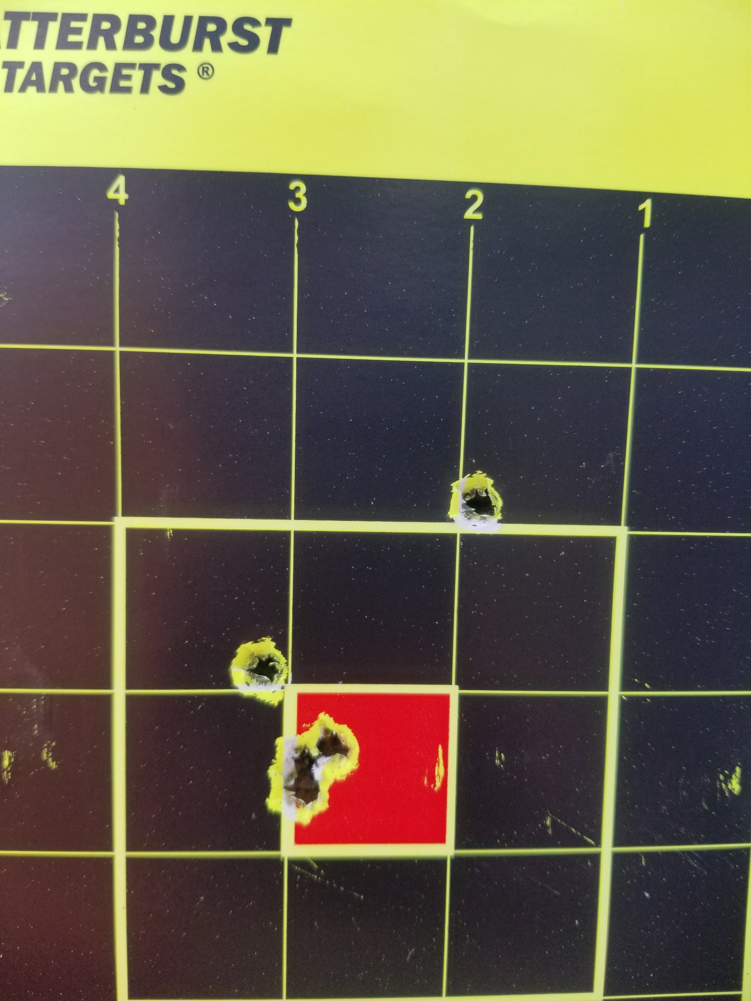

After finally figuring out my problem a fellow snipershide member has helped me out and this group was shot with factory Federal 80gr soft points, measures right a .500in. It was a 5 shot group. Now i am excited to finally be on the right track!!!! Thanks Again OG10!!!
