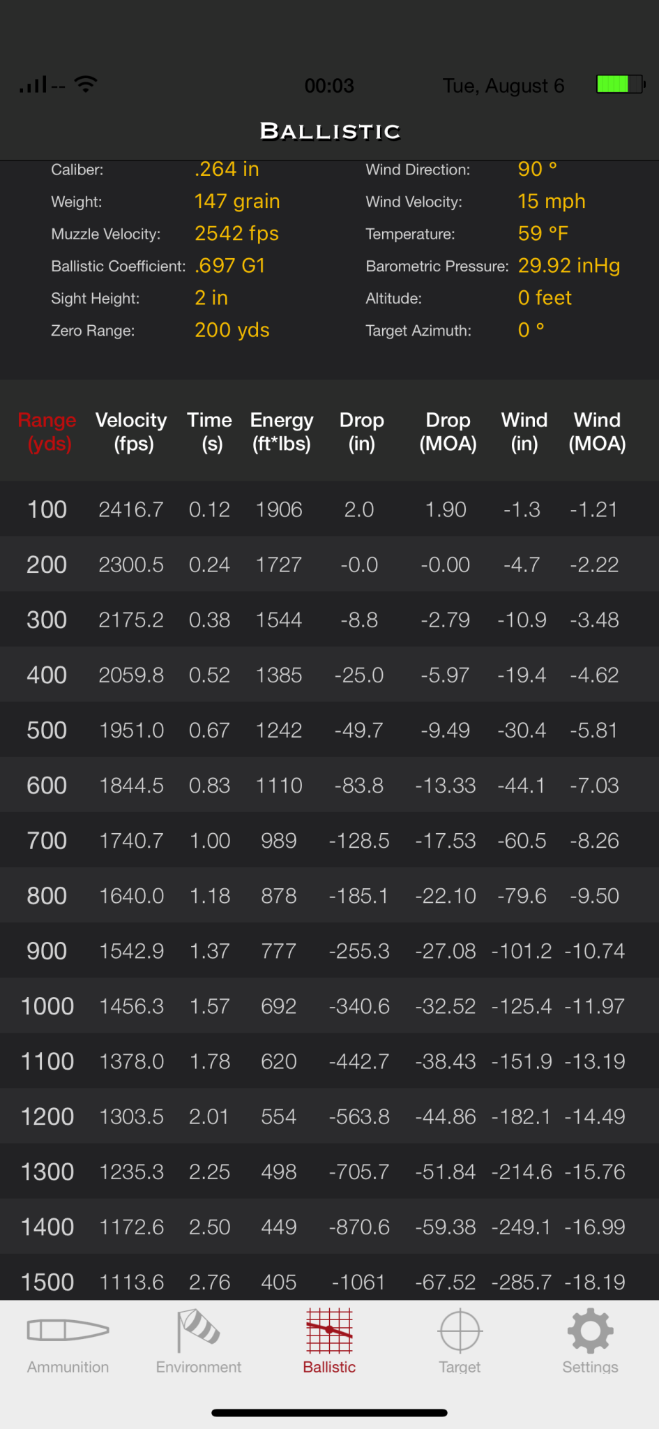

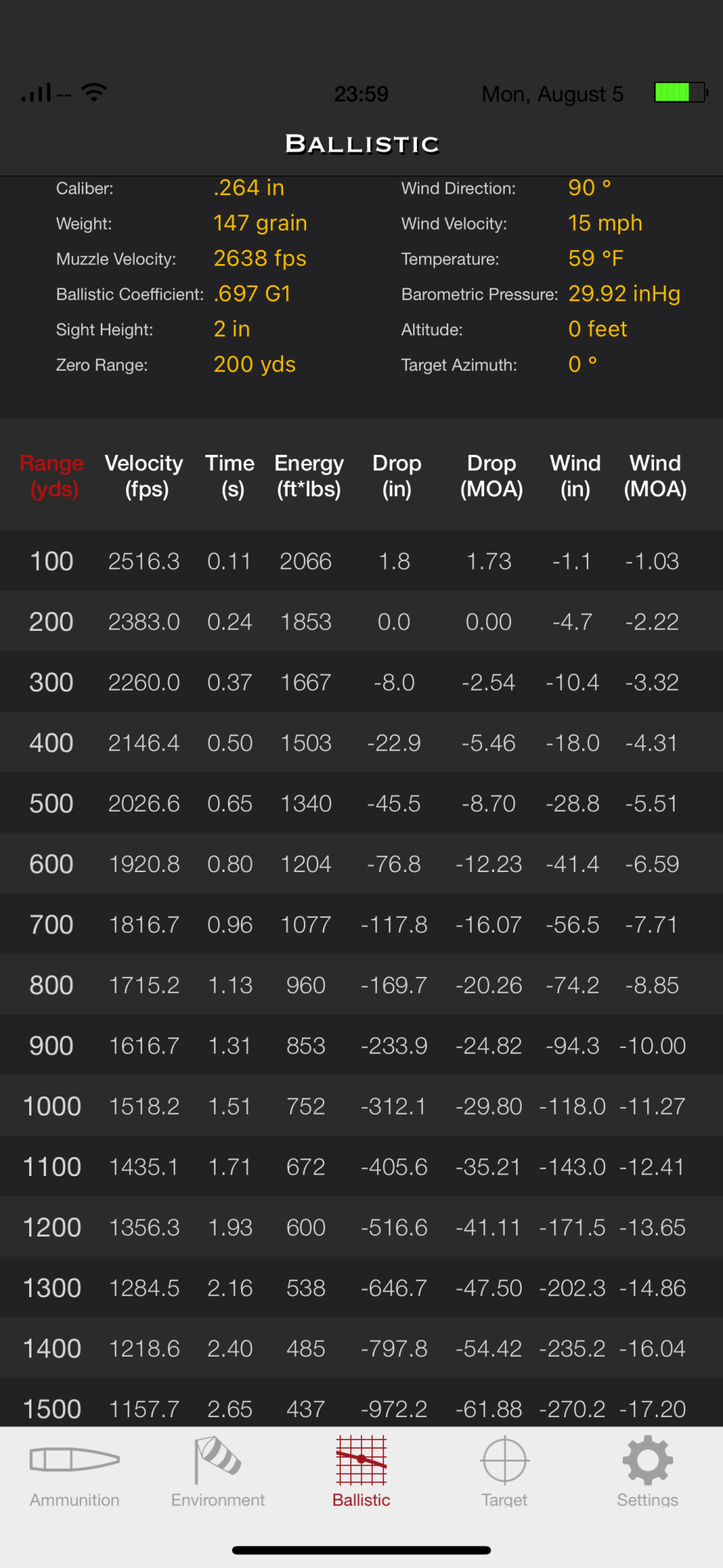

I did actually
Here is the 22 inch barrel, I’m using factory Hornady ELD Match ammunition for the calculation:
Here is the 18 inch:
Here is 19 inches:
So you can extrapolate 18.75.
Looks like the 22 goes transonic just below 1,600, while the 18 does just after 1,400, while the 19 is just before 1,500. Notable differences in drop and wind drift too. 312.1 inches drop and 118 inches of drift at 1,000 with the 22 inch, 353.4 drop and 125.1 drift with the 18, while the 19 is 340.6 drop and 125.4 drift.

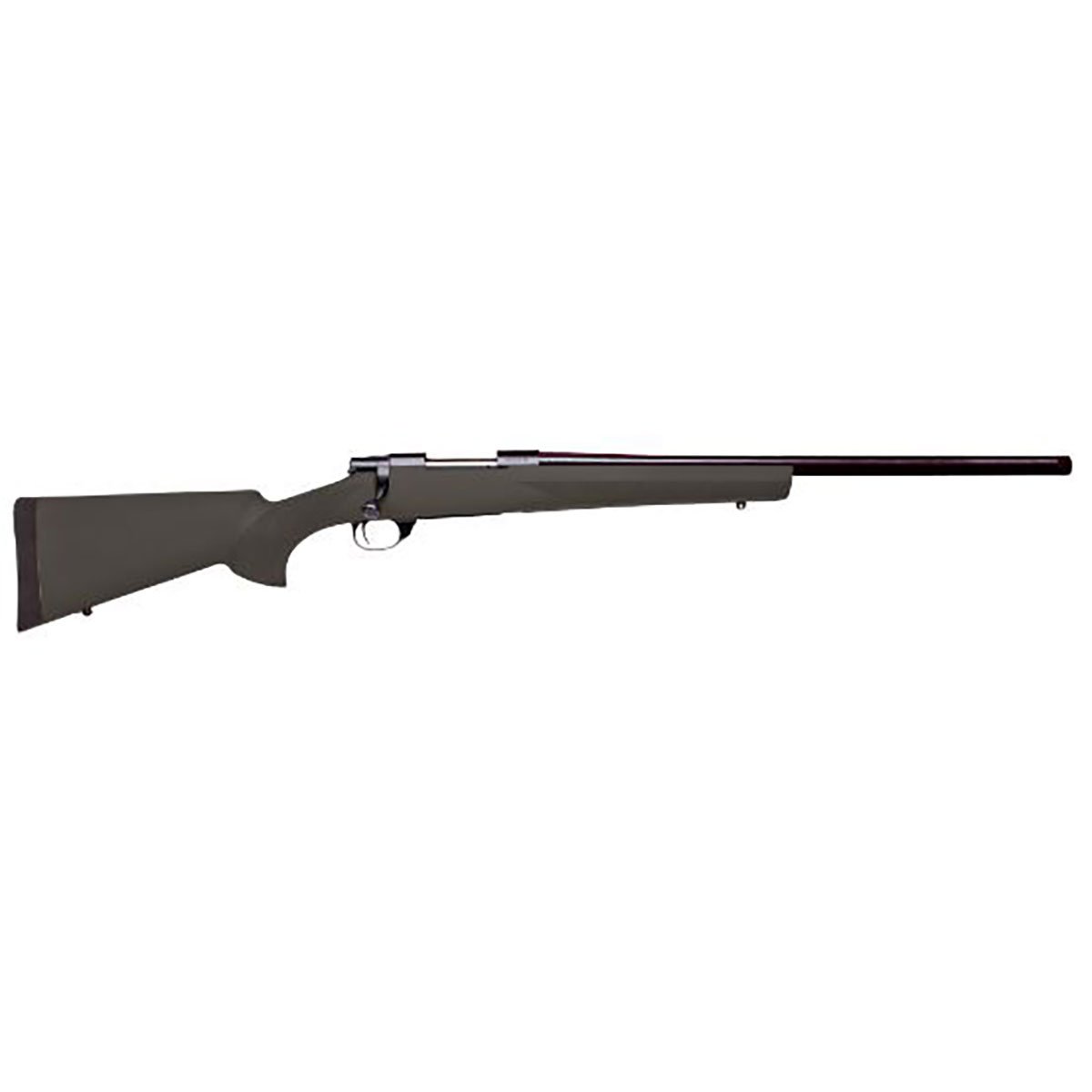

Does Howa do anything for you?
Heavy contour 24" with good aftermarket options for later for $500

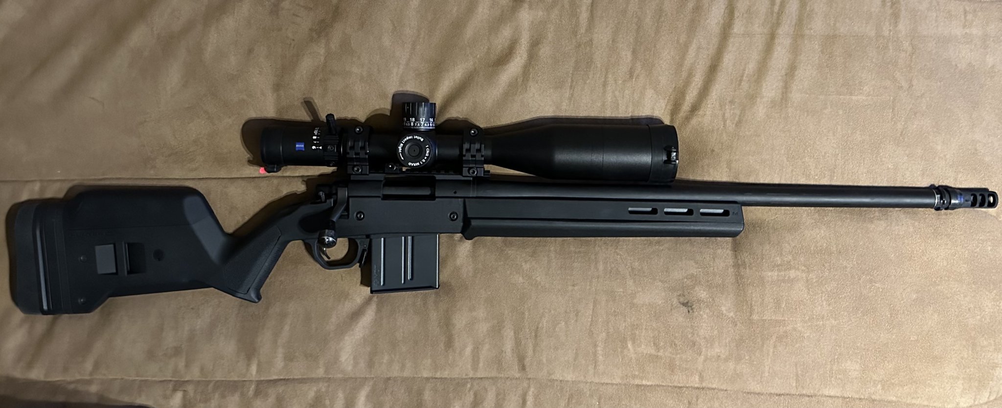

Here’s mine

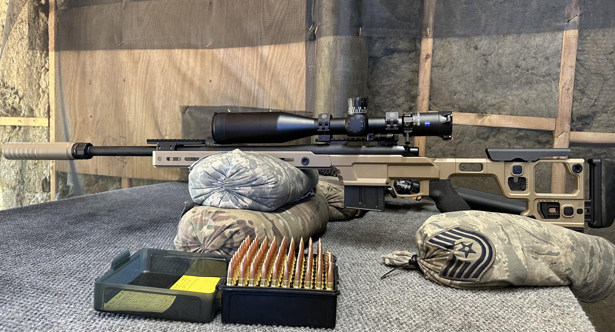

Here’s my newest build… 20” Proof on a Solus action in .25 Creedmoor. Pushing Berger 133’s at over 2,800 FPS average. The barrel is still breaking in (only 100 rounds so far), but it’s averaging 0.4xx” 5-shot groups.
