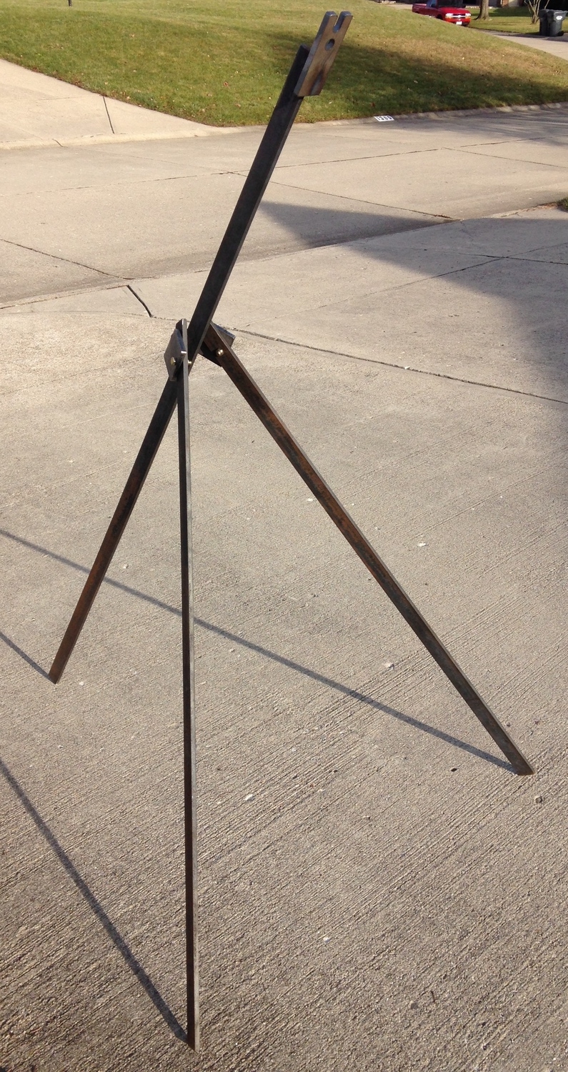

Buy a steel target stand?
Reactions: roostercogburn98
That stand above is from "Made Targets" (formerly Arntzen). I've got over a half dozen of those and they work fine for me, but I'm usually hanging IPSCs off of them and shooting at distance (but it's also usually a 338).
edit: The picture shows the old style. Made Targets has slightly modified it so you can shorten the "neck" of the target to get a lower center of gravity for the smaller targets, or extend it to full length for the tall IPSCs, etc. Arntzen originally made the stand in two versions, Short or Tall. Made modified it so that you can have both in one stand. Good idea - the neck is two-piece and bolts to the lower frame with two different sets of bolt holes - Short or Tall. That's a Tall stand in the pic, 53" IIRC.

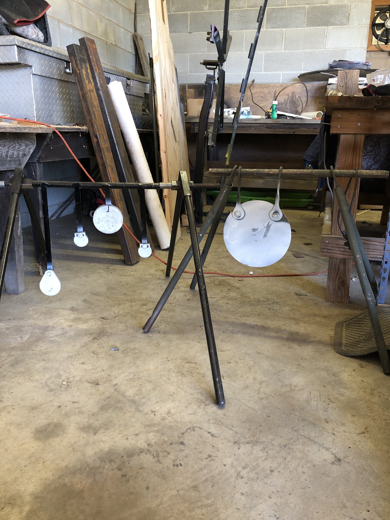

The left one is homemade and right is store bought, but both use the same concept. The store bought has ar500 hangers that are twisted to lower the forward facing area and limit impacts. Both break down into small pieces that fit into a bag. Heavy bag, but it is relatively compact
Reactions: GrumpyOleFart
those look great and portability is key for my situation. Who made the store bought model?
If your handy with a welder, the left one took me about an hour, maybe a tad longer. Square tube stock, flat steel, and electrical conduit from local store. Rebar I have tons of laying around the house, so I repurposed it.
I’d tell you where i bought that one but it was at least 7-8 years ago so I don’t have a clue. Sorry I couldn’t help in that aspect, but it looks like you have several options here as well. Good luck in your search and happy shooting.

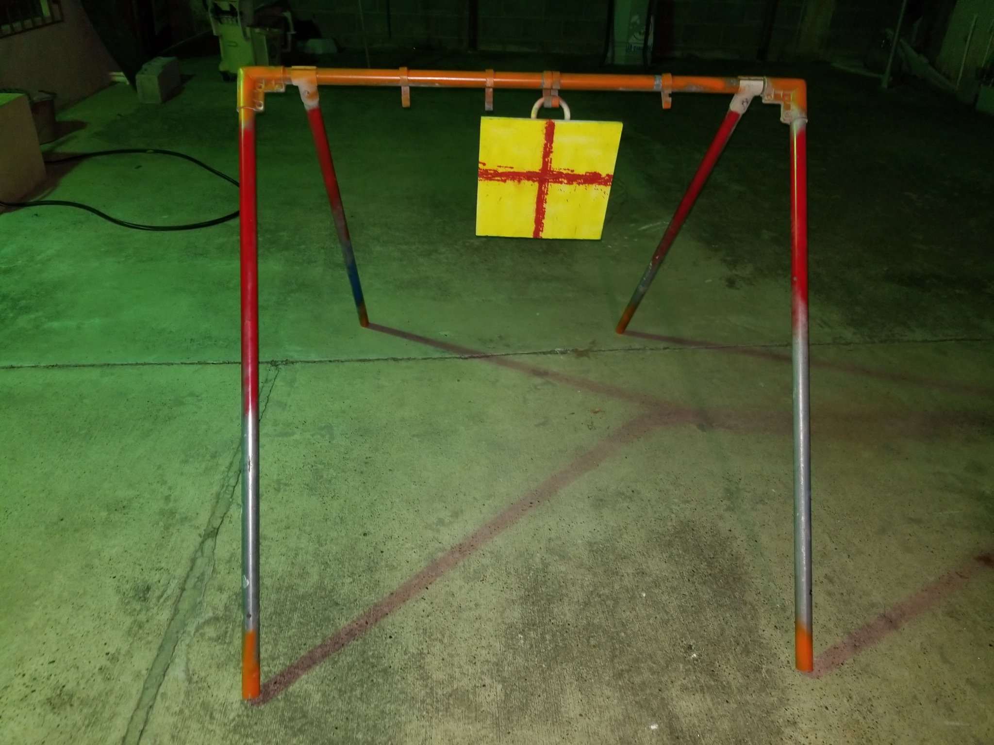

Here's some rebar target brackets that I found online:
Reactions: jab00
