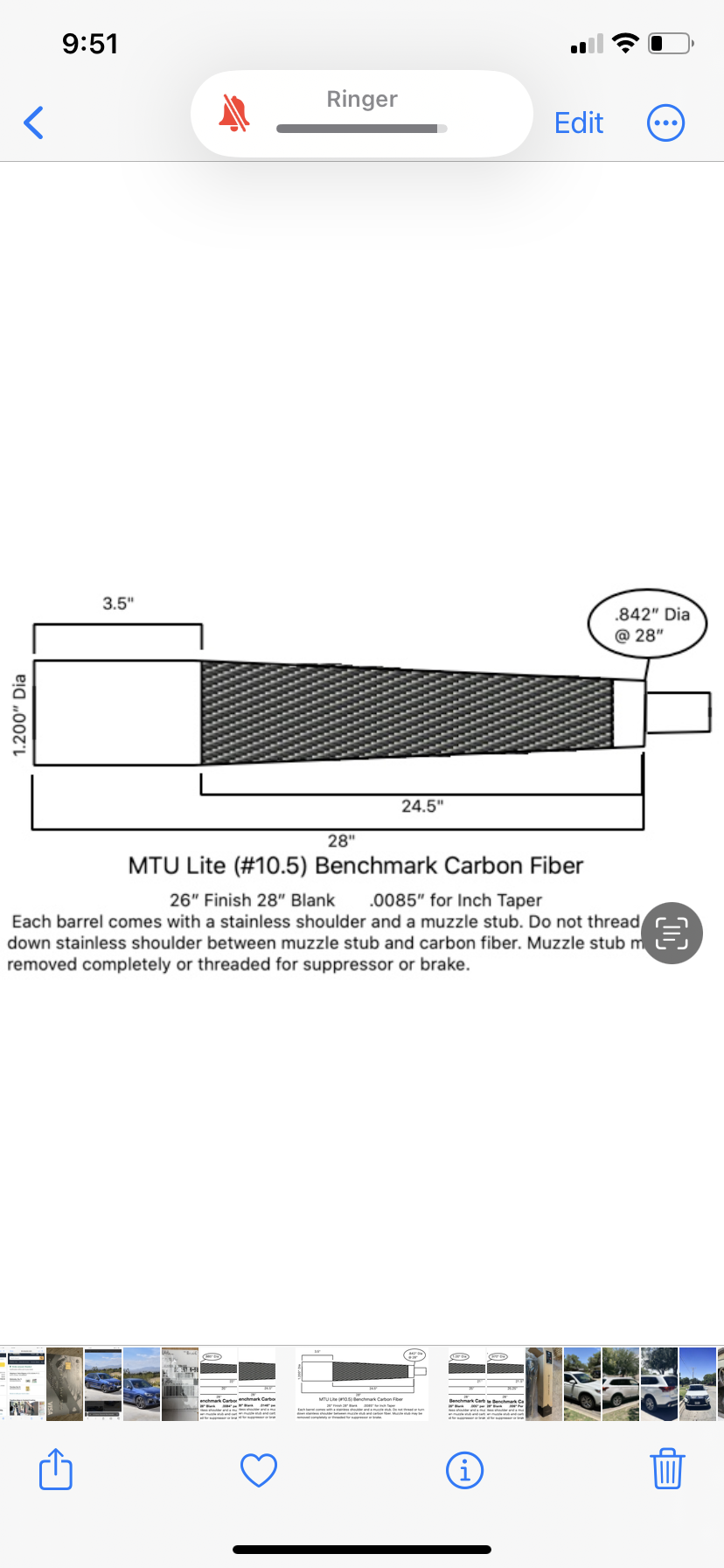

    Benchmark carbon MTU will fit.

    So the TRG can use a 1.20 shank? It does not have to be smaller like the Tikka or standard Sako rifles?
    The common shank size of 1.25 is more of a problem than 1.20 from what i recall. Its a metric conversion so it might be ± a tiny amount, but the 1.20 is pretty close to 1.18 (30mm). This is off top of my head so maybe someone can double-check the math.
    Will it mate up to the receiver correct with no hang over at the edges. I would like to order a Bartlein carbon fiber barrel this week for it.
    the TRG-A1 retains metric spec, ie its technically I believe 30mm, or 1.18in...
    ...so your overhand is possibly ~20 thou's...not a showstopper in other words.

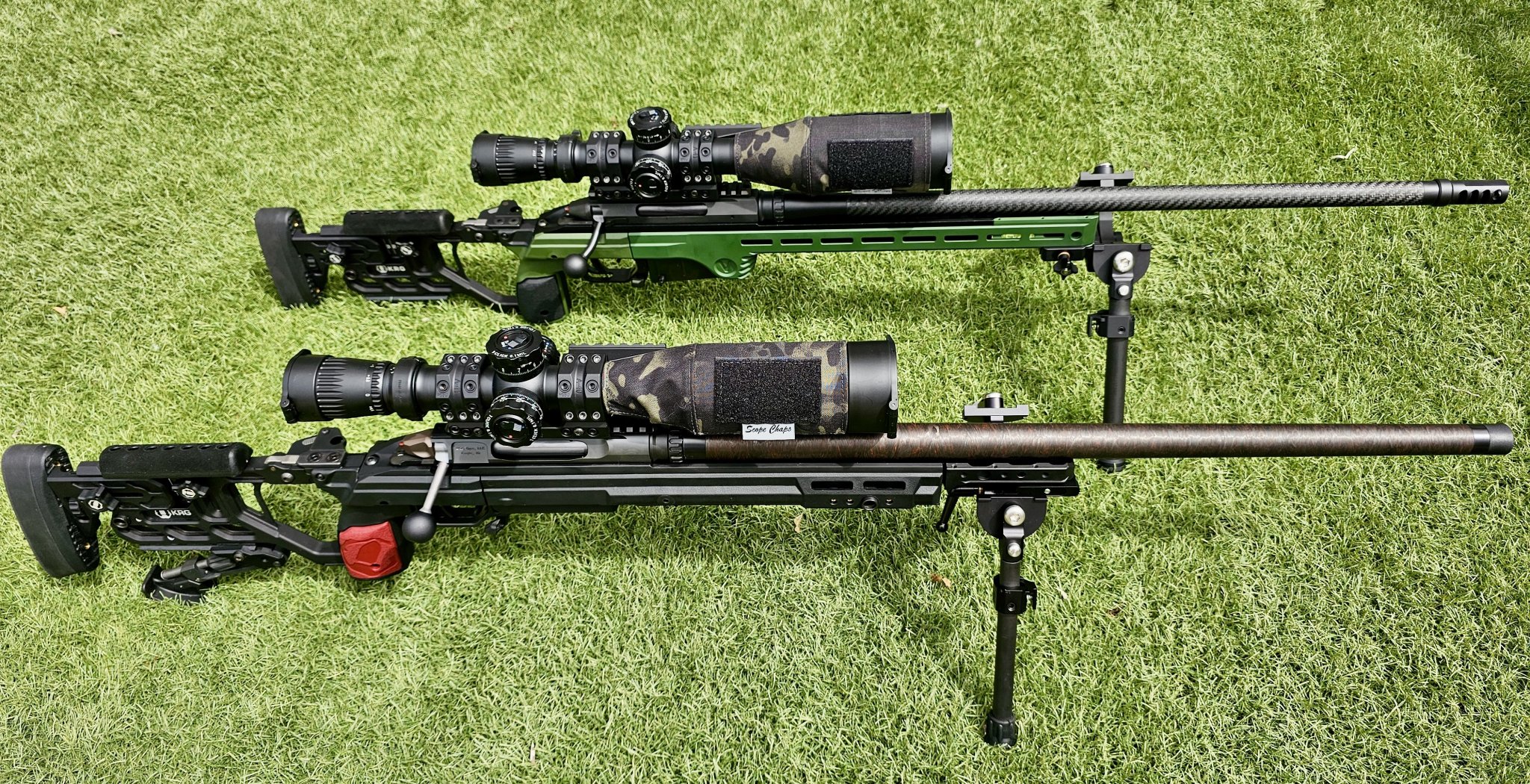

    The good folk at Bartlein have helped me out with my TRG and a CFW barrel.
    With a 1.20” shank shouldered you’ll have a small “over hang”.
    Bartlein now do a CFW Tikka 1.13 shank, Bull Sporter profile that I use on my Sotic and TRG, tho I’ve converted my TRG to KRG’s barrel nut system. My next barrel for the TRG will be CFW Green.
    With an open forend and QR Spuhrs it’s a fast and simple barrel change.
