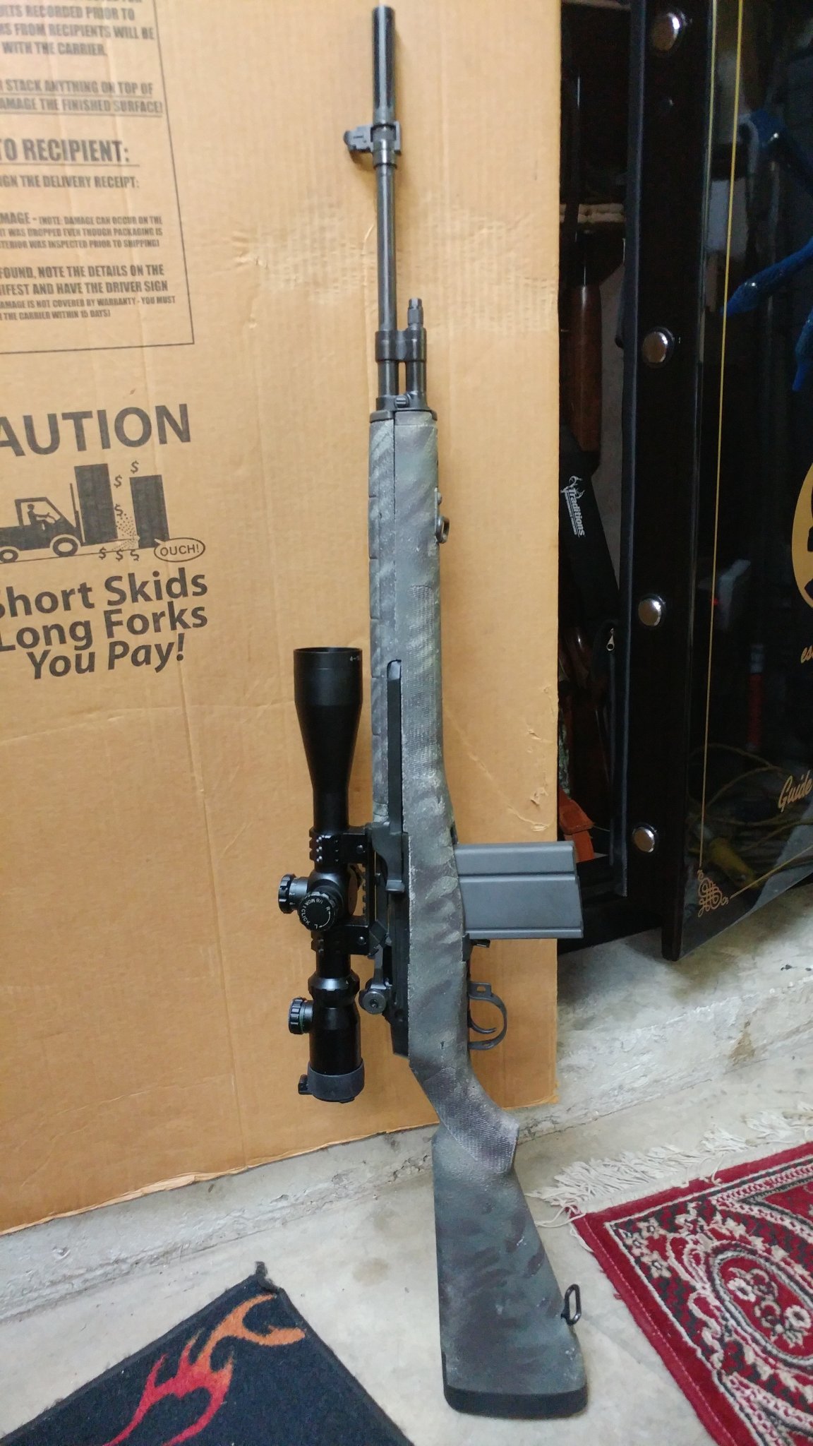

I second that on the badger rings. Here is a photo with my old Mk4 mounted.
PS: what height are your rings?
If I remember correctly these are the Night Force Mediums, they are a great aluminum option. I also use Badger on just about every other rifle I mount a scope. After having purchased both I prefer the badger. They just feel more substantial, maybe its because they are steel. Either way they both perform well and neither are a bad choice.
