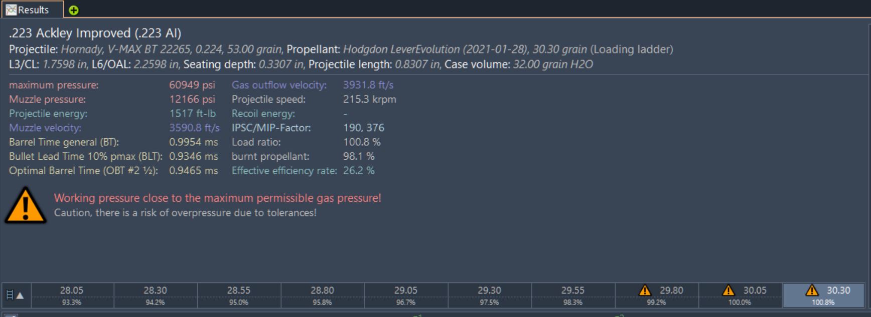

Need some quick load numbers for 223 ai
Yoteski
Feb 13, 2017
969
1,206
Was wondering if one of ya'll could run me some numbers in Quick load. I'm developing a coyote load for my 223 ai using 53 grain vmaxs and running Leverevolution powder. I found a nice load at 30.3 grains which puts me right at 3,600 fps. Haven't seen any pressure signs up to 30.5 grains, but I stopped because in my head, I'm worried I'm tickling the dragon's tail at this point. Everything is perfect as far as pressure goes. I can't find any data for lever, so I'm just curious if someone could give me a rough idea of what psi I'm running.
Using Frontier brass and CCI 450 primers. Thank you.
I don't have QL, but GRT says you're about 60,949psi. I'm interested in the QL comparison.
