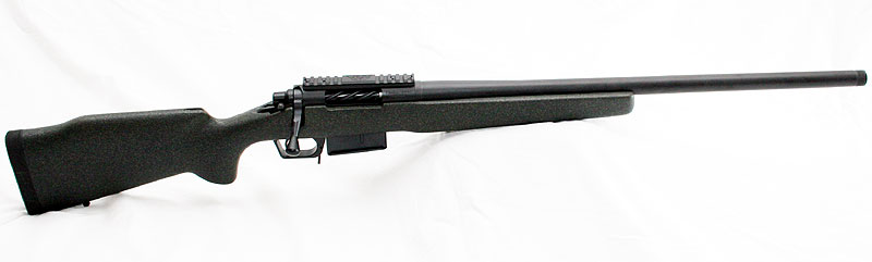

Some excellent advice on here.
It's also worth considering the SMR Paladin and that would leave you enough cash for a nightforce SHV and some leupold mark 4 Rings.
