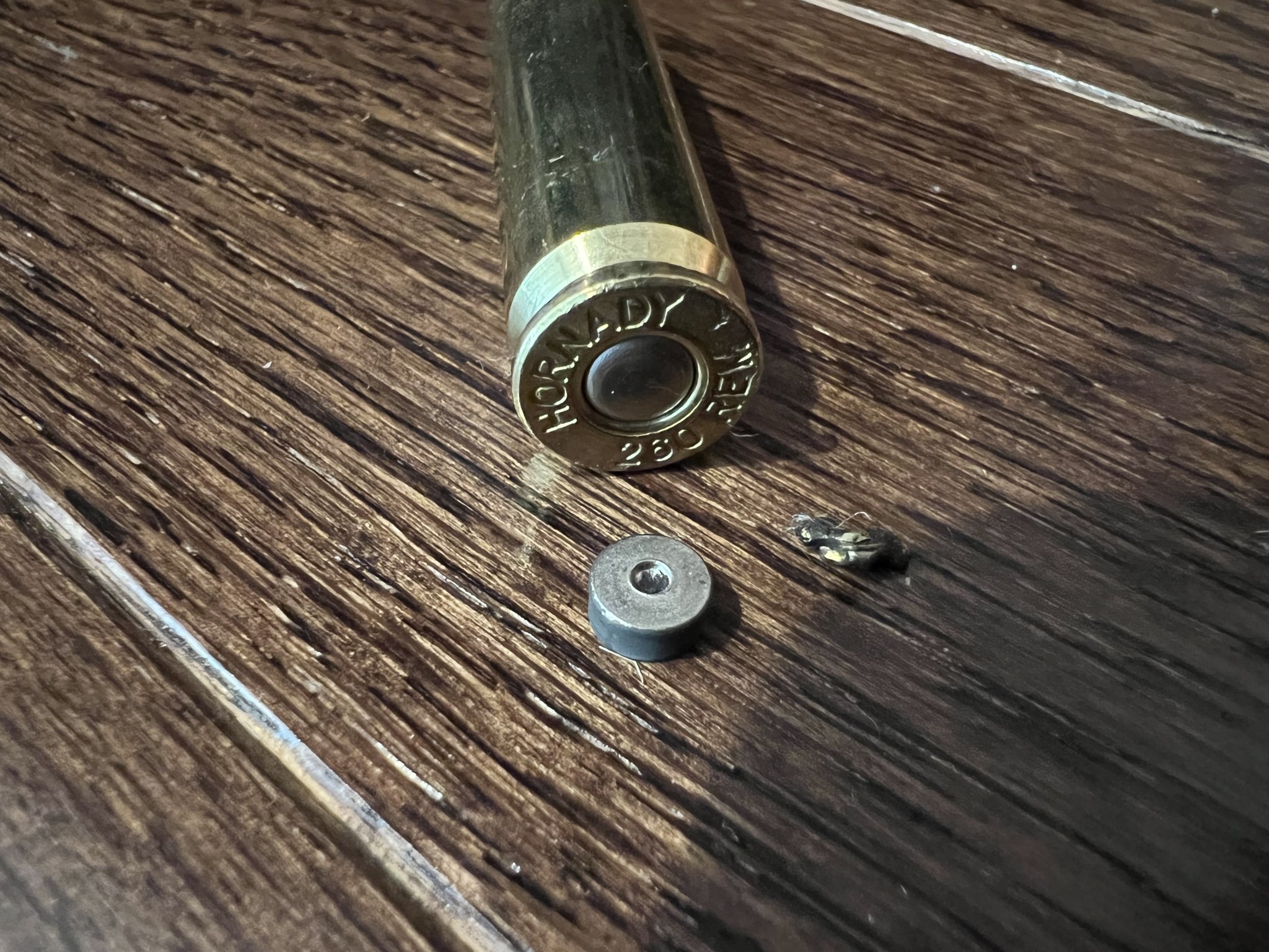

Could use some guidance on where to start as I am very new to bolt guns. Just returned back from a training course, first time out over 100 yards and had a blast! Had to end up calling it quits early as I was blowing primers out consecutively and it was jamming up the bolt with gunk and parts of primer.

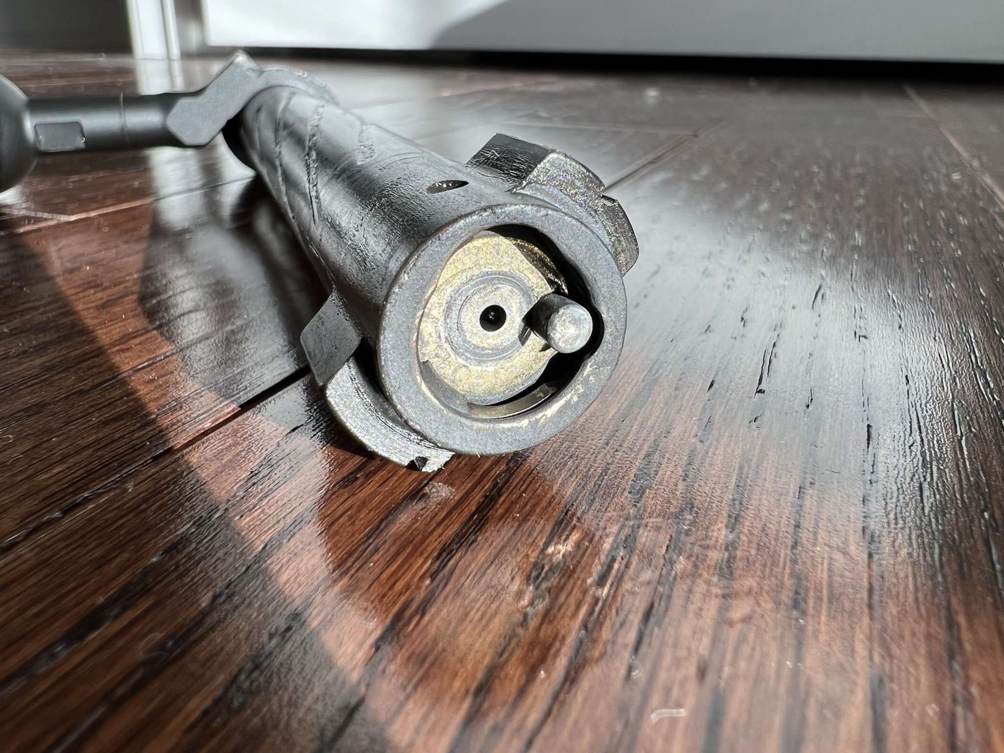

I shot 110 rounds over two days, a few primers went the first day, then it got much worse the second day and I stopped. I have attached a picture of the bolt, I’m guessing I have some damage but not really sure what exactly I am looking at. The questions is, where would you start to fix this issue? Switch up ammo? Check for internal damage? Scrap the whole gun and go buy an AI? Need some suggestions on where to go from here, particularly if it’s even safe to continue using if I switch ammo? Thanks!

And boltface looks fine. Clean it up and should be fine.

The more you pop the more eroded and gross the firing pin tip and aperture will become and even worse the popping will become in turn. Hopefully its not so eroded it will require bushing the bolt face to restore it, hard to actually tell from the photos but it looks alrightish.

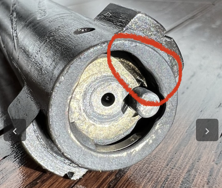

Your firing pin took a beating like spife said, see below. Kinda surprised the orifice isnt more messed up. Looks like there was a lot of gas leakage around the circumferance of the primer as well, especially at 9 oclock. Probably want to replace the pin. That shadow at 2 oclock looks weird too.

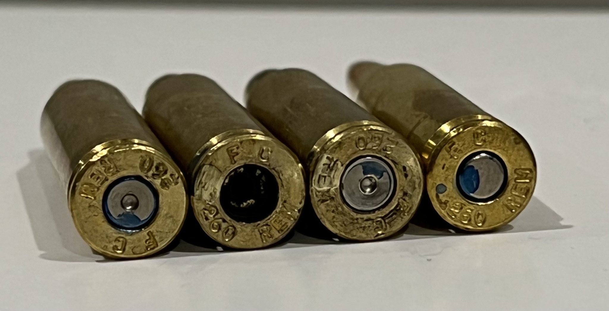

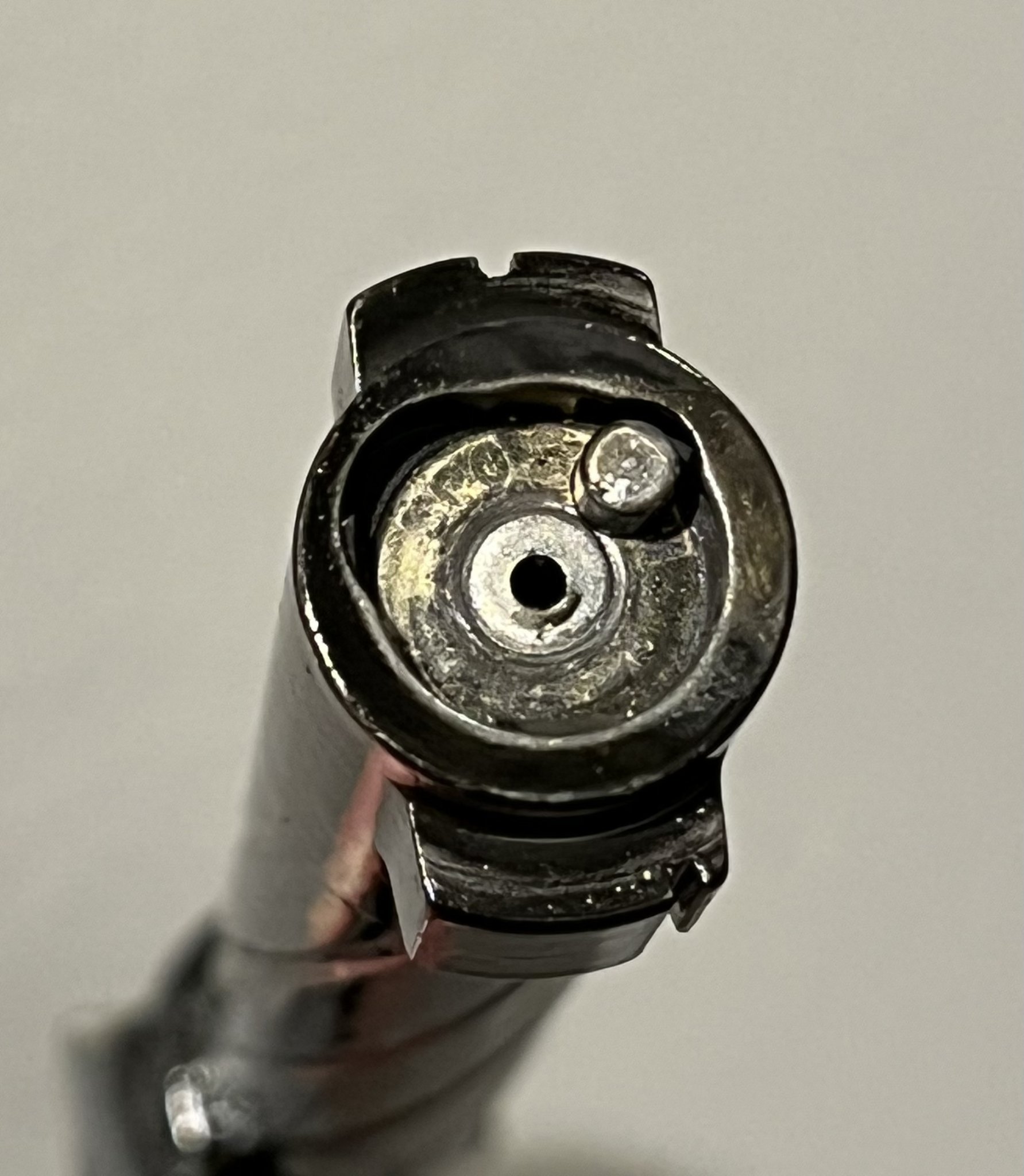

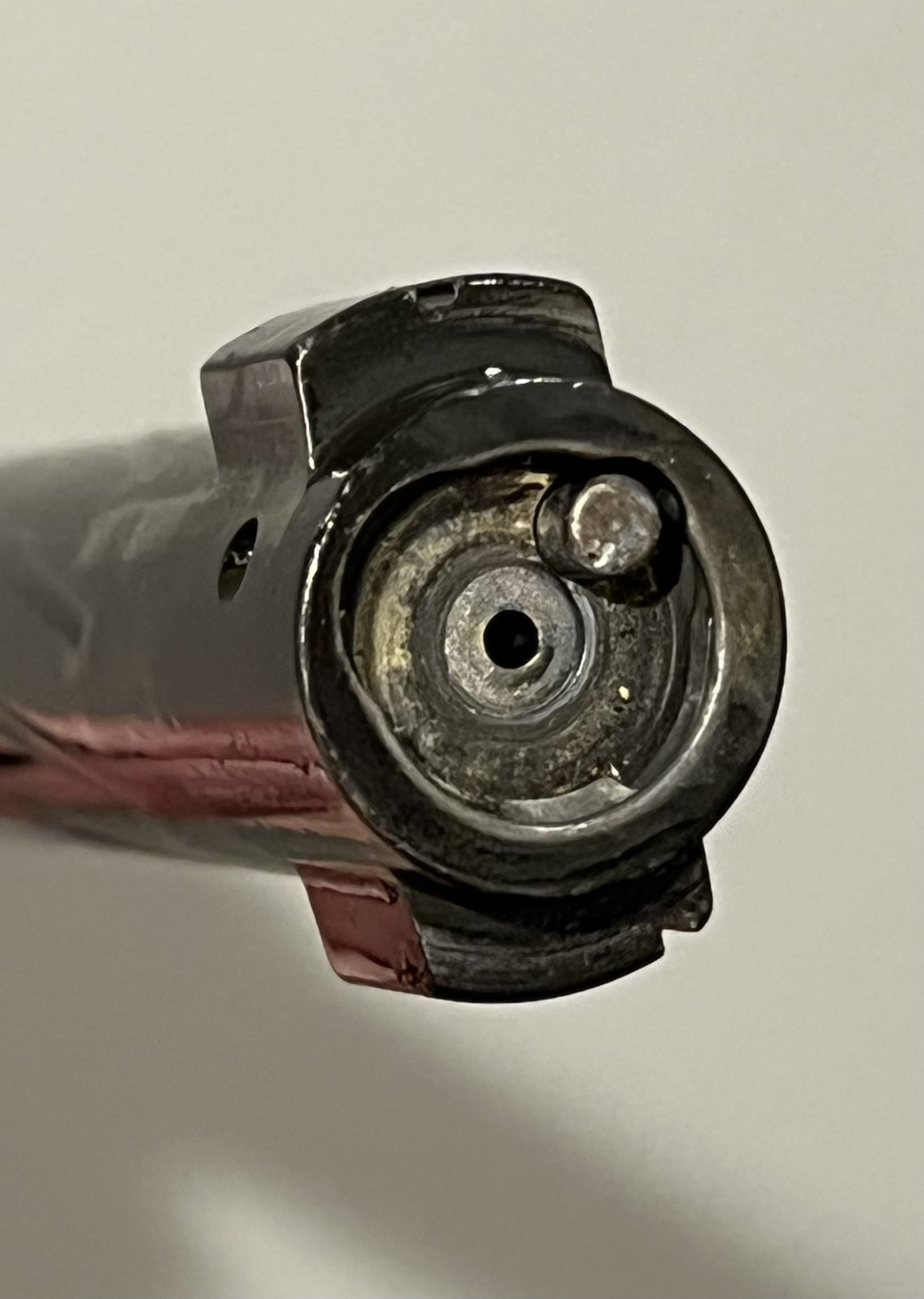

Ok…. Appreciate all the replies here. I went with a full Bore Tech clean out. Cleaned everything out, carbon, copper, chamber etc. Went out to the range today, used completely different brand of ammo. First shot seemed to go fine, second, blown primer, 3rd had odd imprints on the face of the case but didn’t blow the primer but jammed the bolt down. I called it a day after that. What was really odd was that none of the shots actually hit paper at 100 yards. No idea where they went. (Yes the rifle is zeroed etc, was hitting no problem last time I brought it out before I started having issues).
I spoke with the previous owner, he did not have any issues like this, total round count is less than 250, I am inclined to believe him based on the amount of guns he owns and that I bought several from him that are all excellent and shoot lights out. I only started having issues after I put 50 or so rounds into it.
I added some pictures, you can even see the imprint of the words on the bolt face. Some marking around 10 o’clock on the 2nd and 3rd shot. 4th is unfired. Fun stuff! Next stop is a gun smith it looks like. Any suggestions? NJ would be easiest.

I would take a no-go gauge and see if the bolt closes fully on it. Also, are you sure the chamber is not 260 Ackley Improved?

That bolt face looks awful. BTW ... I had a blown primer issue until I started trimming down my cases to valid trim length, and backing off my shoulder just a little further. Apparently I was "squishing" my cases into the chamber and that was blowing my primers.

The bolt face should be cleaned up and scrubbed off. Same with the internals on the bolt and likely your trigger area too. Popped primers leak gas and soot everywhere.
The pin tip is likely cut up from the gasses and that will cause ruptures down the road even with ammo that doesn't have any issue.
The reason why it was popping primers isn't attainable from these pics and info but it's something that we should be able to diagnose with the ammo, rifle and your experiences all together.
As far as fixing the bolt, based on what I'm seeing the bolt face is likely fine. The firing pin would be more my concern at this point.
