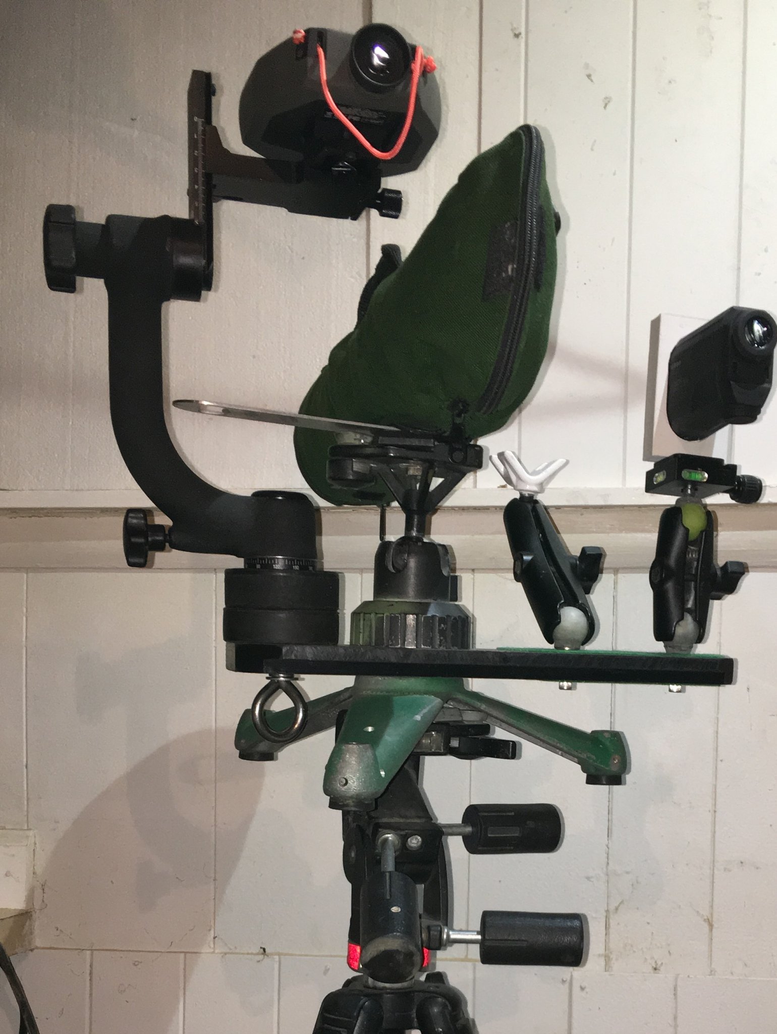

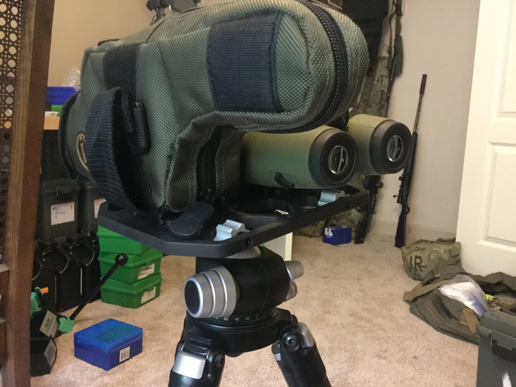

    Can you post photos of the ball head? I've made up a few of these and may be able to come up with something. Here's a

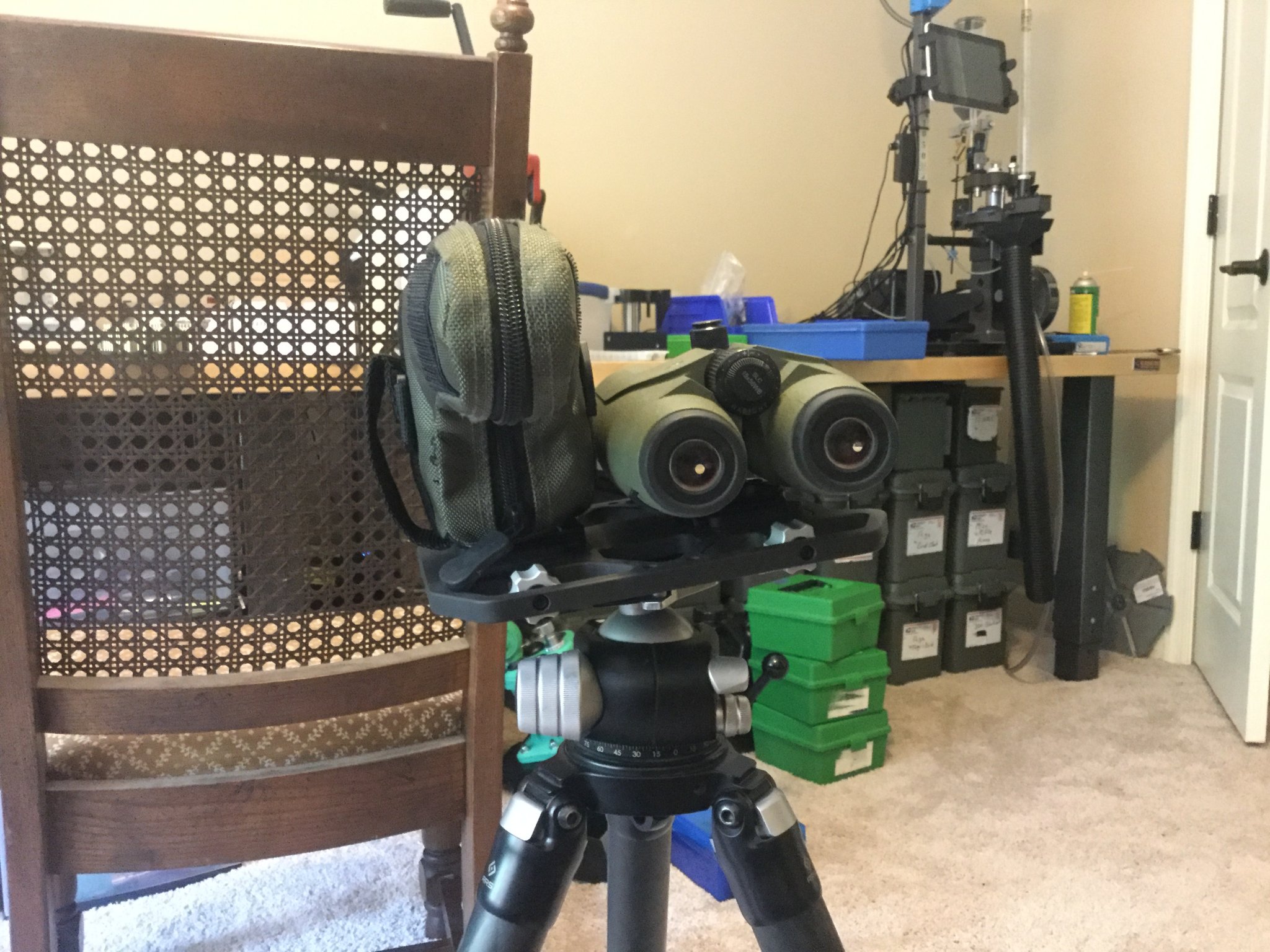

    photo of my spotter/rangefinders/camera double tripod. The tripod, head, & ball head are Manfroto; there's some Ram stuff in there as well as Swiss Arca QR gizmos. It all quick connects/disconnects.

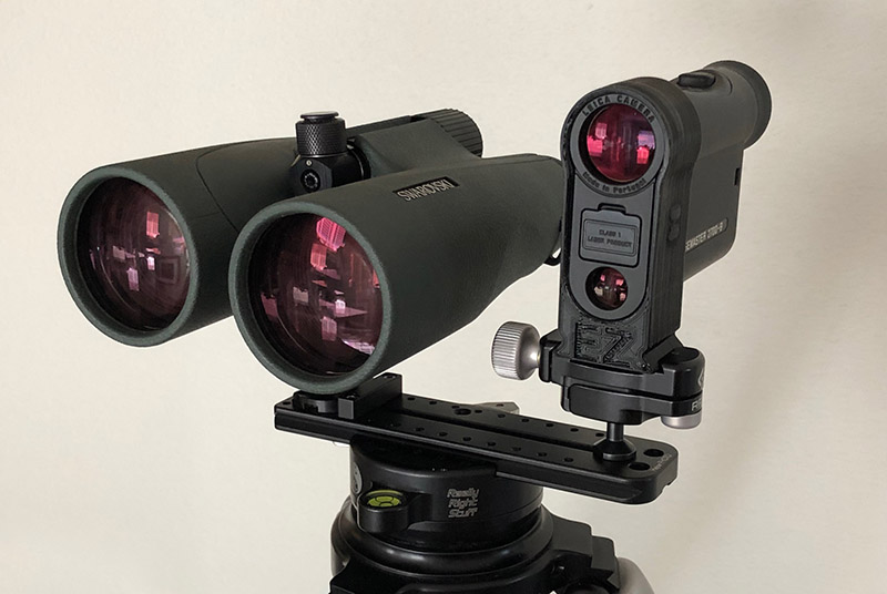

    Check out the mub
    Or Henderson Precision
    cinema.reallyrightstuff.com/Rails-for-Cinema?quantity=1&custcol28=8&custcol29=1
    I am running the 10.6” (270MM) I wouldn’t go shorter, both your optics are wide enough you want room to operate them. With all the threaded holes it is extremely versatile

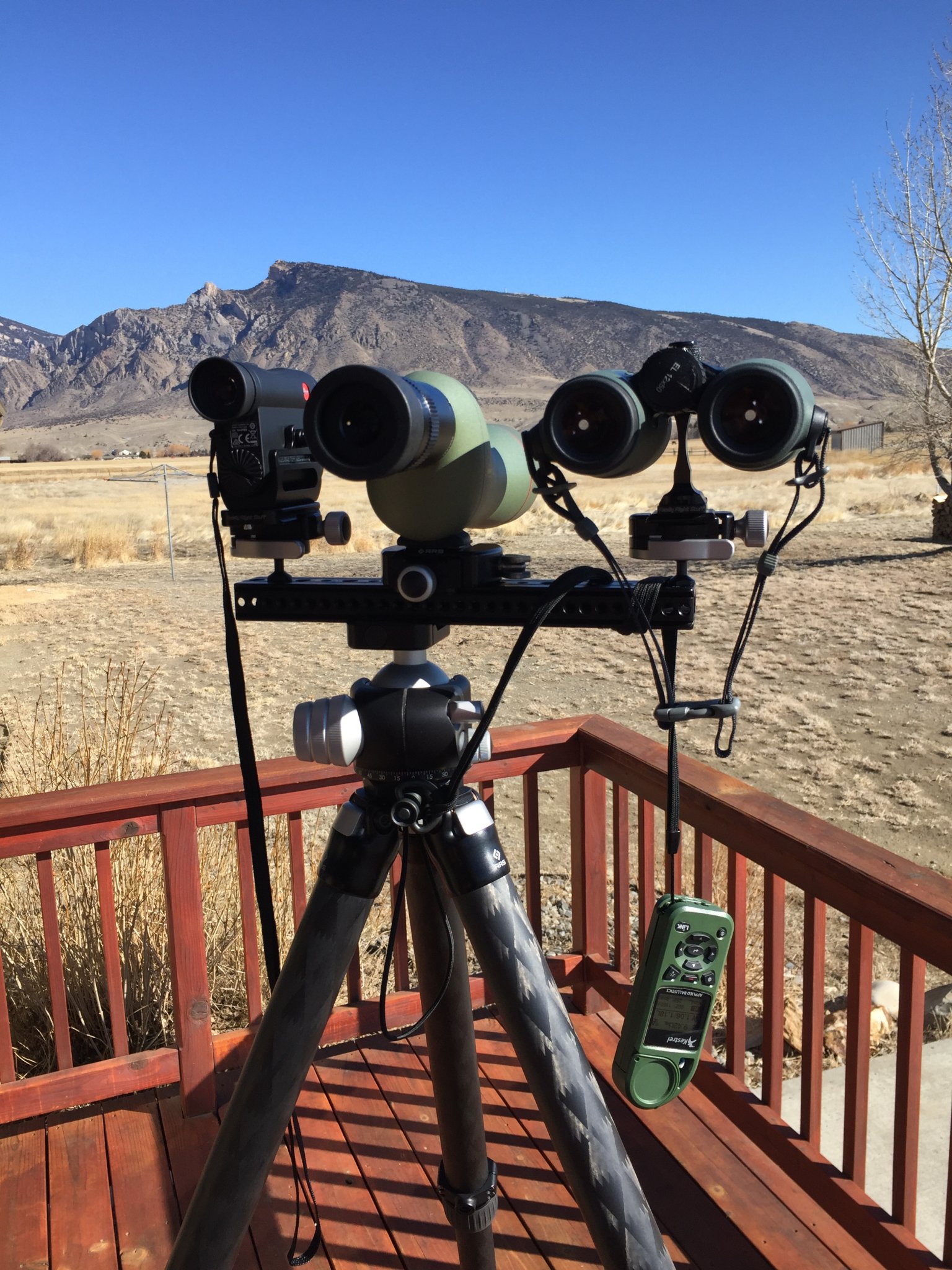

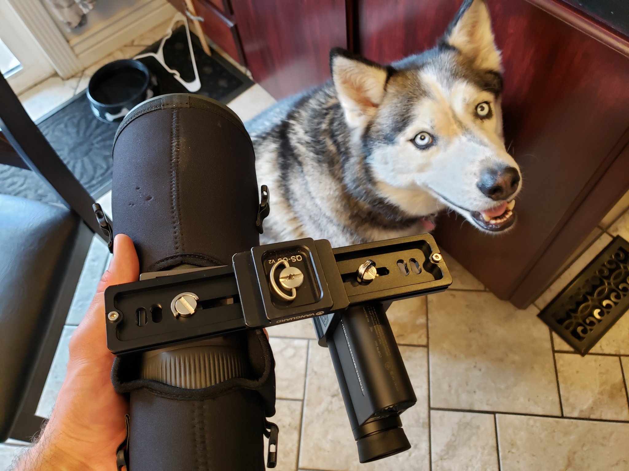

    There's a lot of extra wide Arca style plates out there for stereo photography, etc. that will do this. I'm using one from Amazon that was under $30 and it works very well. If you want to stick with RRS quality, they have the one Detroit mentioned.
    I have a similar setup to Detroit. Bought a $30 arca Bar from Amazon that has a built in clamp on one side and I got a ball head on the other. Put my terrapin x on one side and binos/spotter on the other.

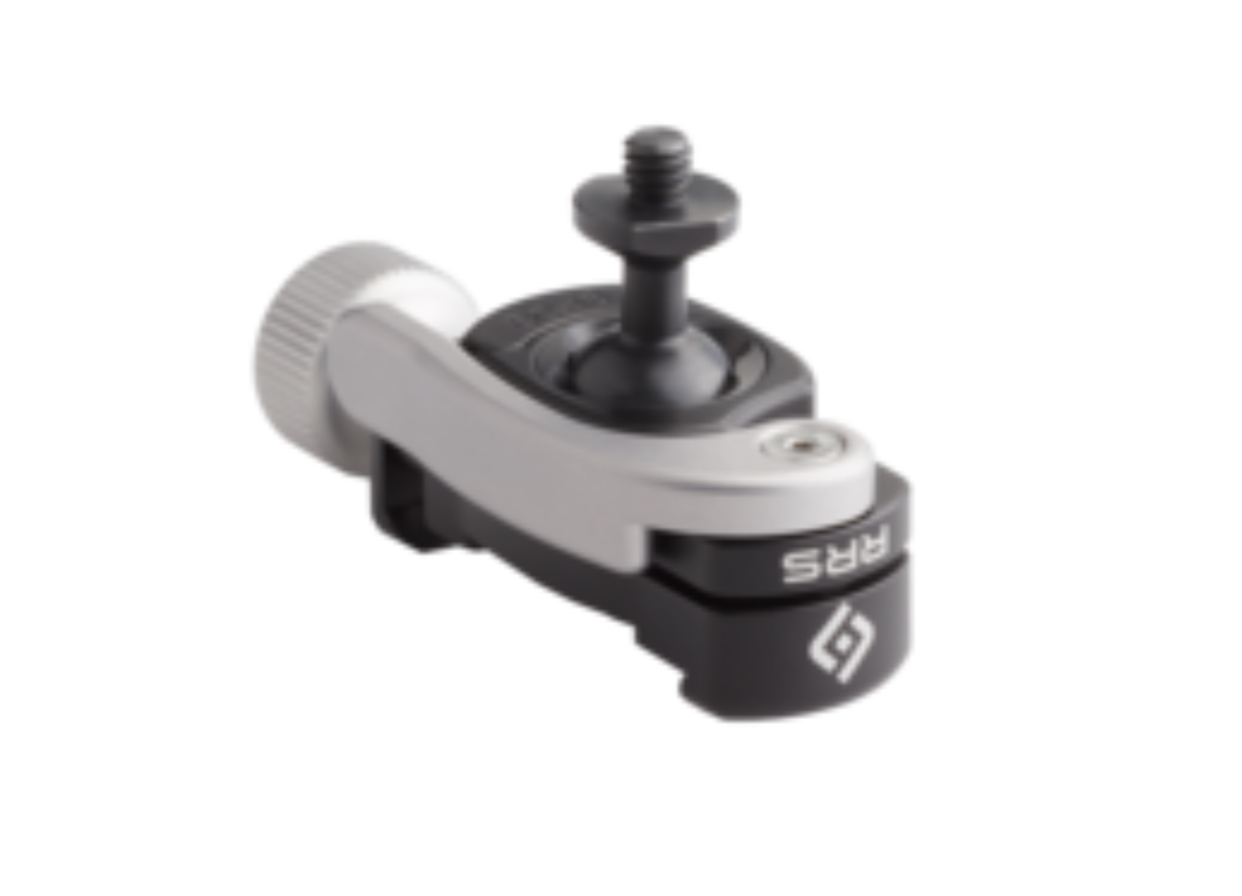

    Quick question, do you guys have an adapter plate that would allow the microphone ballhead the be used in a RRS/arca clamp?
    Yes we have plates and clamps with female threads, also we have a reduced bushing as well if you’d prefer a clamp style that uses the bigger style of threads. Get infront of a computer tomorrow and give me a call and we can go through the listings of different products to find you the proper porridge.

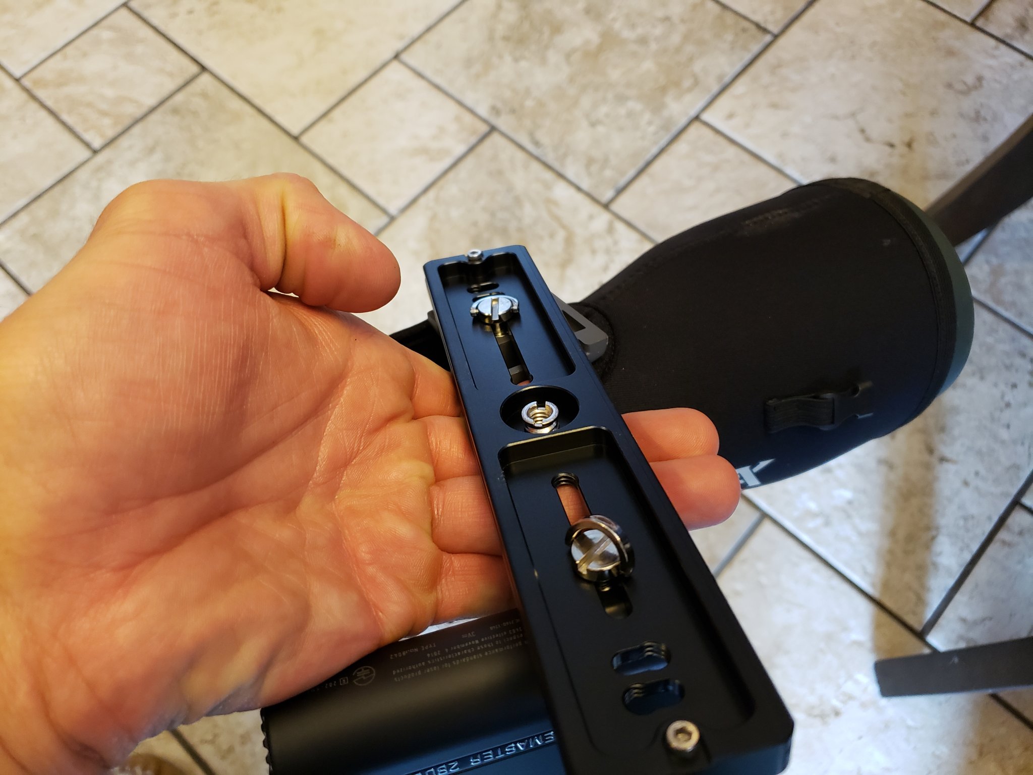

    Sent a pm with pics of the two pieces I’m trying to attach.

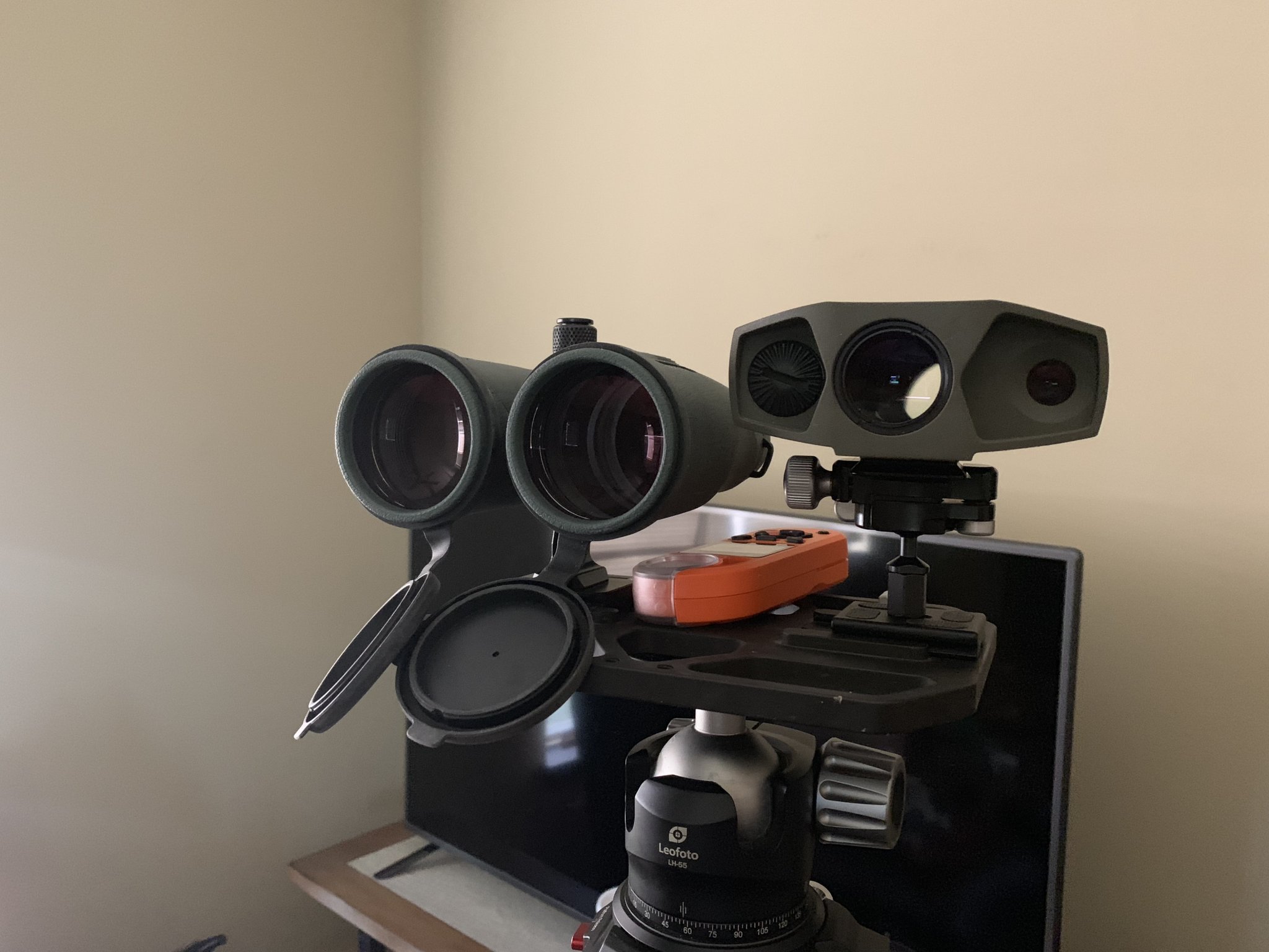

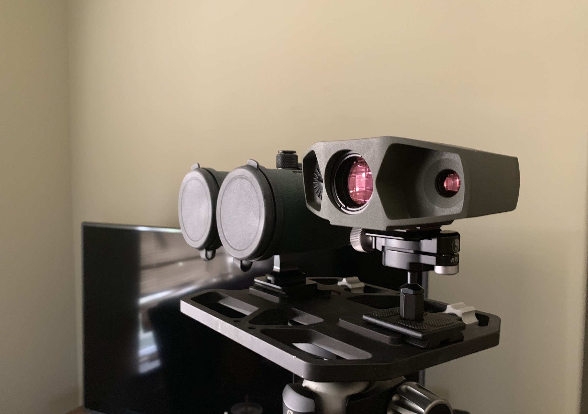

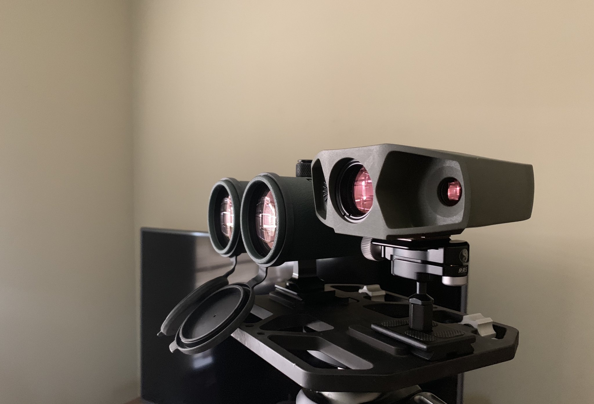

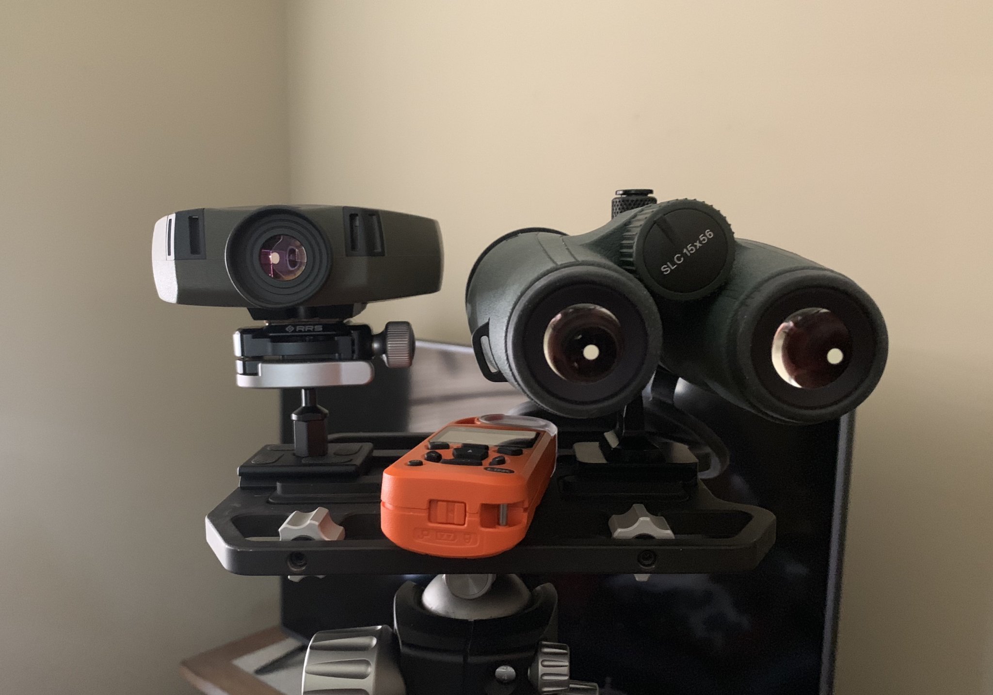

    What I ended up with:
    Gray Ops Dual dovetail clamp gamer plate that will be on top of leofoto ballhead
    (For binos) outdoorsman stud and stand. With a dovetail adapter
    (For terrapin) RRS terrapin dovetail plate > RRS micro ballhead > RRS dovetail plate
    My plan is to use the base ballhead to align binos and then use the mini ballhead on the plate to co-witness the terrapin.
    Reactions: Sheldon N
    Gamer plate is actually a pretty clean and fairly compact setup.

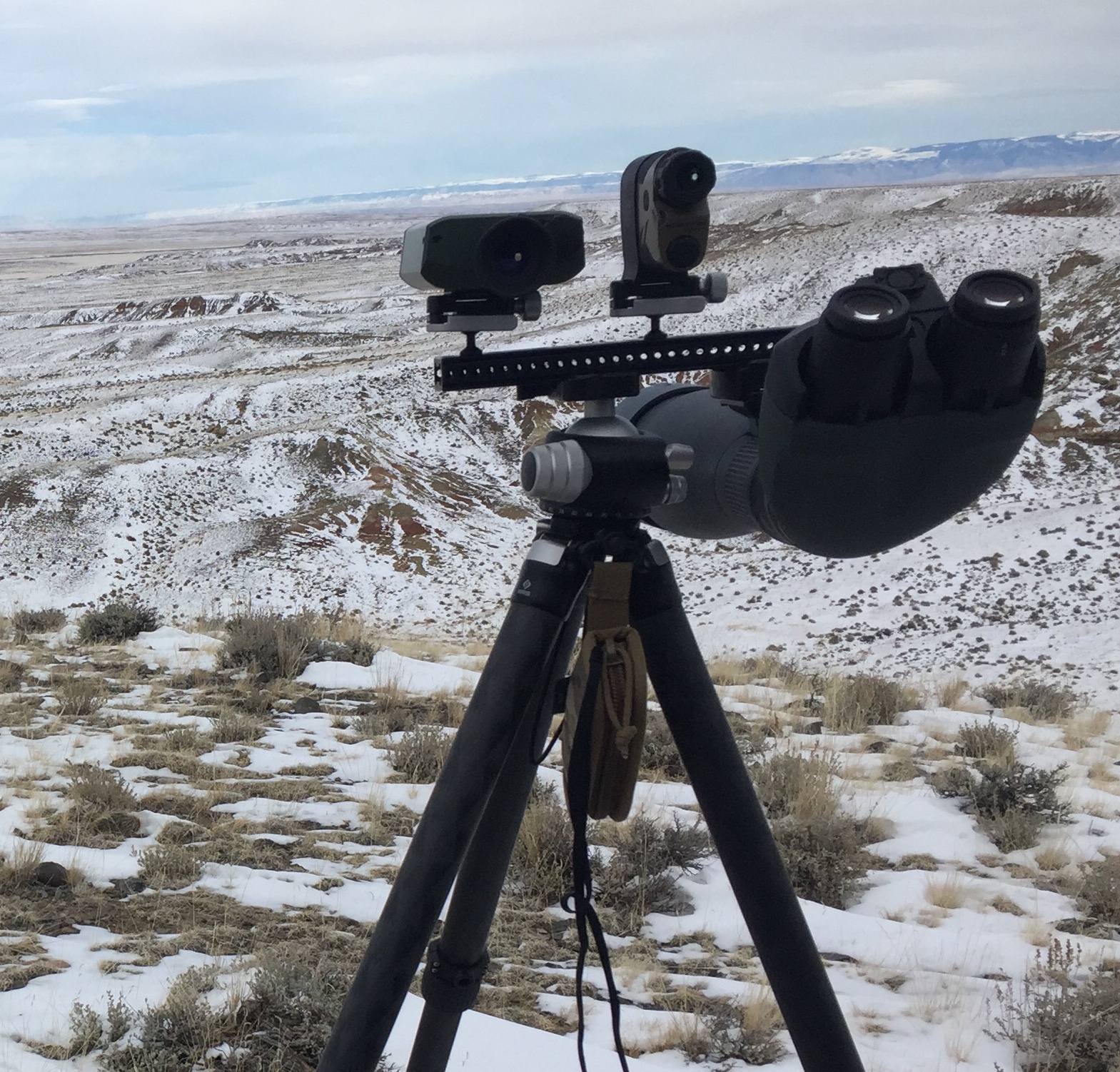

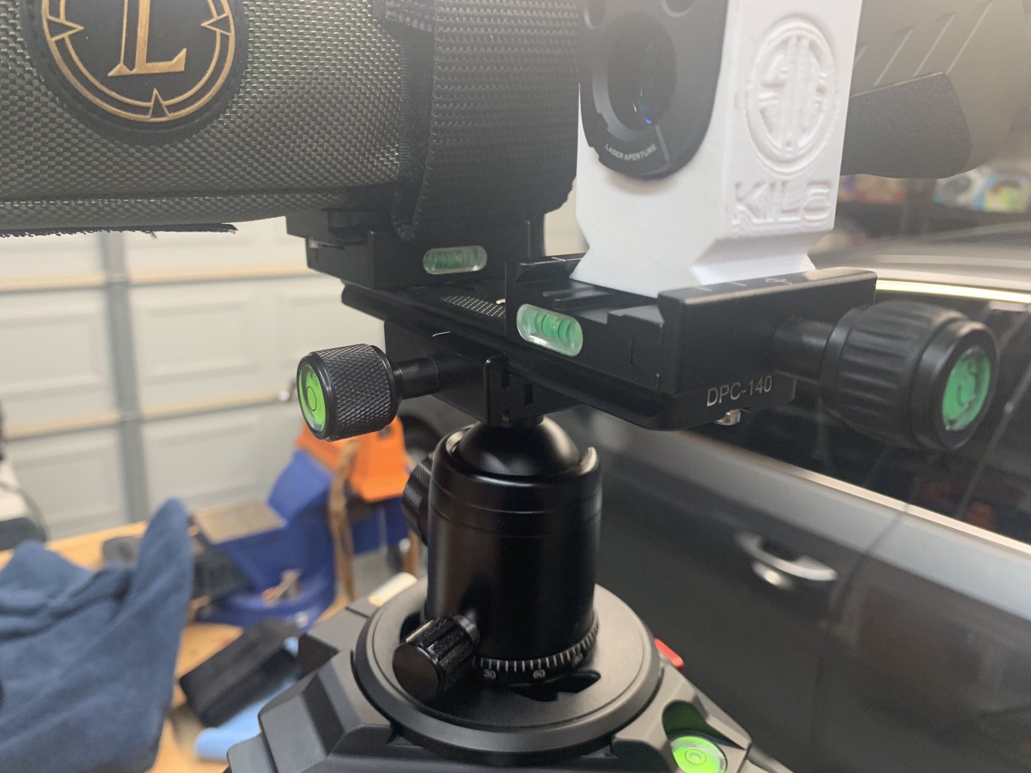

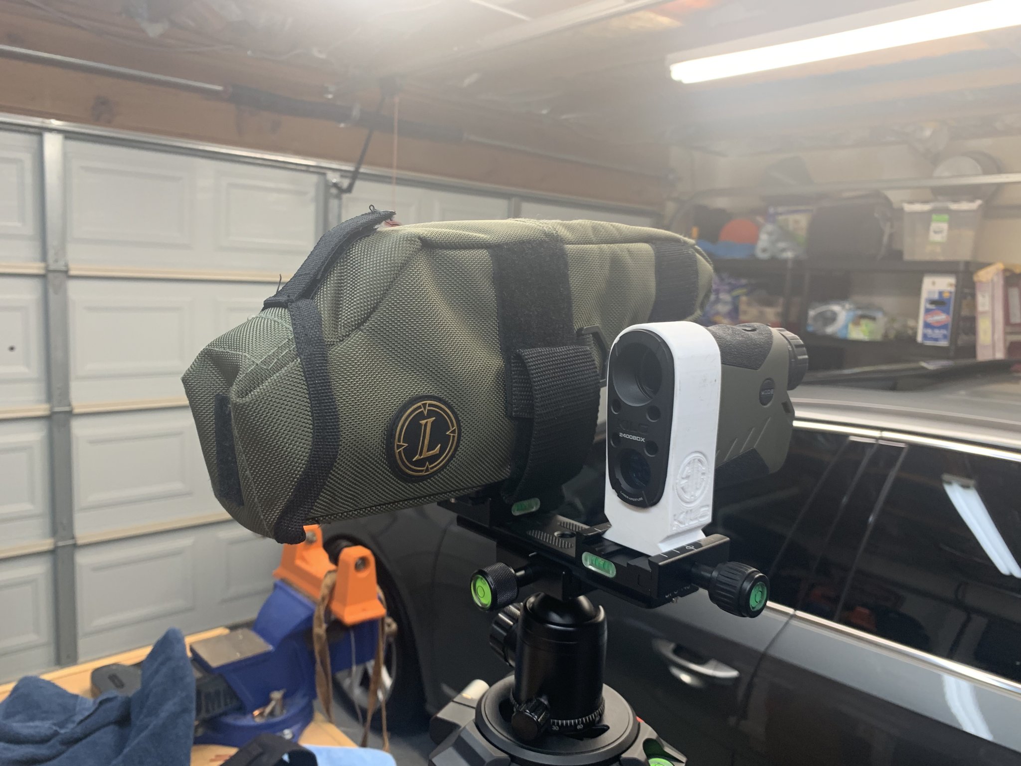

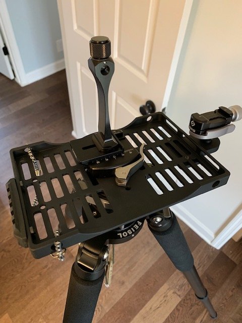

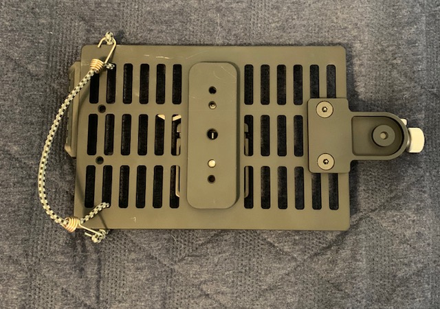

    Got my setup done with a 6" plate and anti-twist bar, a tall Outdoorsmans mount for the SLC 15's, and a BC-18 ballhead for the Leica 2700B. I got one of the ebay 3D printed holders for the Leica and it seems to work well enough. I can co-witness and adjust the RF to align with the binos or pick out individual targets.
    The whole plate/ballhead setup including the Outdoorsmans stand weighs about 10oz. Everything locks down super solid and stable.

    What rail is that? I am having a hard time finding them with the M3 holes
    How do you mount the BC-18 Micro Ball to the rail? Looks like it threads directly into one of the 1/4-20 slot ends?

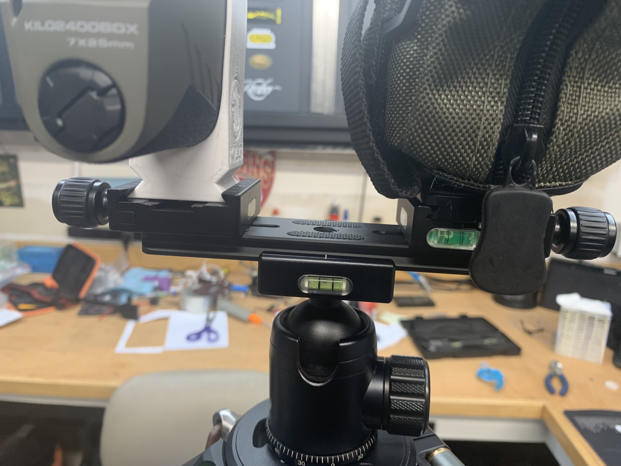

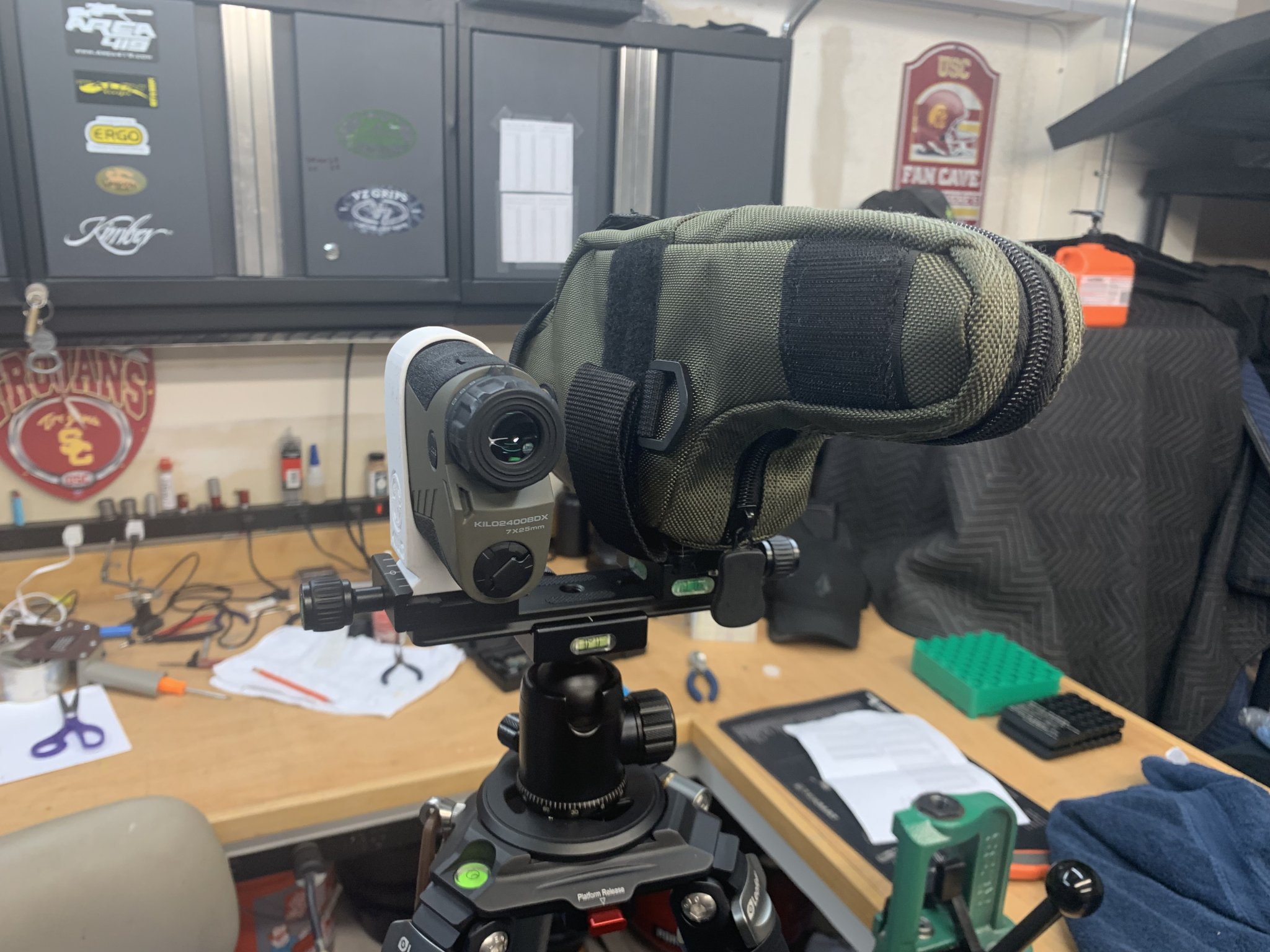

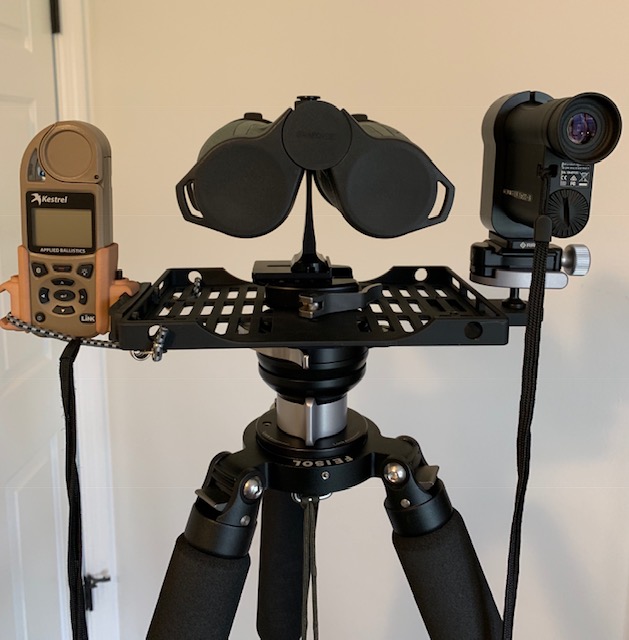

    Grey ops amp plate. It holds two optics can be used as a tac table and can be attached to the rifle for added stability

    It’s a Hejnar 6” plate, I think their multi purpose plate. It came with the anti twist bar.
