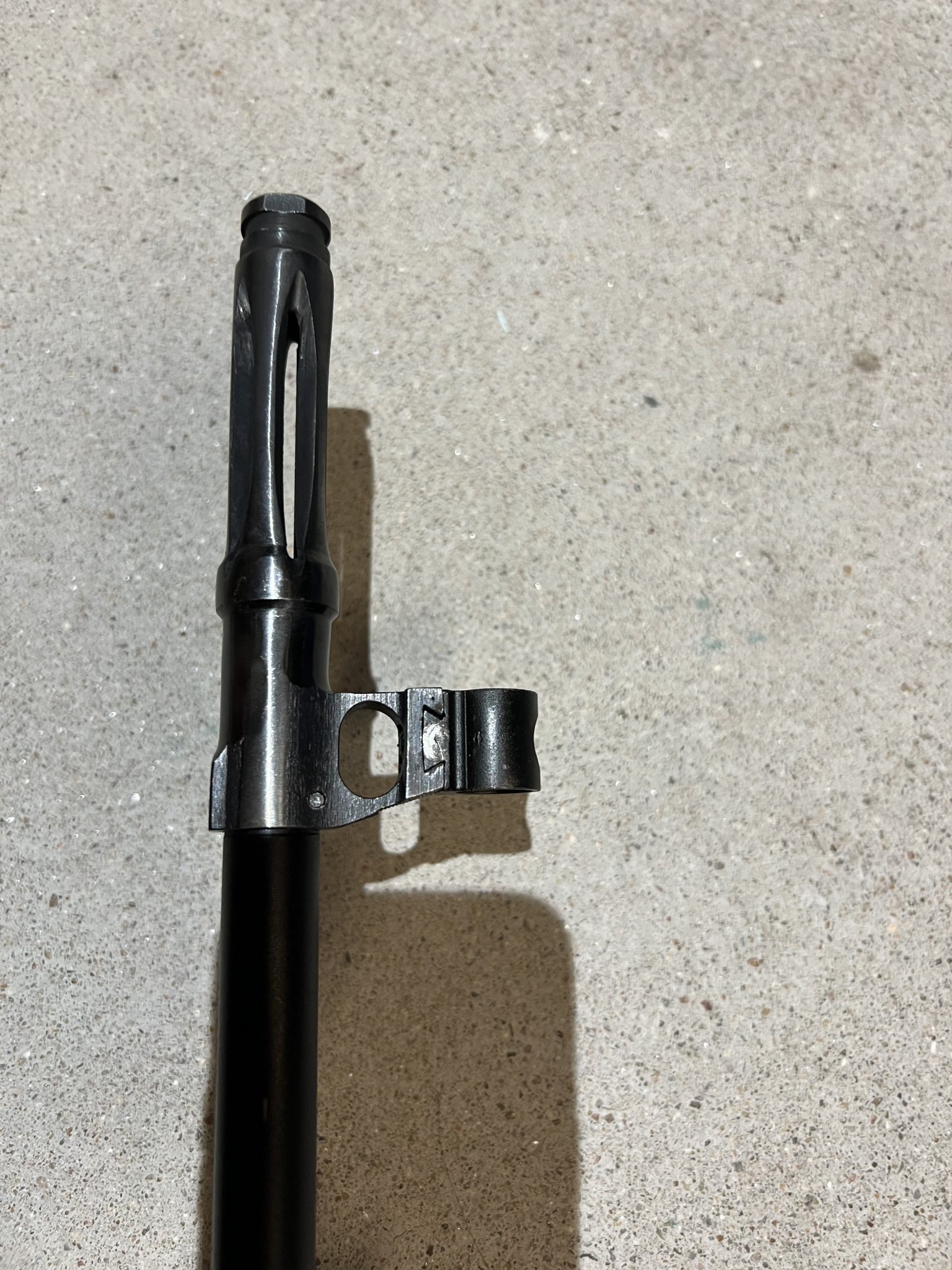

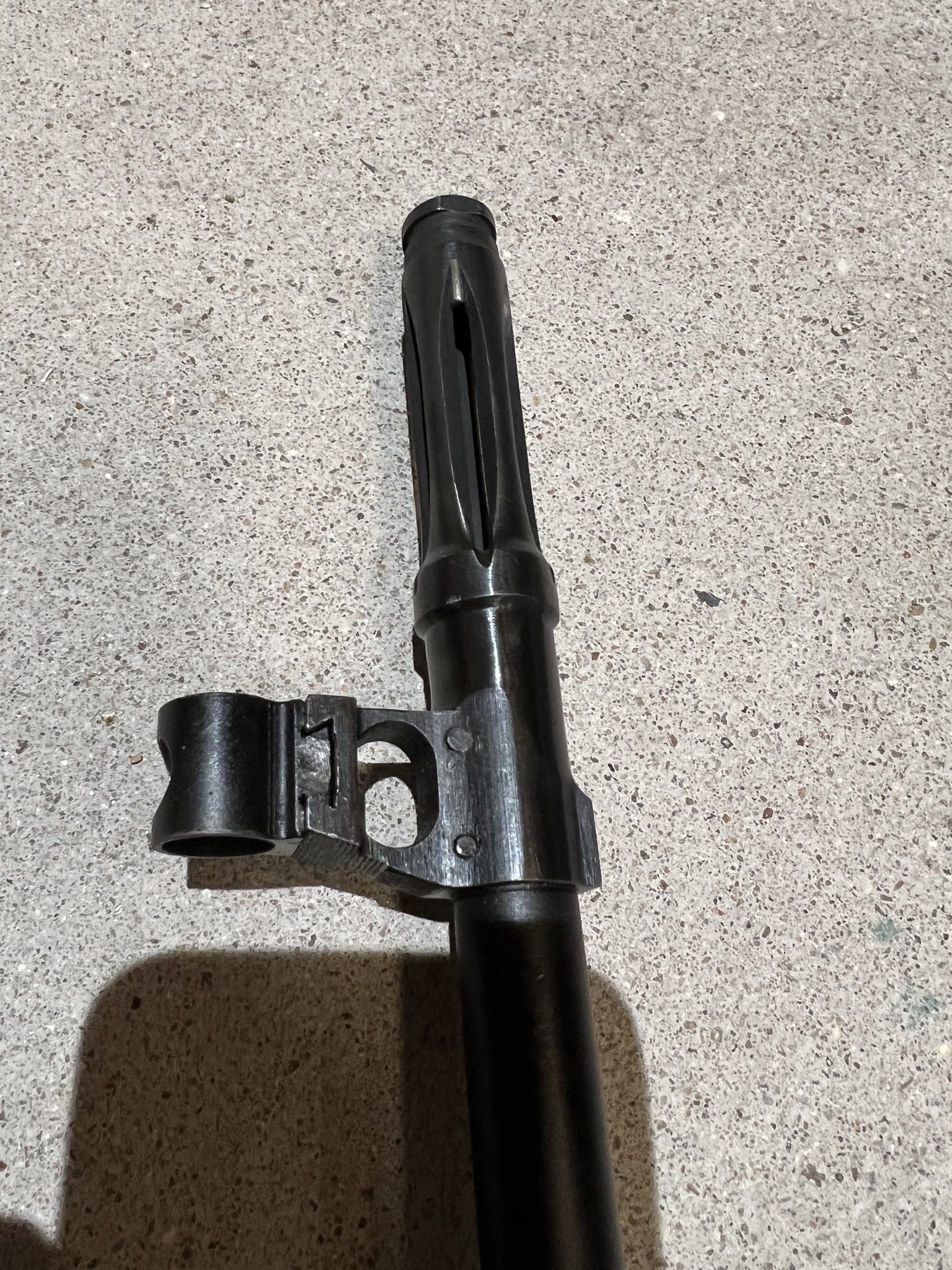

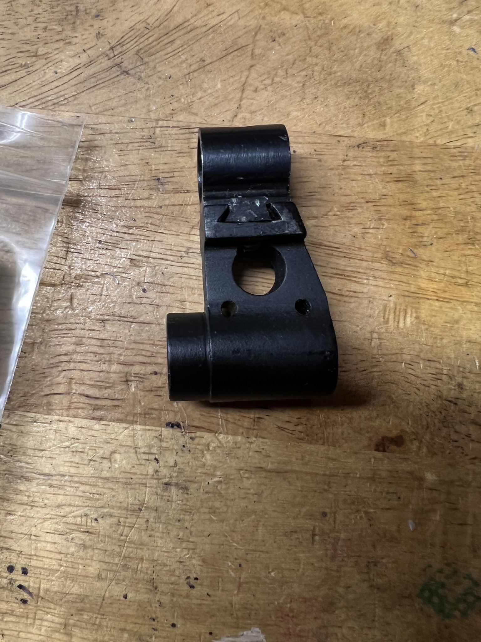

Need a recommendation for a gunsmith who can take off (without damaging) SVD FSB (with one pin blind mounted - see picture). Install a Tiger FSB (with front lip milled off) and thread the barrel for HUXWRX QD brake.

Friend of mine has a Tigr, and I did something similar to this, he just just wanted to do it reversibly which made it a little tricky
you should actually be able to get the pin out without needing to drill it, but you'll need to make a fixture to hold it in place so you can exert enough force on the very slight protruding edge.
if yours doesn't have a small 'lip' to grab, the other alternative is to very carefully thread tap the pin, and use a corresponding threaded bolt to pull it out. pretty much just like getting a stuck bolt out.
it can be done DIY, just be patient with it and it's easy enough.
