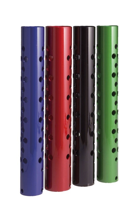

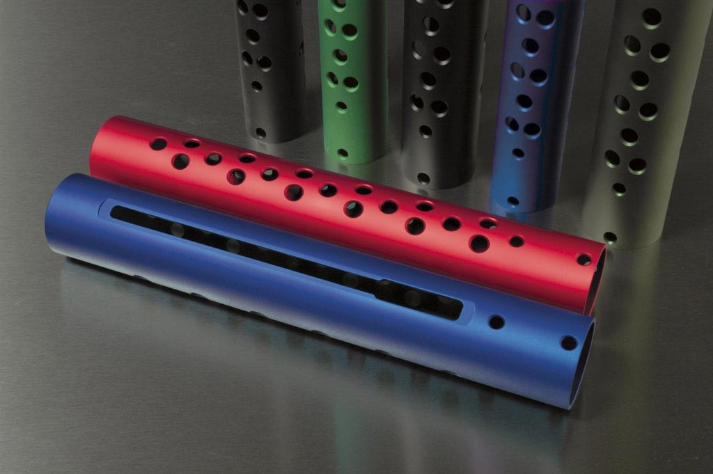

I have a White Oak Armory upper that has the Match Rifle Float Tube forehand grip that i purchased back in 2013. It's round tube that has some large round holes in it.

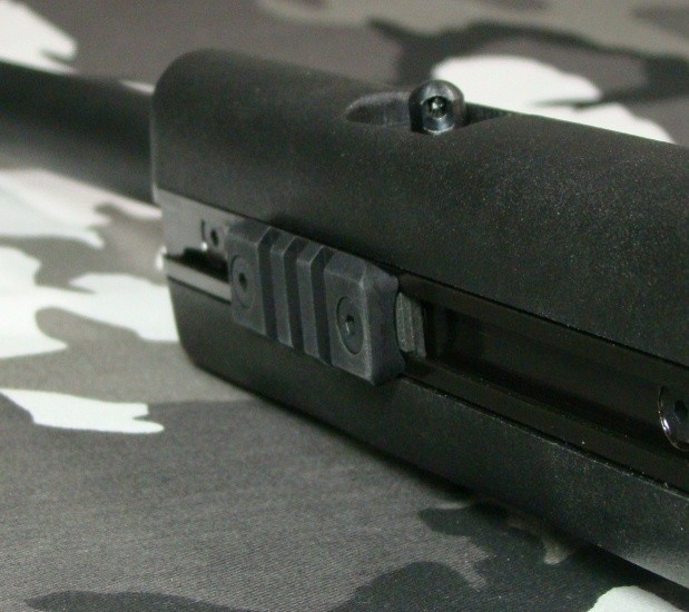

The bottom of that handguard looks like it has an Anschutz rail.
Accushot sells a rail section that is compatible with that slot, part no. BT-28.
