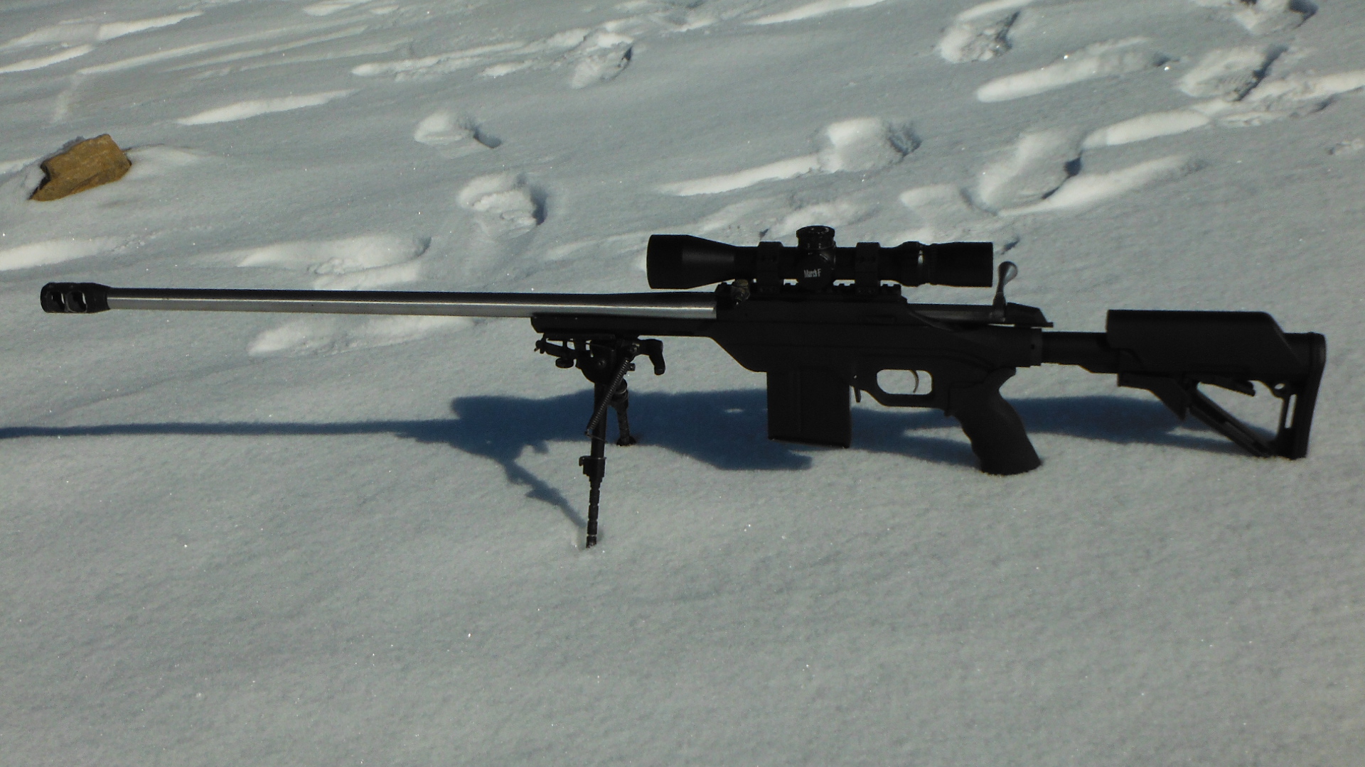

My R5 in the LSS chassis.
Only dislike is that the PRS stock and the adapter give you a LOP of 16"...a little long for me. So I mounted it direct. The PRS stock may not be the best choice for this chassis but I'm trying what I can to make it work. Build quality is very good. I like everything else about it.

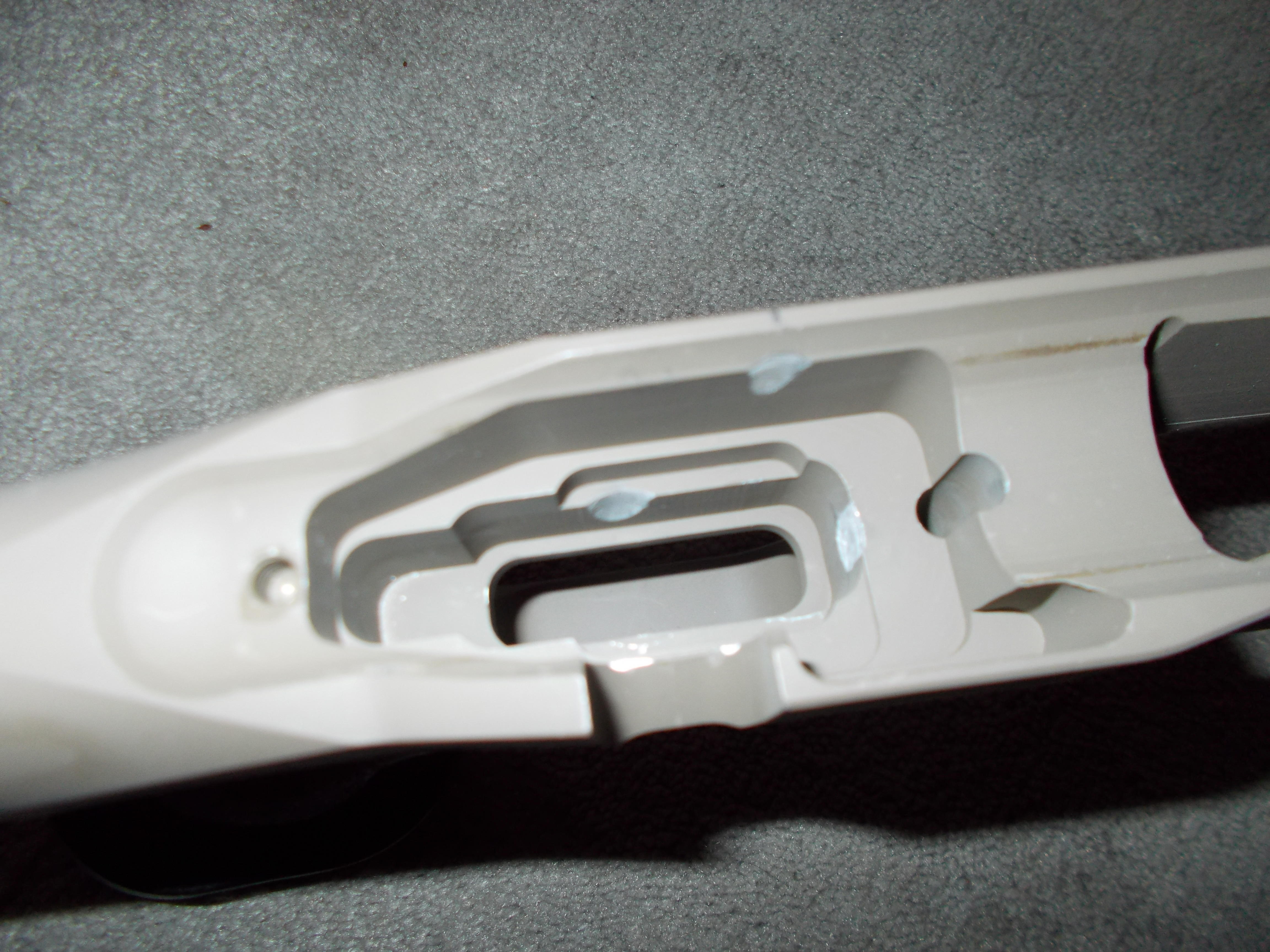

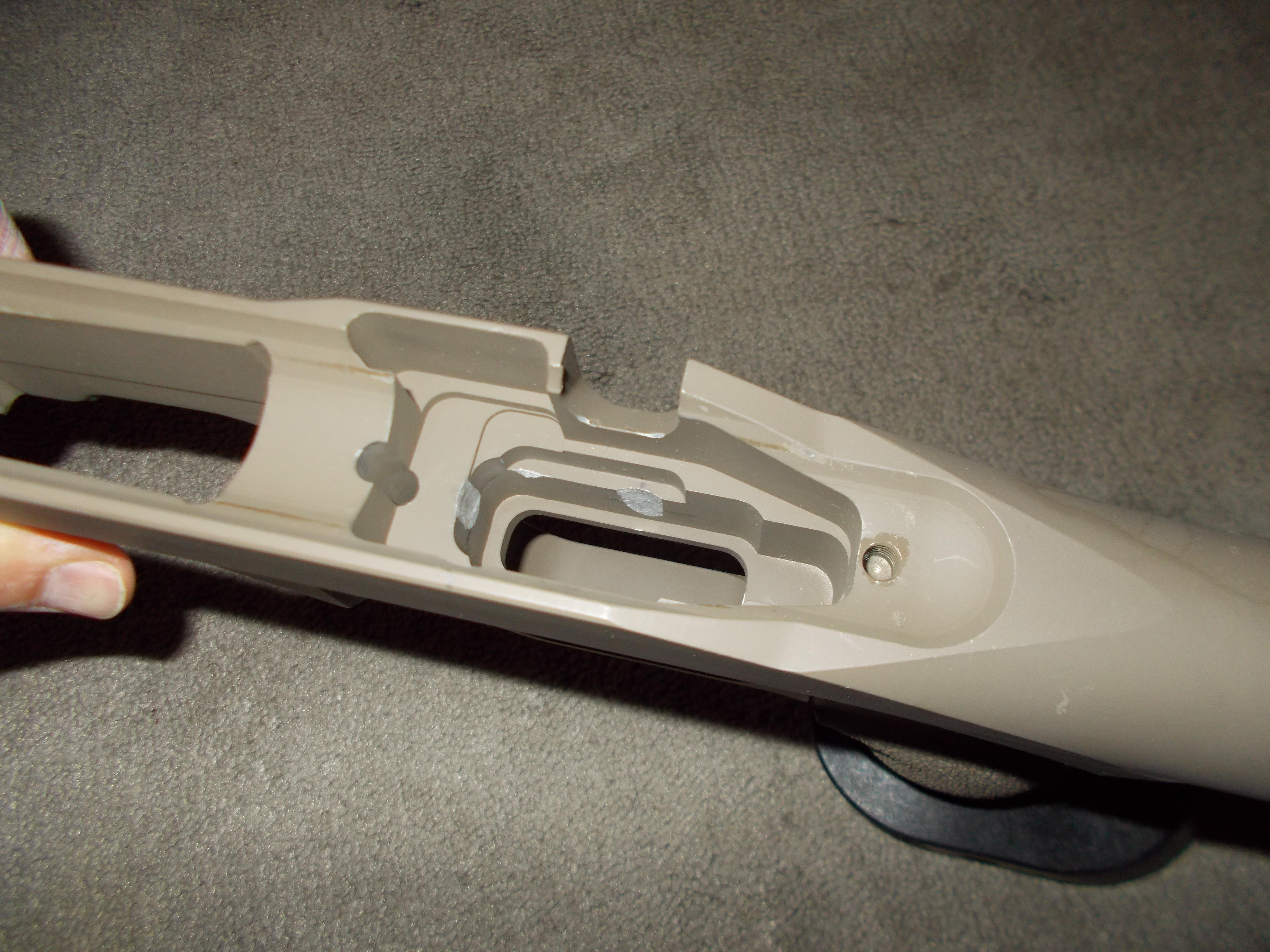

Mine came with the two outer holes on each side threaded. a guy on 308ar.com used the mcrees rail on the front with some kind of mod (found his while I was lloking for some pics before I bought mine):
Remington 700 16.5 .223 MDT LSS Chassis Cerakoted FDE - Rifles - 308AR.com Community
here's some pics, a little hard to see the threading, but its there. outside holes look to be 1 9/16" ctc, or maybe 40mm since mdt is Canadian.

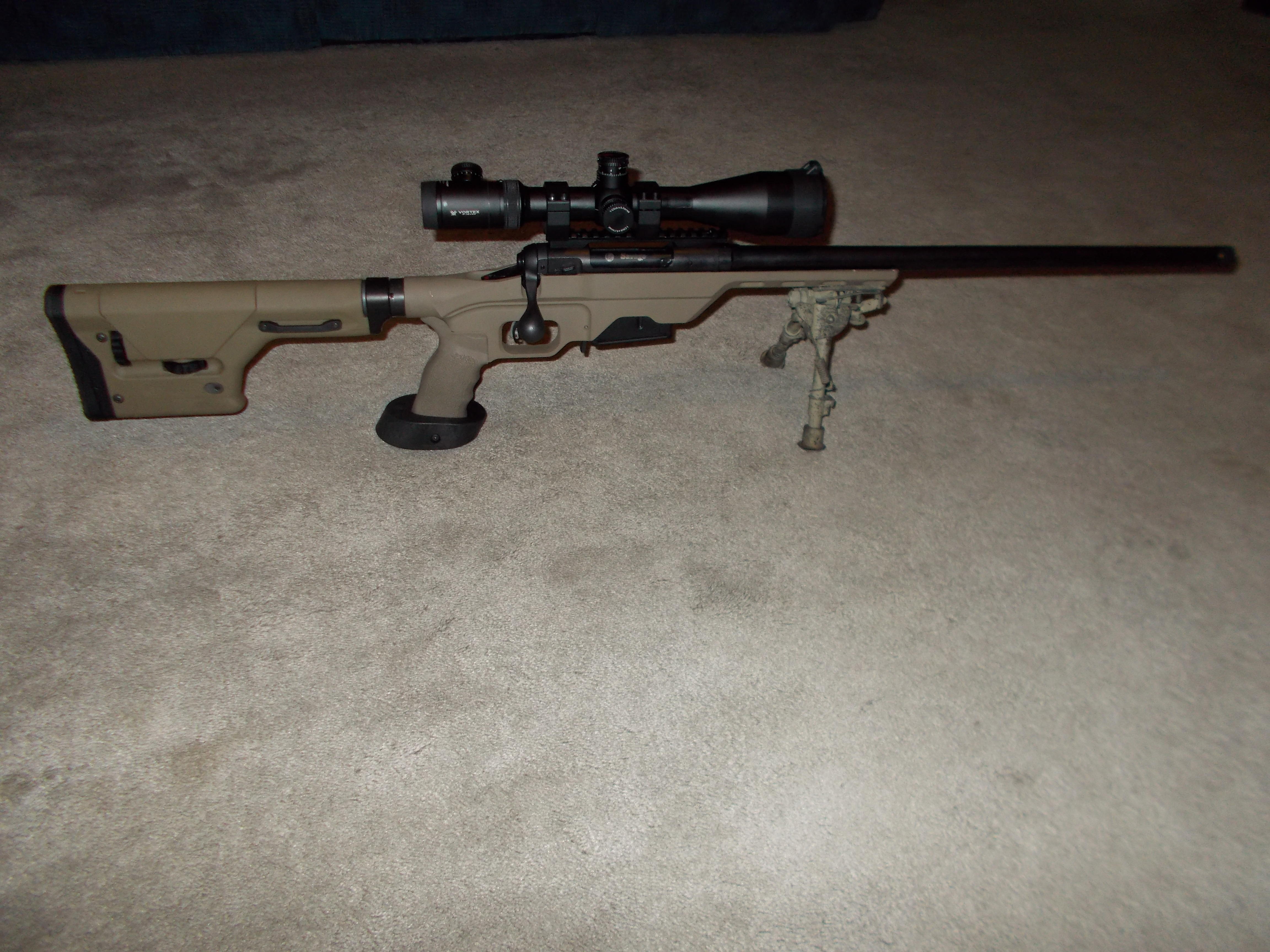

Got the lss , really wish I'd rather gone with the xlr. As mentioned above the stock mount and adapter fit so far back even bottoming your scope turrets to the rear doesn't give you the best eye relief.
* Notice how much closer an xlr mounts a stock to the action.
-On the flip side, with the mdt tac 21 or xlr you may have to swap your scope rings to clear the hand guards

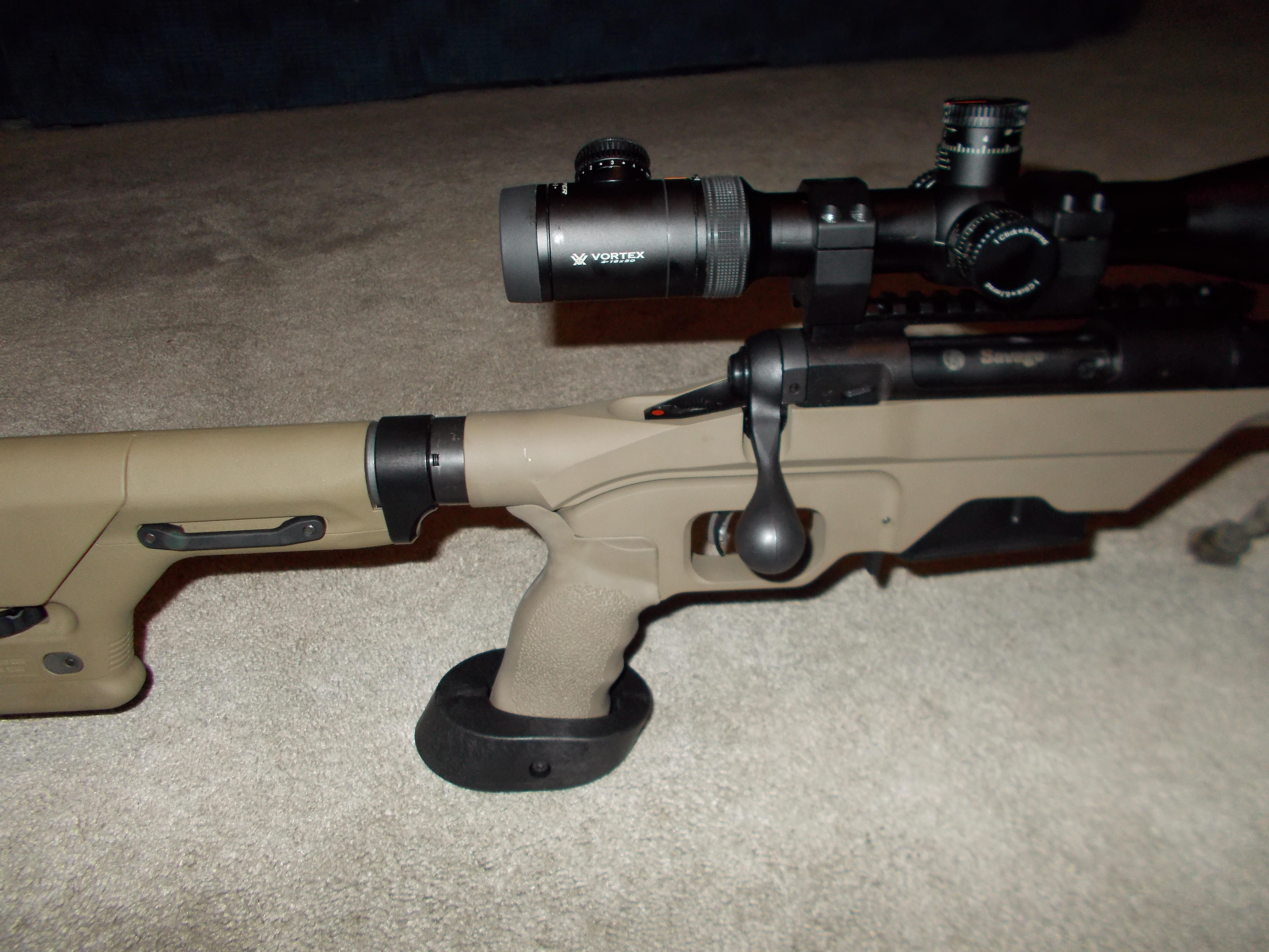

** couple of issues: (with a savage 10)
-the top bolt release rubs in the front and bolt side
-the trigger group pin rubs on the left and right
-the front chassis screw was too long (+ ~1/4 - 1/2")

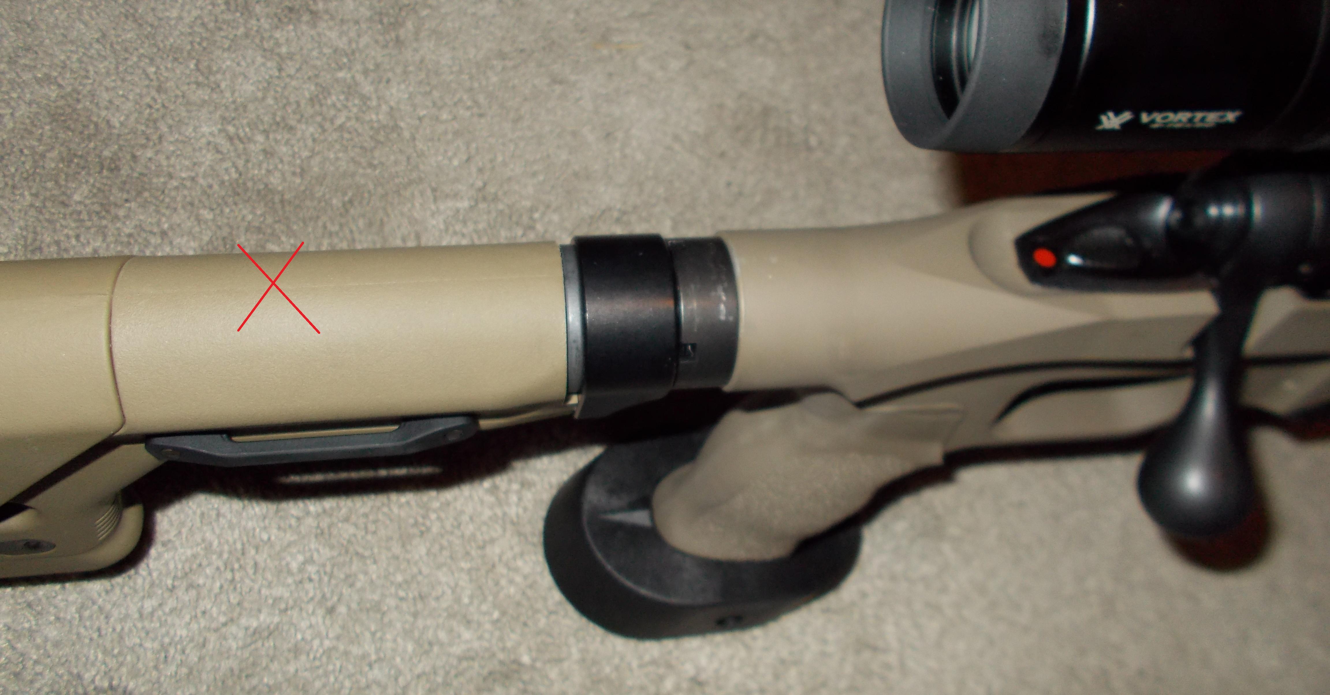

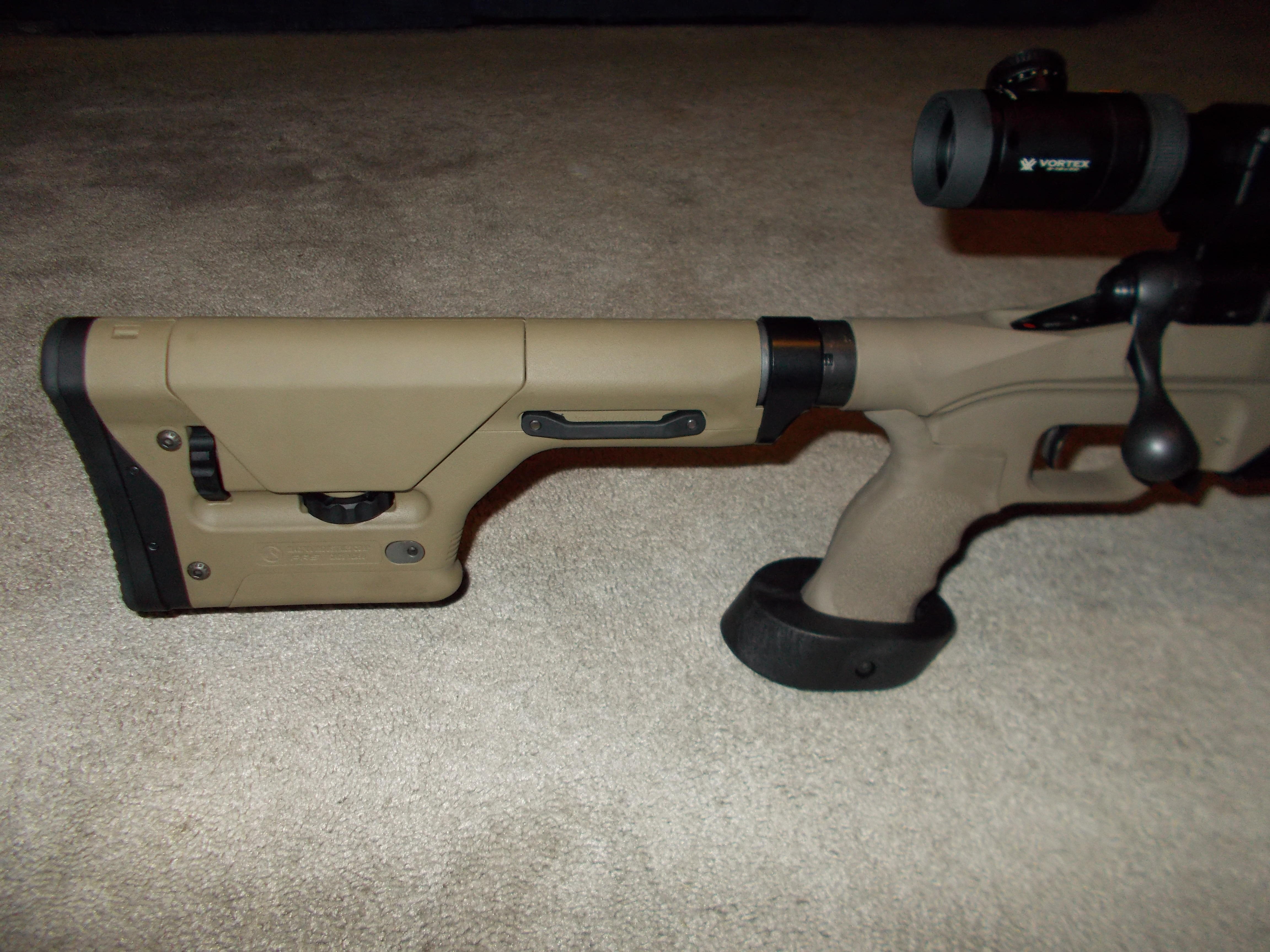

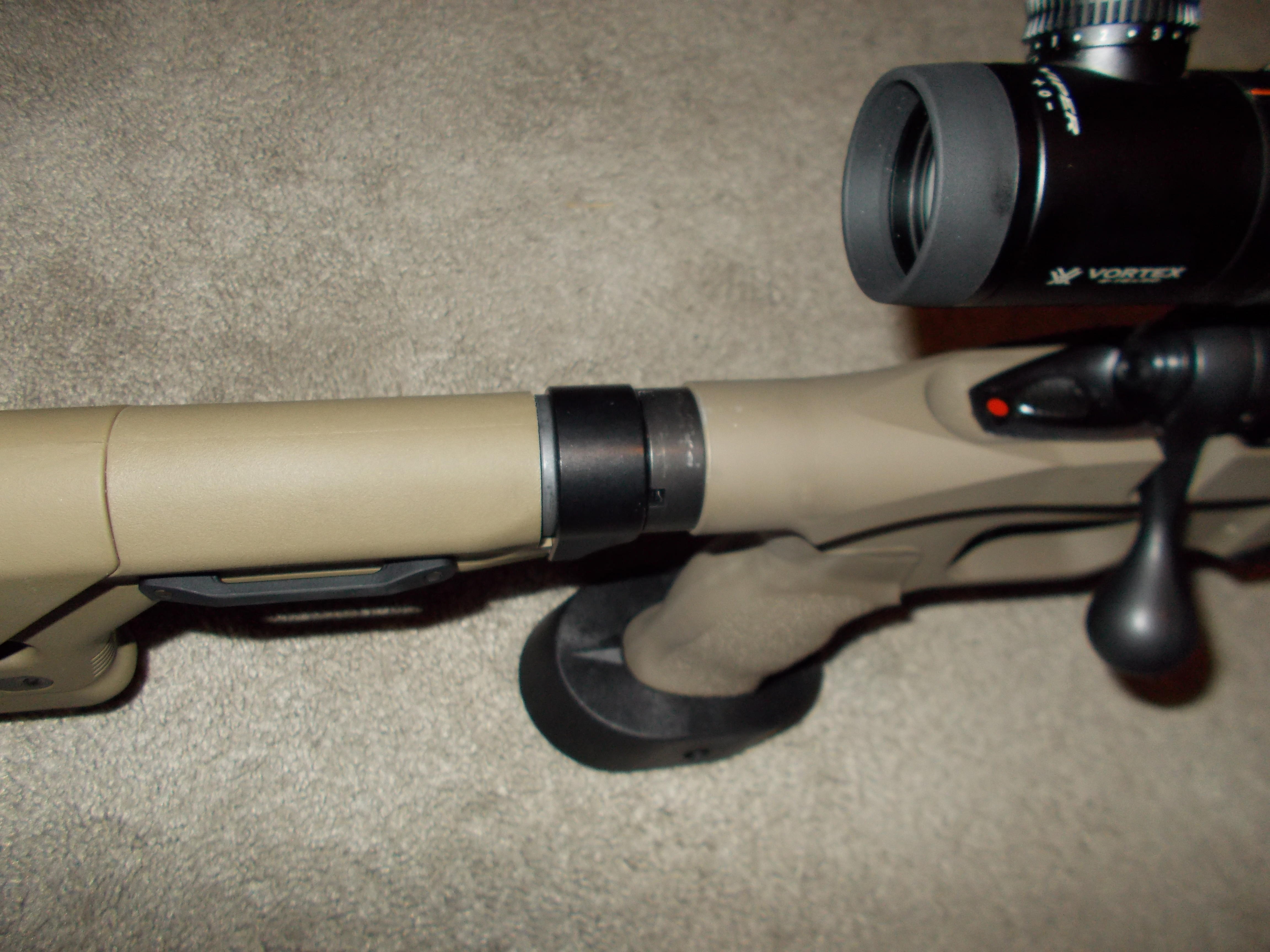

Installed a Magpul PRS , too much eye relief for my vortex pst past 4x magnification
I'm going to try a XLR stock to get closer
+customer service for MDT is prompt and helpful
UPDATES
INFO:
Rifle: Savage 10 308win 22"bbl, MDT LSS chassis, Magpul PRS AR15 stock (NOT the 308), Vortex Viper PST 4-16x50, Talley Scope base.
Pics and measurements:
Affecting the LOP
Fixed stock adapter - 20mm
AR style lock ring - 12 mm
overall gap between chassis to magpul PRS stock - 37mm
Chassis to beginning of cheek riser (PRS) - 126mm
Length of cheek rest - 128mm
picatinny rail base to stock mount - 132mm
chassis sticks out about 22mm from grip to stock adapter
I find that my approx. needed eye relief for the scope mounted requires ~110mm from the scope to my approx. center of cheek weld. (on max magnification in seated position)
As stated above, I had to modify the stock by dremeling contact points, seen in the pictures.
I also had to cut down the front screw (closer to the muzzle) to an overall length of 33mm

Pictured: Dremelled fix and approx. location of my personal needed cheek weld.

Finally done with me build
Rem 700 308 16.5 1/10 (trigger job, 2.5 pull)
Vortex PST FFP 6-24x
Talley 30mm High mount
MDT LSS in FDE
MOE Stock
MDT fixed stock adaptor (use a buffer mounter QD for my sling)
1/4 Cheek riser
Surefire 762 brake
Ergo grip
6-9 bipod (I think it's Harris but not sure)
