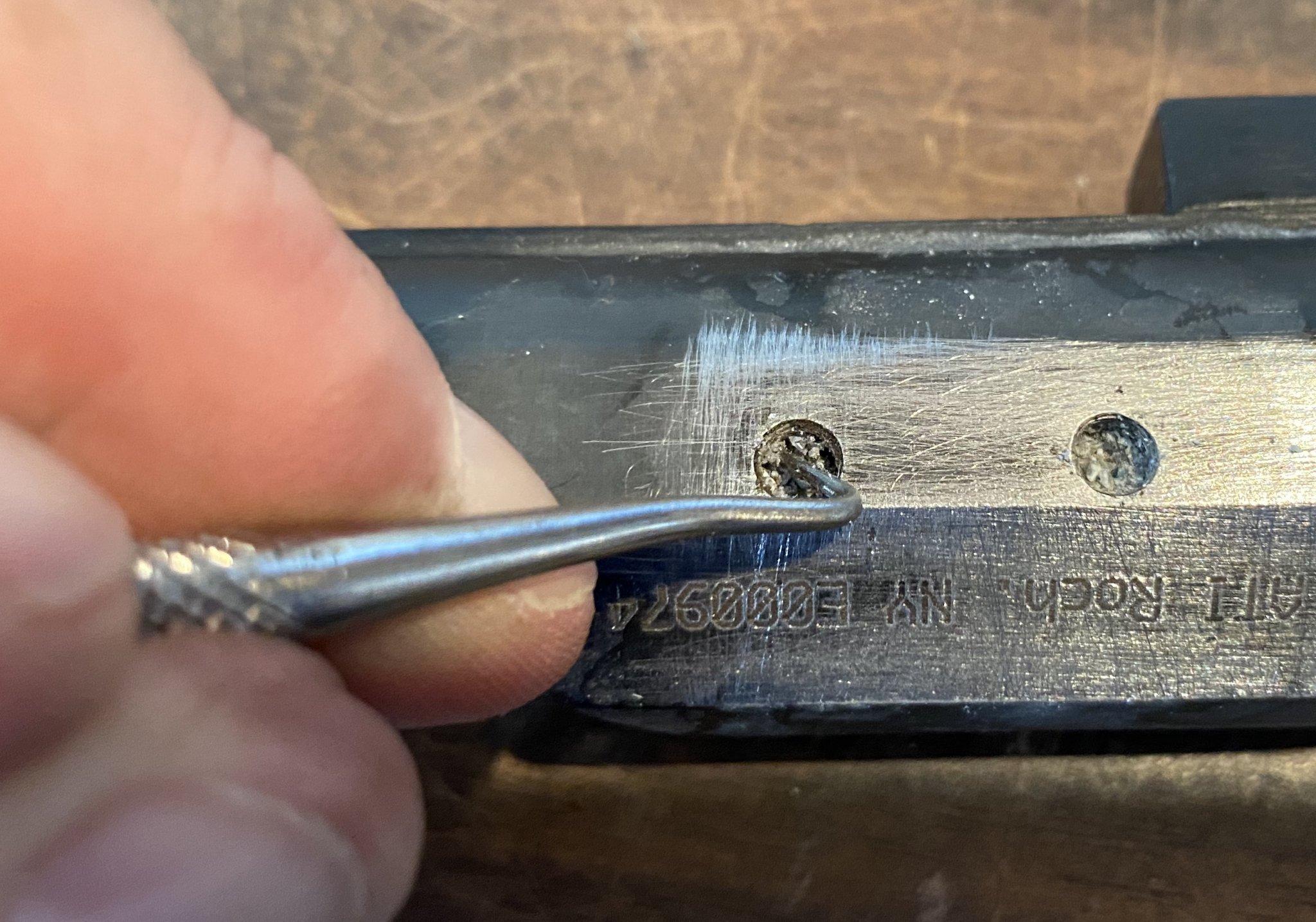

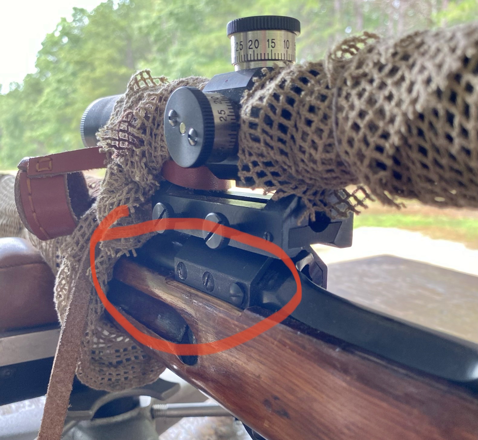

I have a mosin nagant sniper rifle. The smith who mounted it left me with a problem. A) theres a gap between mount and reciever. B) the screws (circled) keep loosening no matter what I try. I was thinking why not try silver soldering the mount like the Germans did with their mounts and scope tubes.
I am aretired welder with experience in gas welding, but I never tried silver solder. Has anyone tried this, any advice would be greatly appreciated

I was considering using an epoxy- jb devcon etc, to fill the gap between mount amd reciever. Then using same epoxy to seat the screws also?
the gap is slight but I believe under recoil it creates just enough movement to loosen the screws, over time. The screws are already loktited in, and its not holding.
If the epoxy filler can stop that movement I think that might solve the problem??

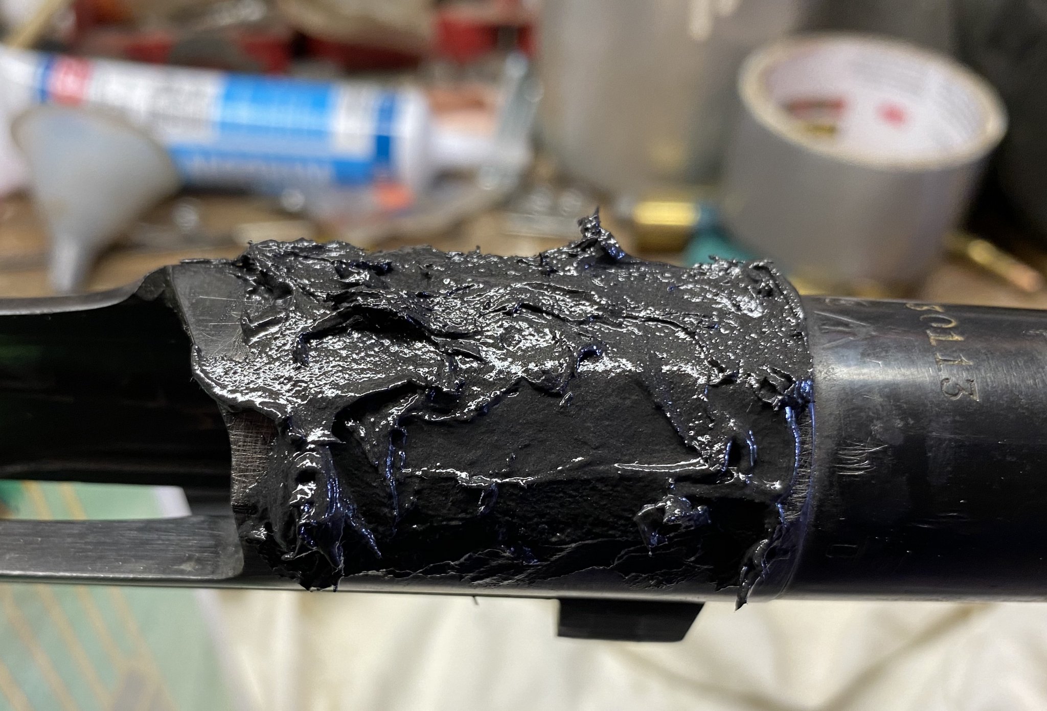

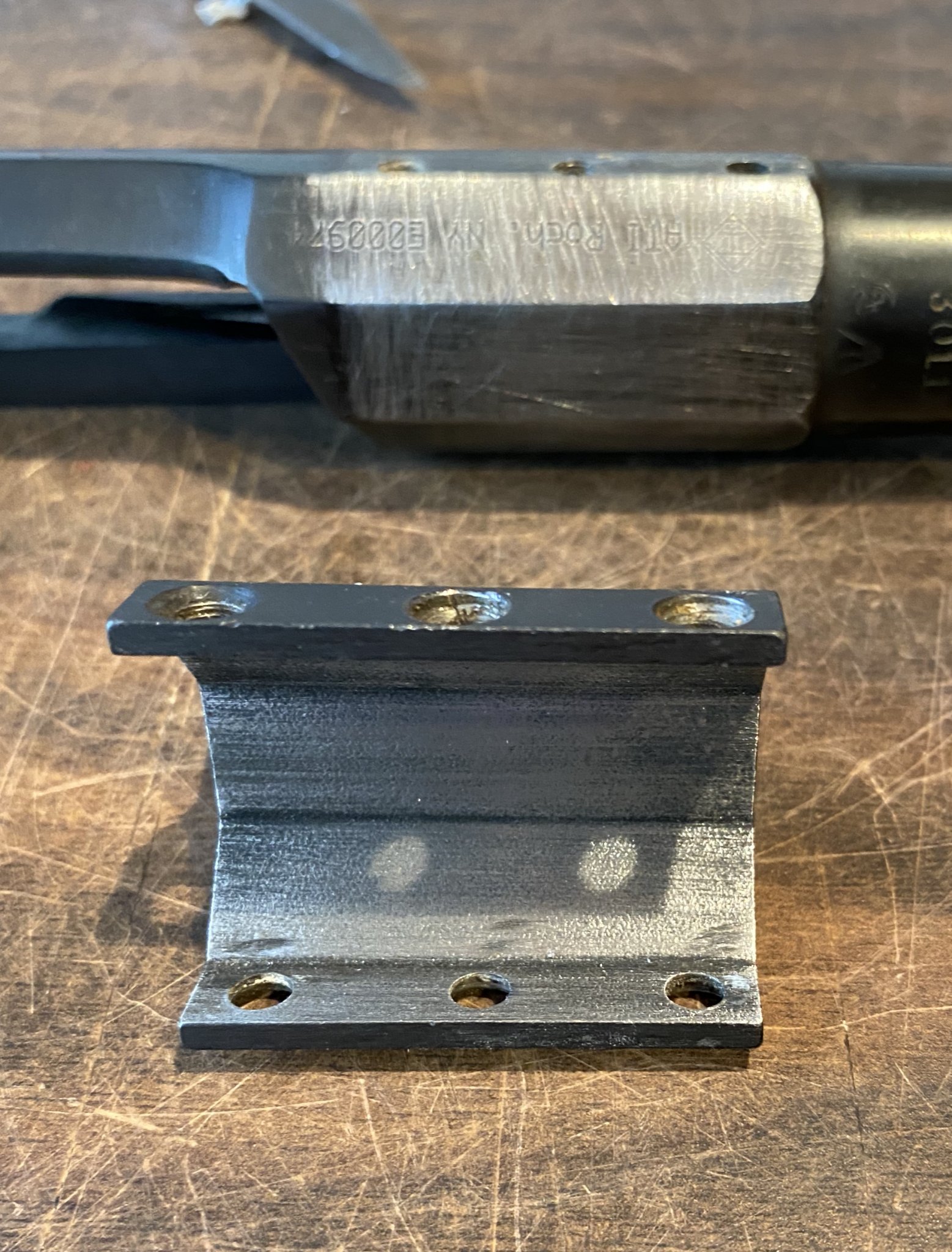

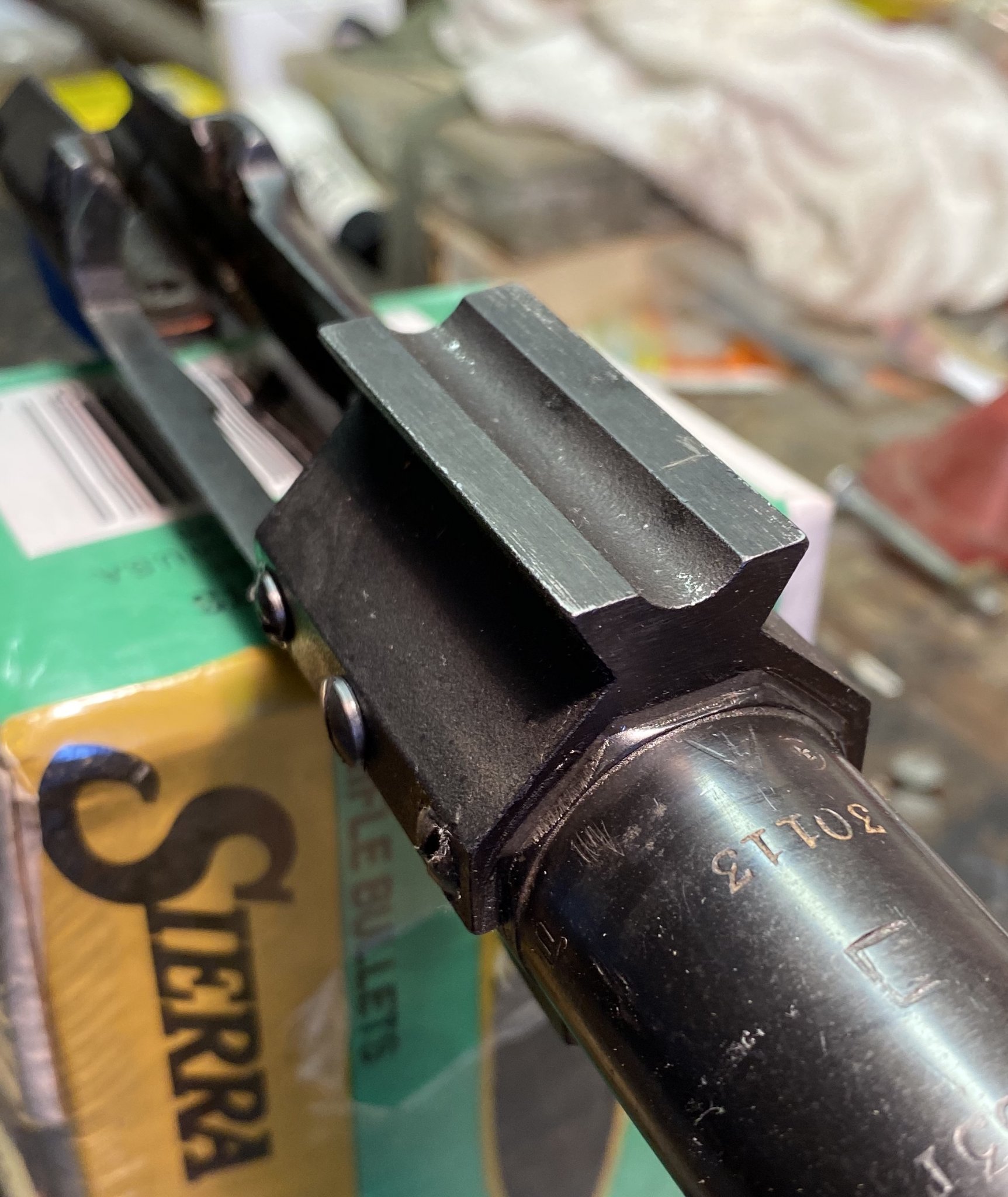

I thought I would post a follow up on this rifle. After thinking it over (procrastinating) I decided to try the epoxy route. I cleaned up the action and mount, then got busy with the screw holes. When they were cleaned out of all the old loktite I mixed up some pro-bed and laid it on. Got plenty in the screw holes and locked it down.
Several hundred rounds later amd the fix seems to be working, it’s holding tight.
That was the correct fix. Silver solder would have been a bad idea.
Had you silver soldered, you'd have destroyed the heat treat in the front of the receiver.
All of this is right in the area of the lug abutments.
It would have softened the abutments and they would begin to set back rapidly as you shot the rifle, eventually creating excessive/dangerous headspace and possibly even a catastrophic failure at some point where you'd end up with a bolt through your forehead.

Thanks for the advice! I wasn’t really crazy about silver soldering, because of the heat factor. So far this epoxy is working. The whole issue with the mount was the gap between mount and reciever. That has been dealt with- hopefully for good
