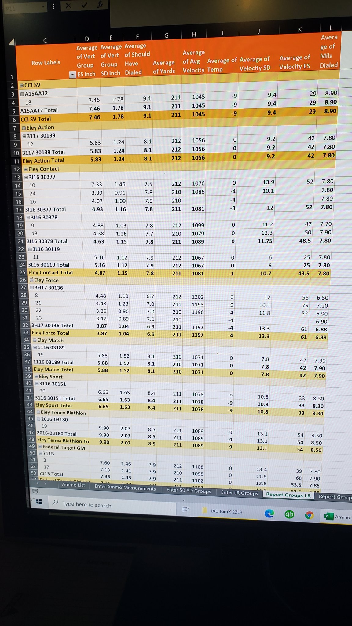

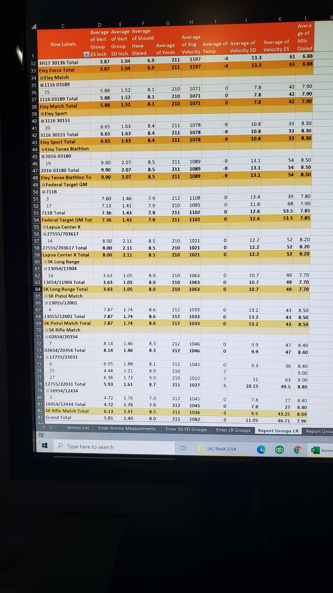

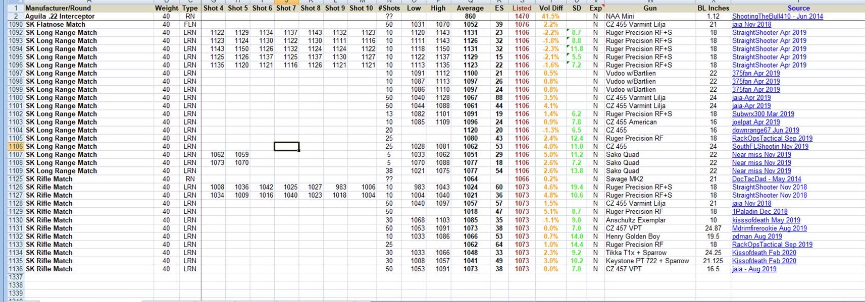

Need veloicty data !
The following Barrel lengths and ammo.
All SK Ammo long range, rifle match, plus ,high v match flat nose.
in 18",20",22" and other lengths
Here's what I have:

That spreadsheet...... 😲🤓🤤
Any chance you could pull a pivot table off of that comparing ES and SD in relation to barrel length? I know not scientific but....
The problem with in comparing those things in this spreadsheet is that different ammo is used in different guns. Like in a 3" barrel from a pistol, one typically rather cheap stuff rather than match grade ammo. Whereas for many of the longer rifle barrels, quality match grade ammo is used, so ES and SD can't really be compared well. But if I take something like Winchester SuperX that's fired in various pistols and rifles to get a good variation in barrel lengths, one can see that there really no correlation evident. And that's what I'd expect since ES's and SD's of MV values are really nothing more than a measure of cartridges performance relative to each other out of a particular barrel.
I'm attaching to excel files with the extension changed to PDF that I can upload it here. So, you'll need to change the extension back to .xlsx to open it in Excel.
Thanks! I agree 100% we would also need to know lot# etc.
