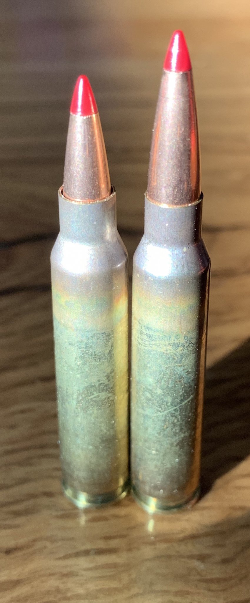

The ar mag lengths cut the legs out of a 223 case with a decent bullet in it, it’s designed to fit in a small frame ar, not to be good.
A 75 elf seating to ar mag length 2.260 and to a bolt length at 2.419 which is .025 off the lands in a wylde chamber.
