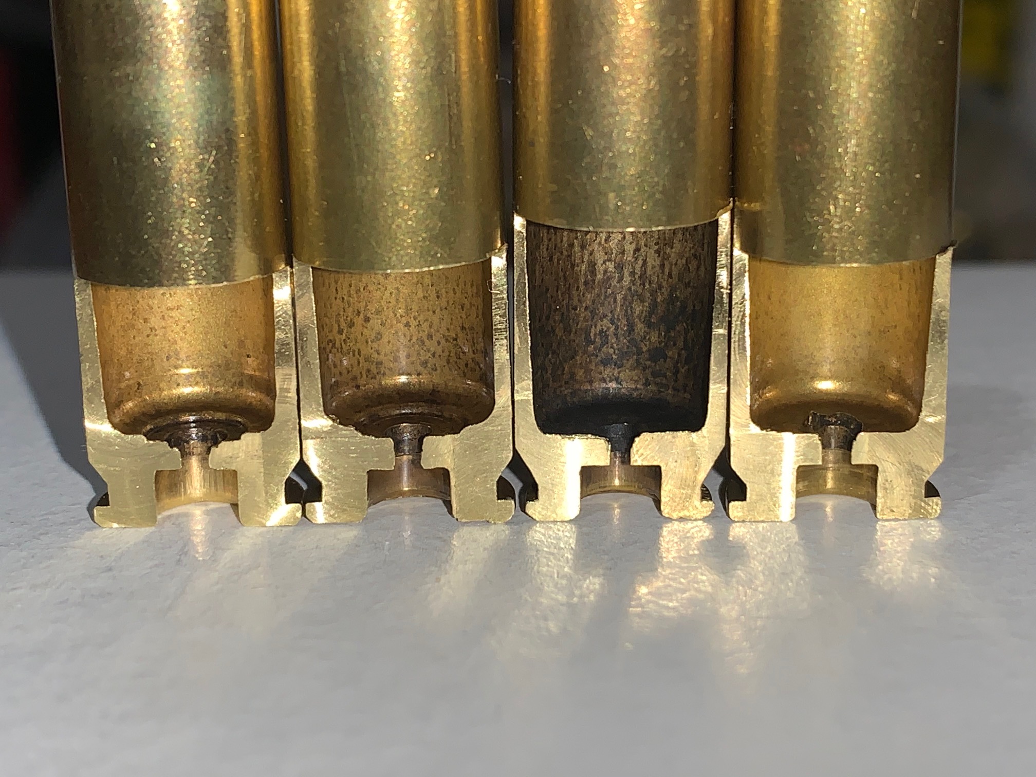

    The best speed I've had has been with Lever & how much depends on brass. 224V brass is all over the map. 31.2 - 32.7 h2o of once fired. Hornady has the least & Federal is upper end, but it's softer & primer pockets go south fast. I think Starline (far left) is the best with decent capacity with reasonable pocket life.
    Wall uniformity on the Hornady (2nd from left) is terrible.
