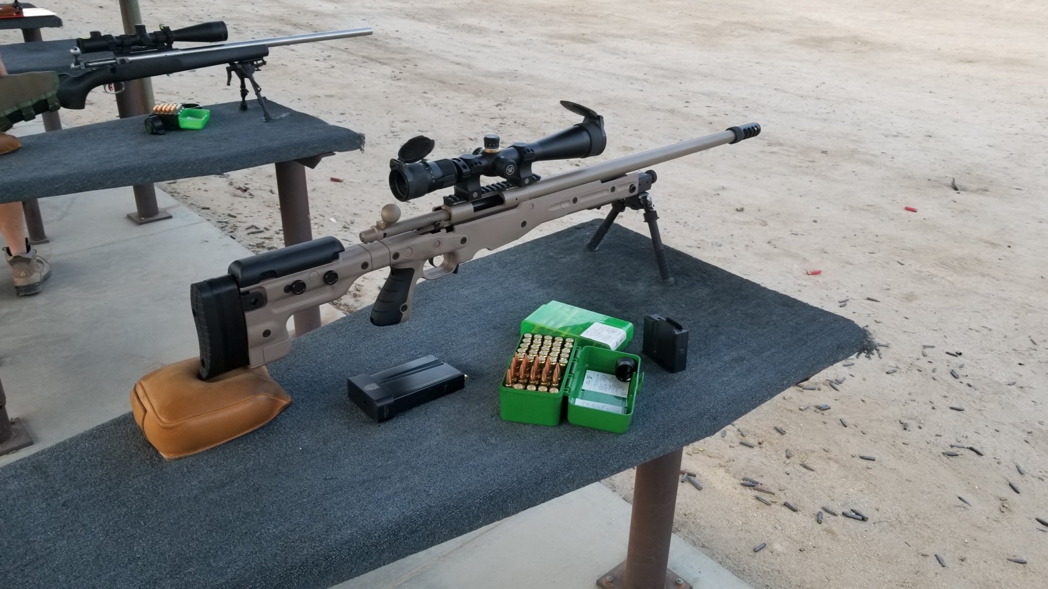

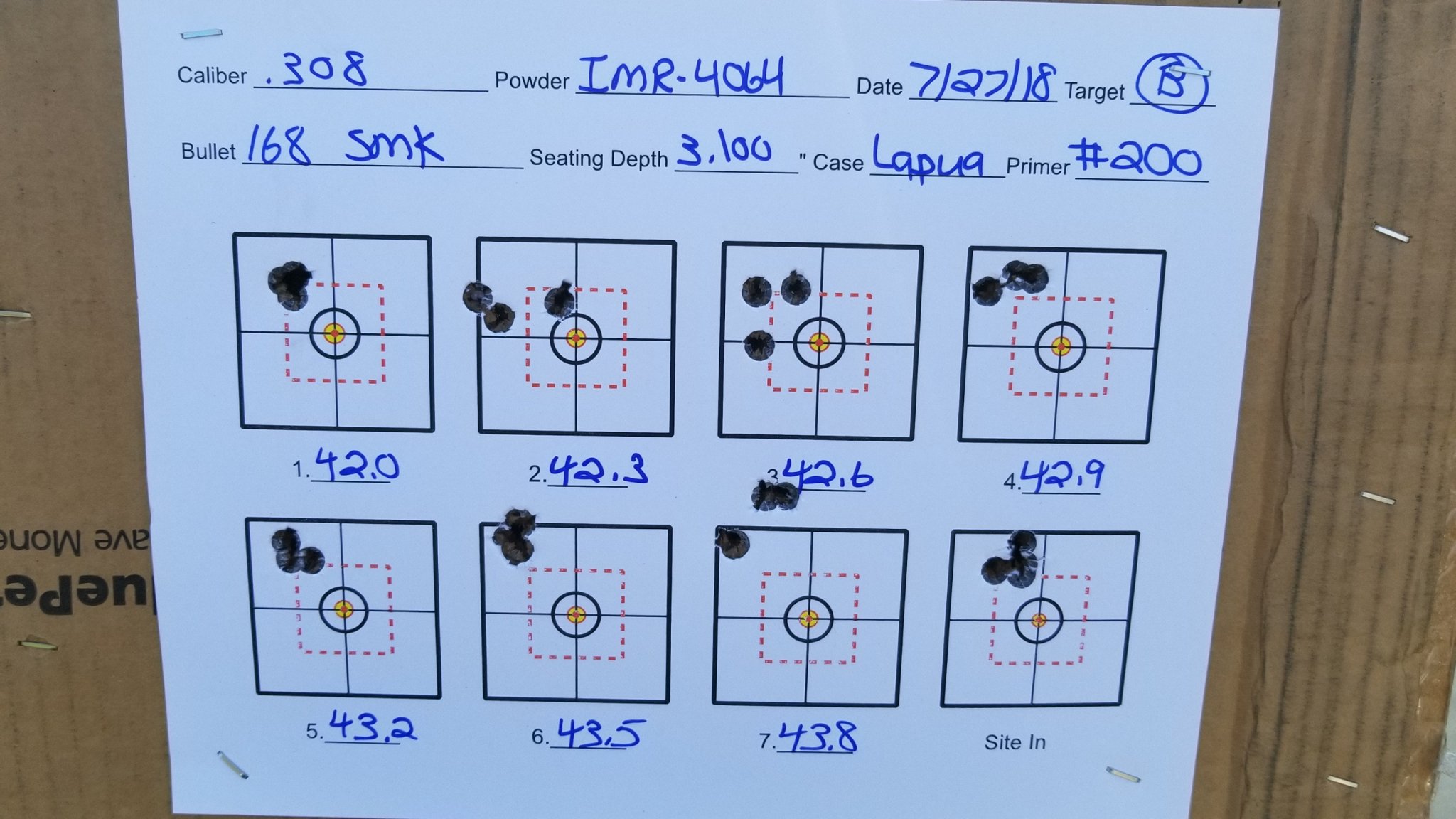

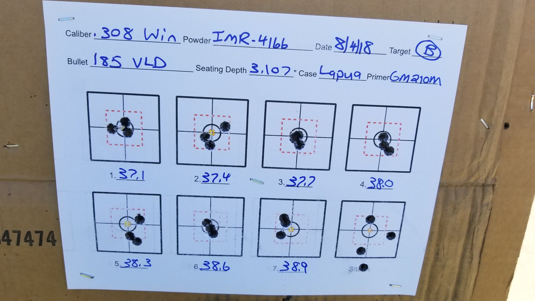

Rebarrelled blueprinted Remmy 700 action with Bartlein 5R. Old Vortex stuck on there but ladder is looking promising at 100 meters. Tried 155 Scenars too. Twist is 1 in 11.5 like the AI Switch barrel. Have shot 1 in 12 and 1 in 10 and this 1 in 11.5 seems to he an excellent compromise. So far 155 through 185 Juggernaut shooting under .1 with right load. 20 off the lands of course.

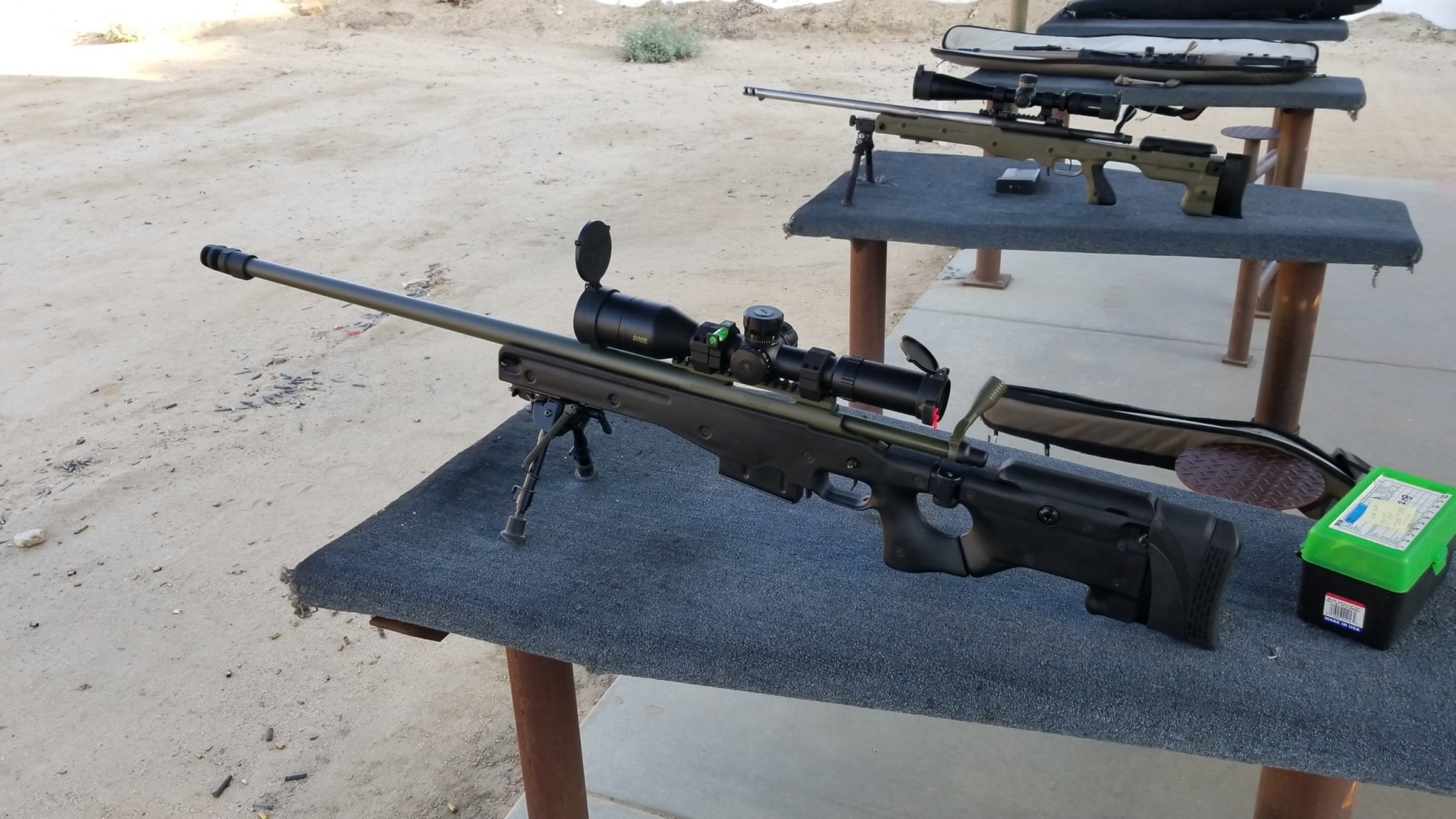

Thank you - I know what you're saying as far as dialed in but as I am sure you know shooting one hole in a 3-shot ladder is a far cry from 1 hole 5 shot groups consistently. I just picked up another rifle - a 300 wm built by Randy from R&D Precision (I hope I got that name right). Apparentlynhe builds amazing guns and he taught the gunsmith I use for all my work as they are friends. I just ran a few through it when deciding and just quickies, shot 4 in 1 hole. Amazing gun - Ill post pics later.
