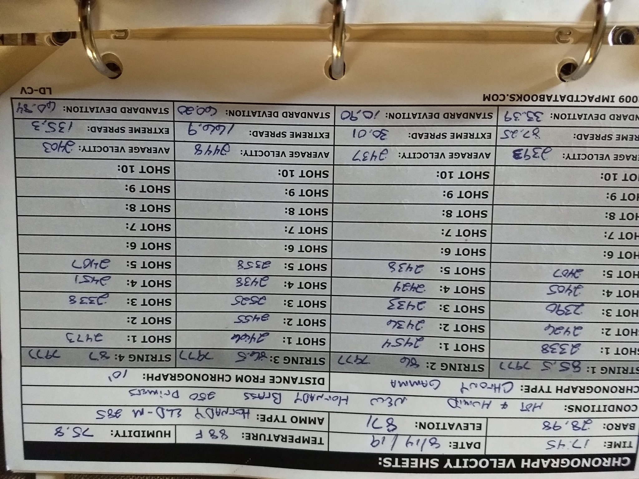

Well I finally got to load some up and throw some lead. Not really happy with the grouping at all. And not sure what's going on with the spread. I'm curious if the primers could be causing some of this. I used the CCI 250. I know my writing is horrible but here it is.

Morning guys. Well I loaded up a bunch Friday and went shooting yesterday. I took a drive earlier in the week to Hyatt's gun and picked up a couple pounds of h1000 and finally got me some Federal primers. 215m's YEAHHHHH
Do I used my Hornady brass and eldm bullets the 285. I loaded up 20 with the 7977 in .5 grain increments with the 215m primers. ,,,
And then twenty with the CCI 250 primers and h1000 in .5 grain increments. I used up my CCI primers by doing that. And won't use them again unless I have to.
The primers alone, although did not change the average velosity much (7fps) the ES and SD changed a lot. And seen it on paper as well. When I shot the other twenty I was equally impressed with the results. The h1000 although seemed to push slower. The difference between the 7977 at 85.5 grains an the h1000 was 30 fps not much but with the CCI primers the ES was 24.85 and the SD was 10.53
My best grouping was with the 7977 86.5 grains and the 215m primers about a 3/4 inch hole 100m bipod only. Not that it matters but it was a 5+ mph wind. I must say I really noticed this bipod I'm using has an issue. I was able to see and ever so slightly movement in the wind ( left to right) ? I noticed some springs on the pads. I really want that elite iron. But funding is tight at the moment. Think I'm going to start using bags for these little test. Anyways I'm really excited about the next test. H1000 with the 215m primers. Wish my velosity was much higher. Something to mess with in the coming weeks
