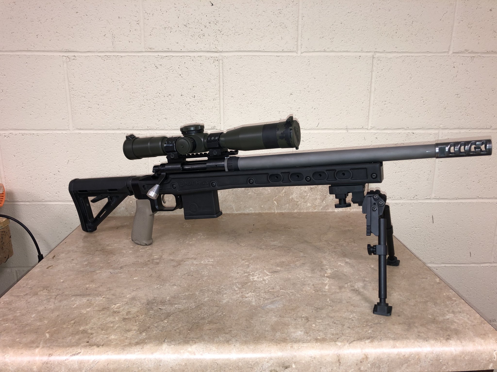

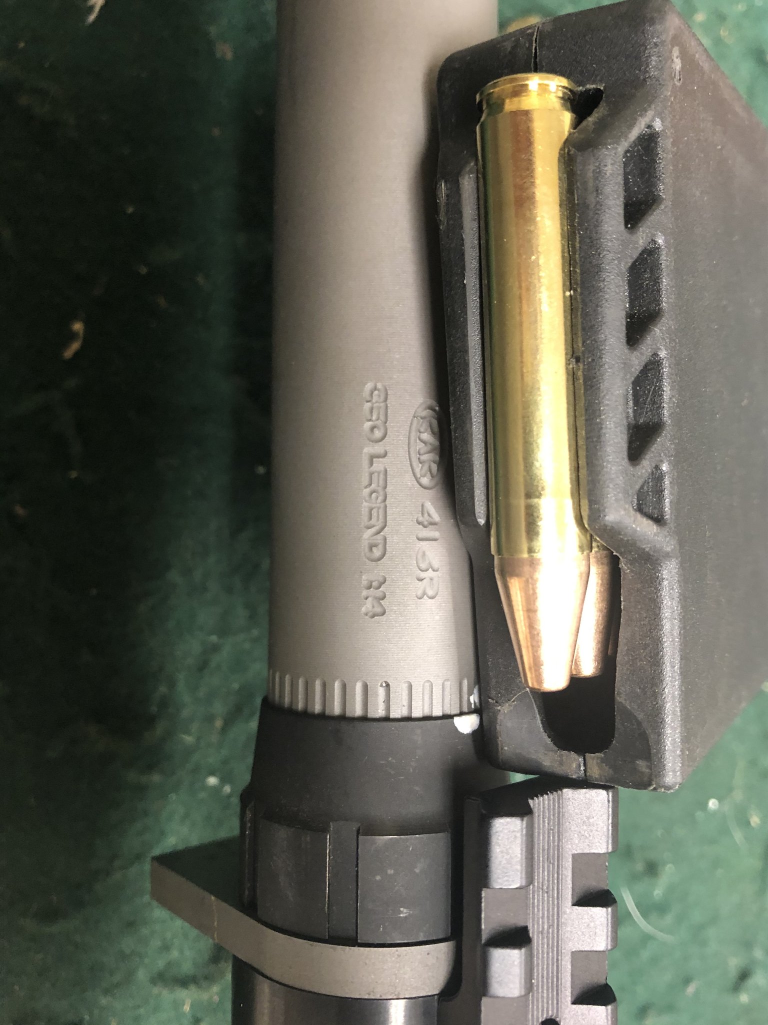

@bigtimber This thread is old but yes a barrel swap and I use old 223 mags I had from a gun long ago. They work good for it so far

Whose barrel and brake is on it?
What kind of accuracy have you been getting with which ammo
edit-the second pic is a diff break that was just a placeholder to keep threads good.

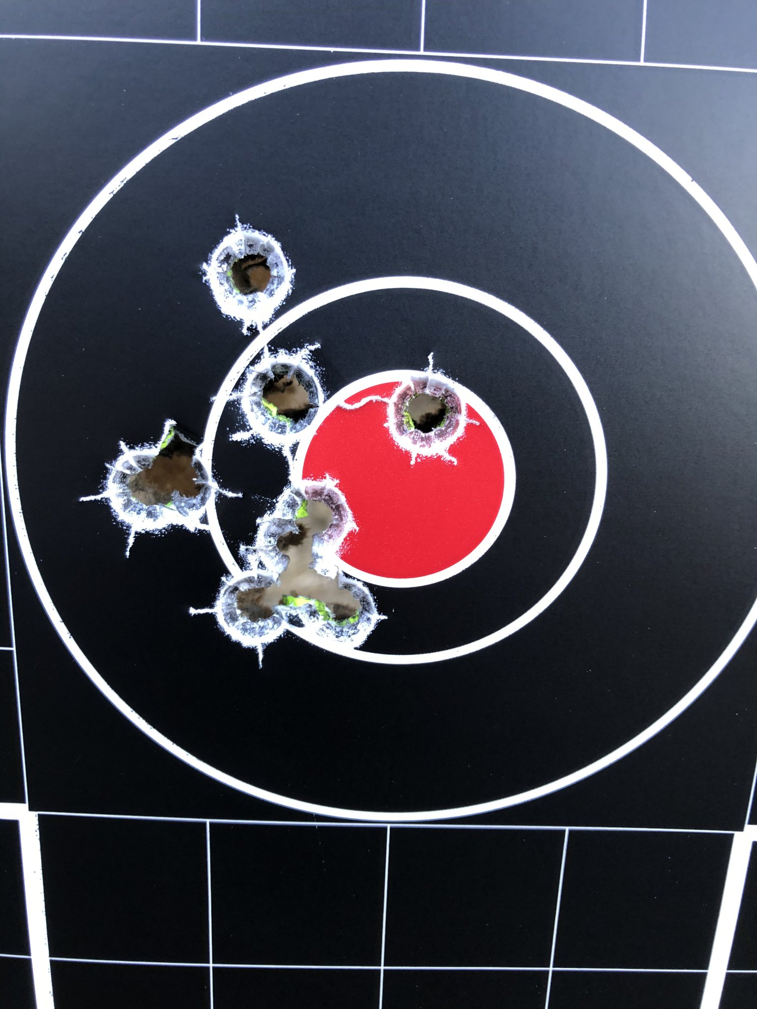

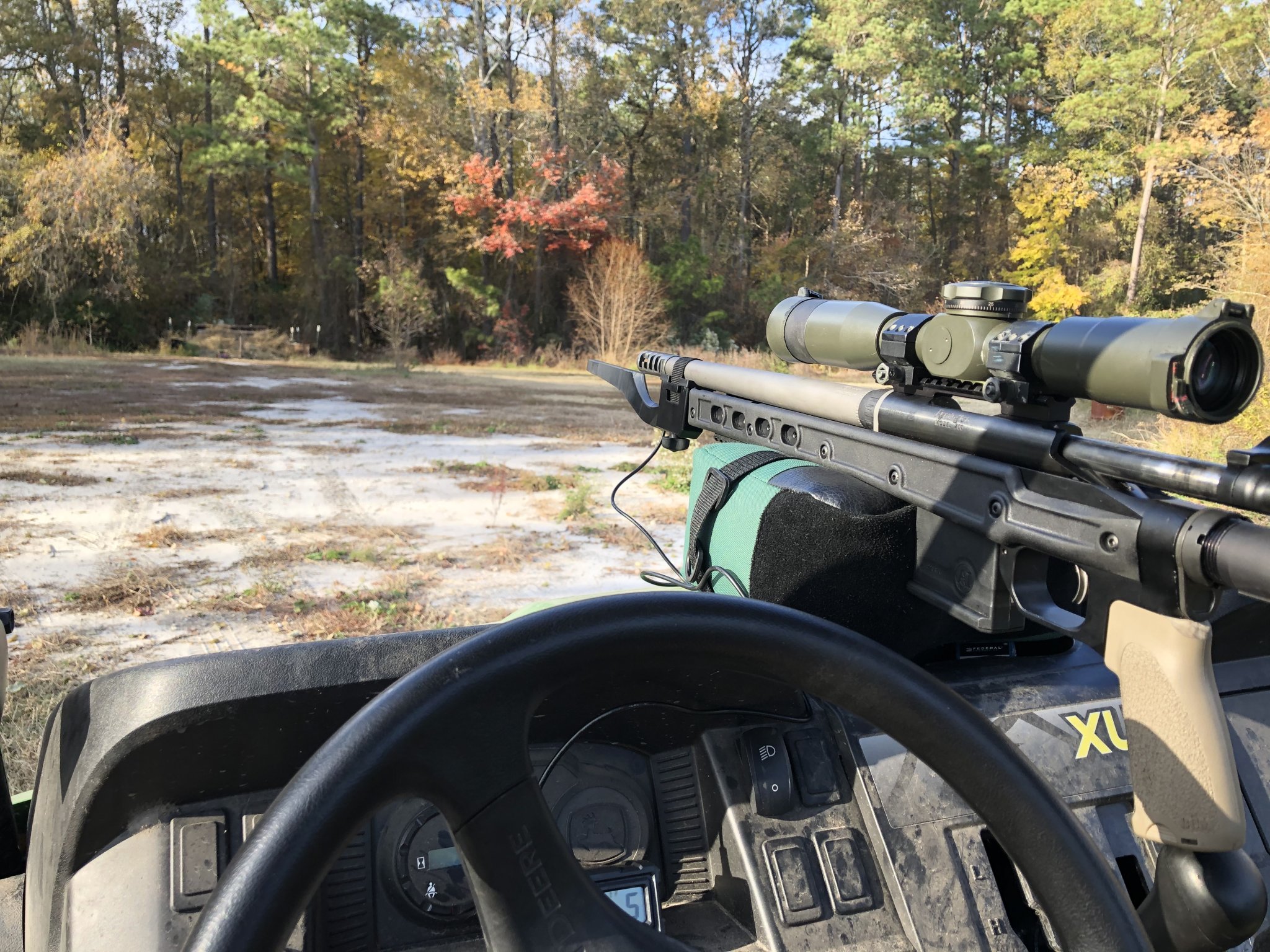

Decent groups but haven’t really gone for accuracy yet. Mostly just plinking off the gator. Maybe when I get back in the mood to play with it again I will try and see what it will do
KAK 16in 1:14 barrel
Rem700 action
EGW base
Vortex rings
ST10 glass
I want to say the break is CDI but I have had it so long I forget honestly

Relatively speaking at that range. my franchi momentum in 350 legend, which is a packaged scope/gun combo for $499 is grouping at .87MOA even with hunting rounds.
