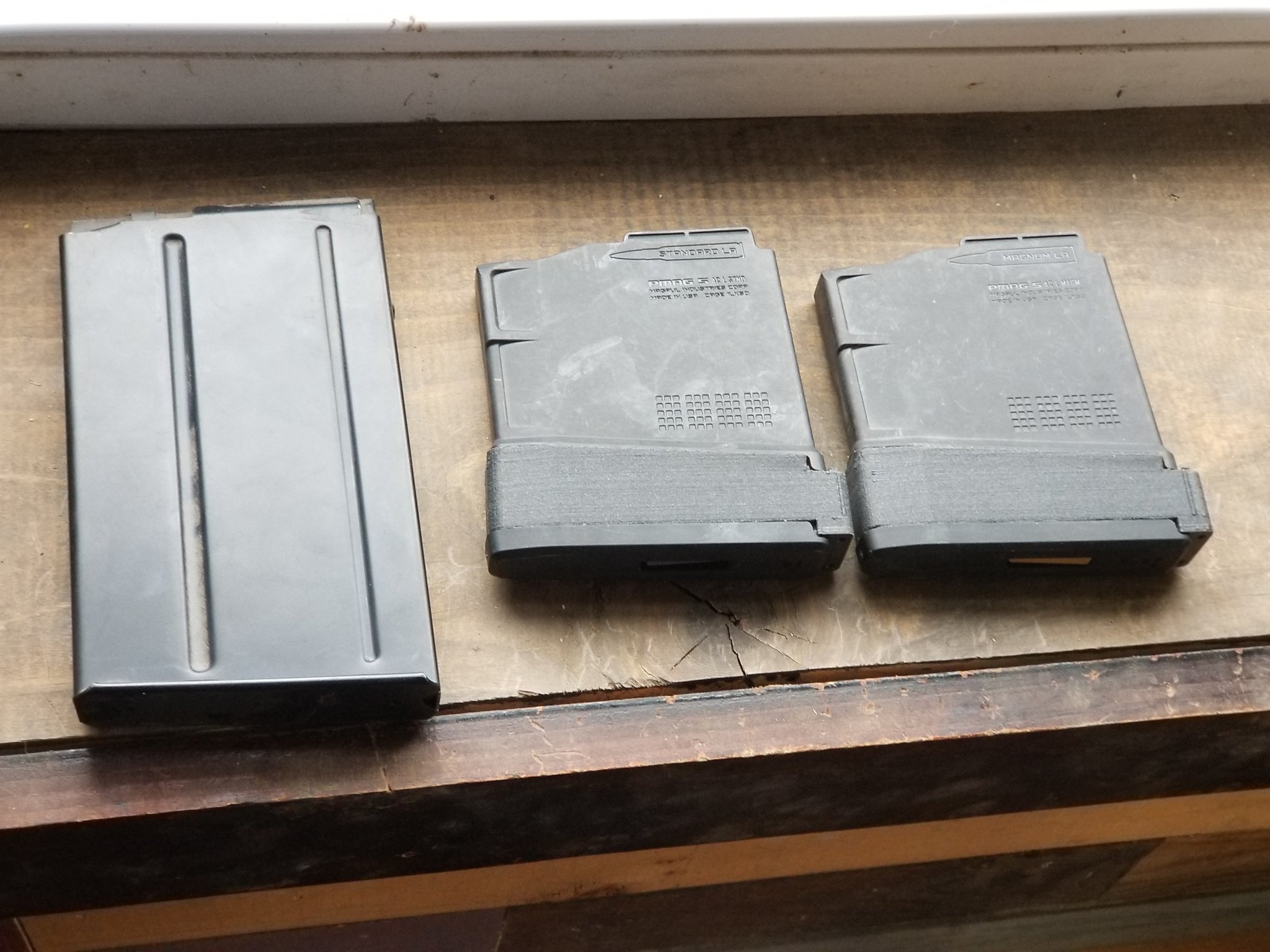

    While @MDT_Josh has a point about capacity of long action mags vs the time on a stage here are a few solutions to mitigate it if you swim upstream of conventional logic and go long action
    AI 300 win mag 10rds hold 11+ 6.5x55 rounds after tweaking lips, standard la p mags + Tyler's extensions get you to 8 rounds a lot cheaper...
