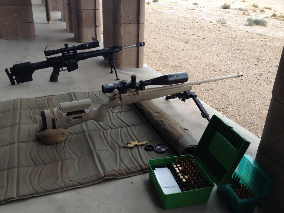

    Finally received my 6.5 CM build from Score High Gunsmiths in Albuquerque. Took about 12 months to receive it but well worth the wait. Sorry about the thumbnail pics and haven't figured how to get them to full size. Double click them for a better view.
    700 SA
    Brux 26" Light 16 Palma 1-8"
    Jewell Trigger
    McMillan A-3
    Badger Bolt Knob
    NF Competition Scope
    NF Light Rings on 2 piece 20 MOA base

    Whats the velocity on that load?
