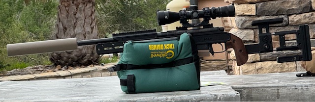

I went with a 16" - 1.2" straight McGowen cut rifled 1-6.5" twist barrel that I should have back in about 8 weeks or so. Picked up a very nice used KRG whiskey 3 chassis with the following KRG accessories: heavy flat bag rider, spigot mount, for end T-Slot weight. I'm topping this off with a Meopta Meostar R2 2.5-15x56 scope that I picked up NITB for a crazy good price from a guy on another forum. Forster dies, Starline brass and Sierra bullets are on their way as well.
