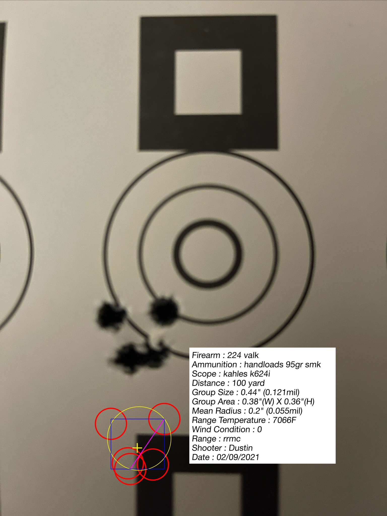

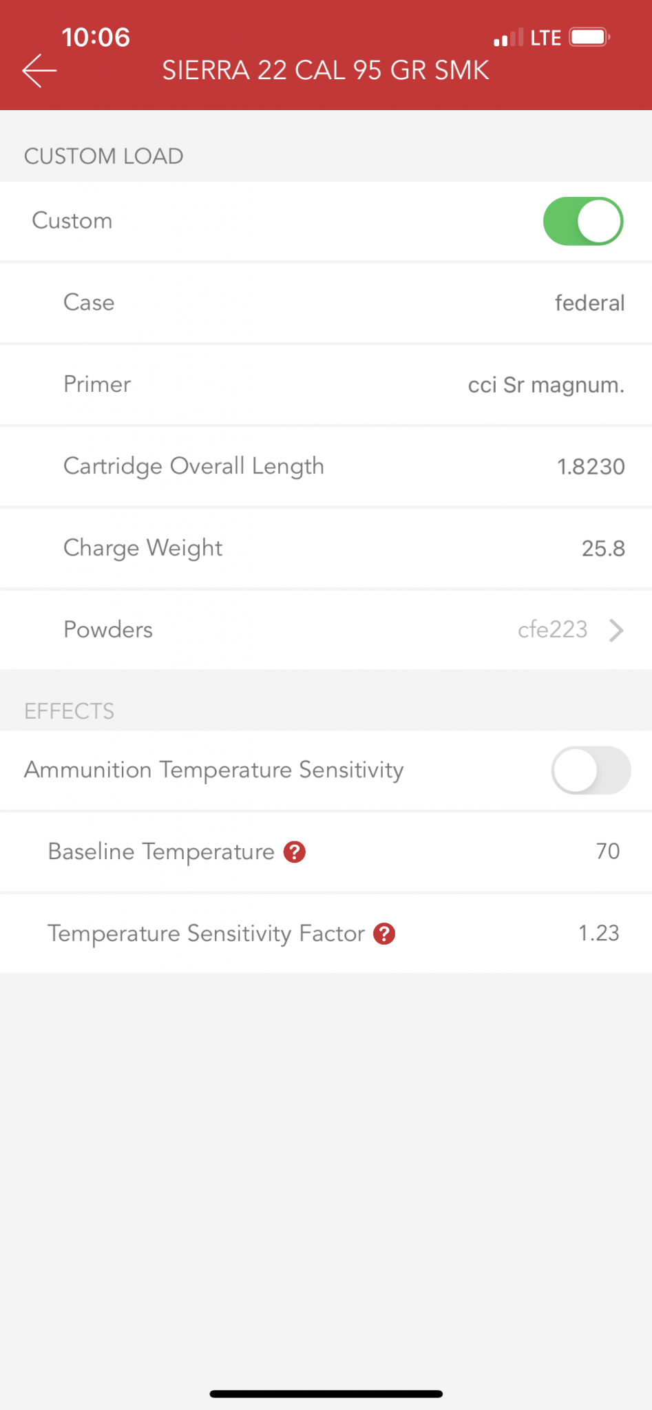

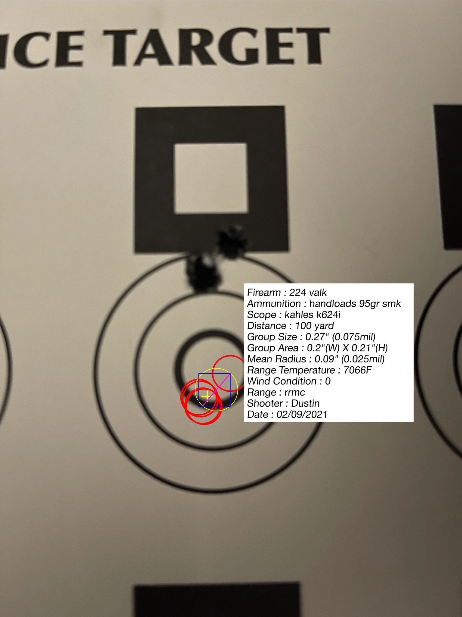

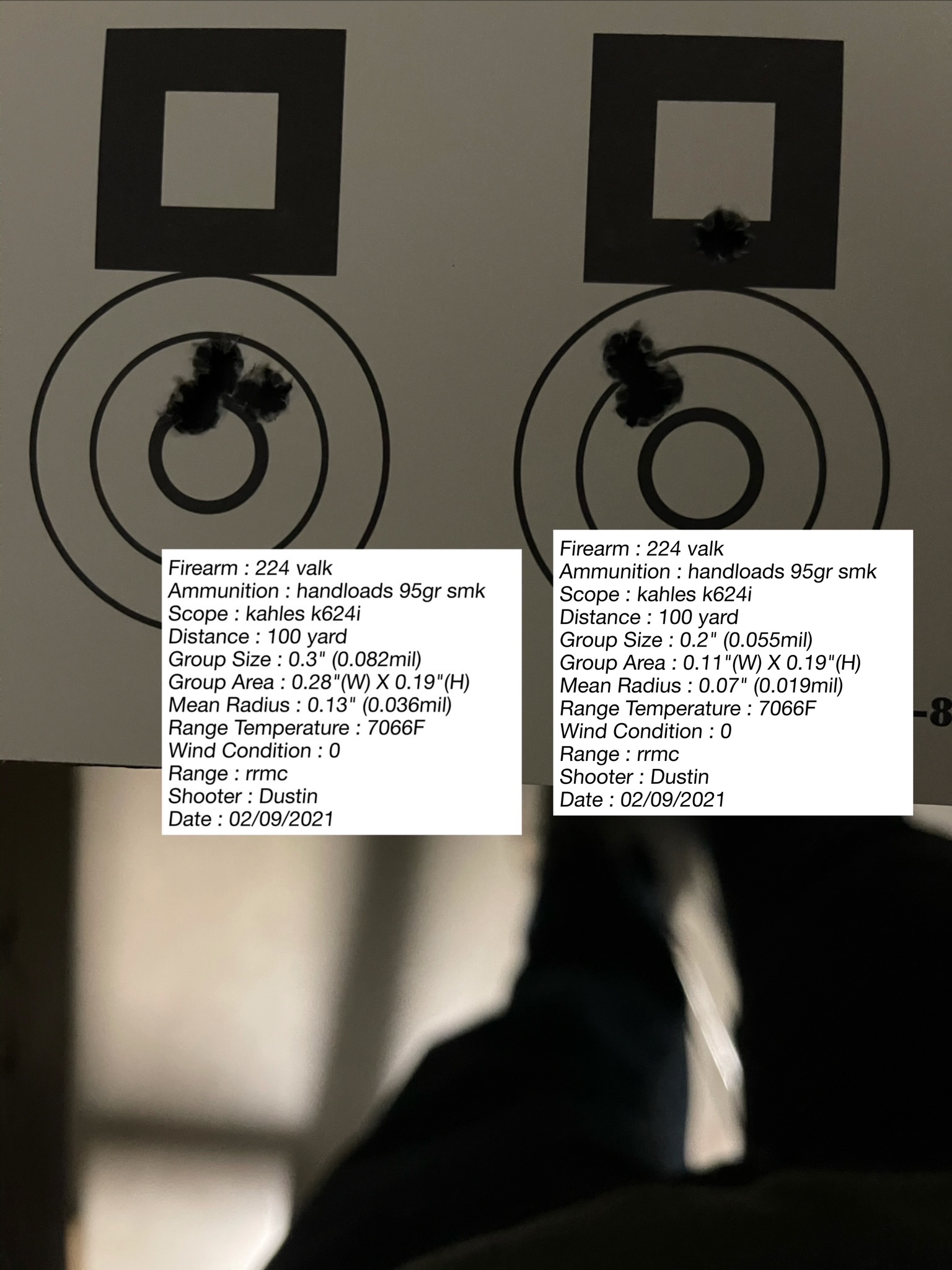

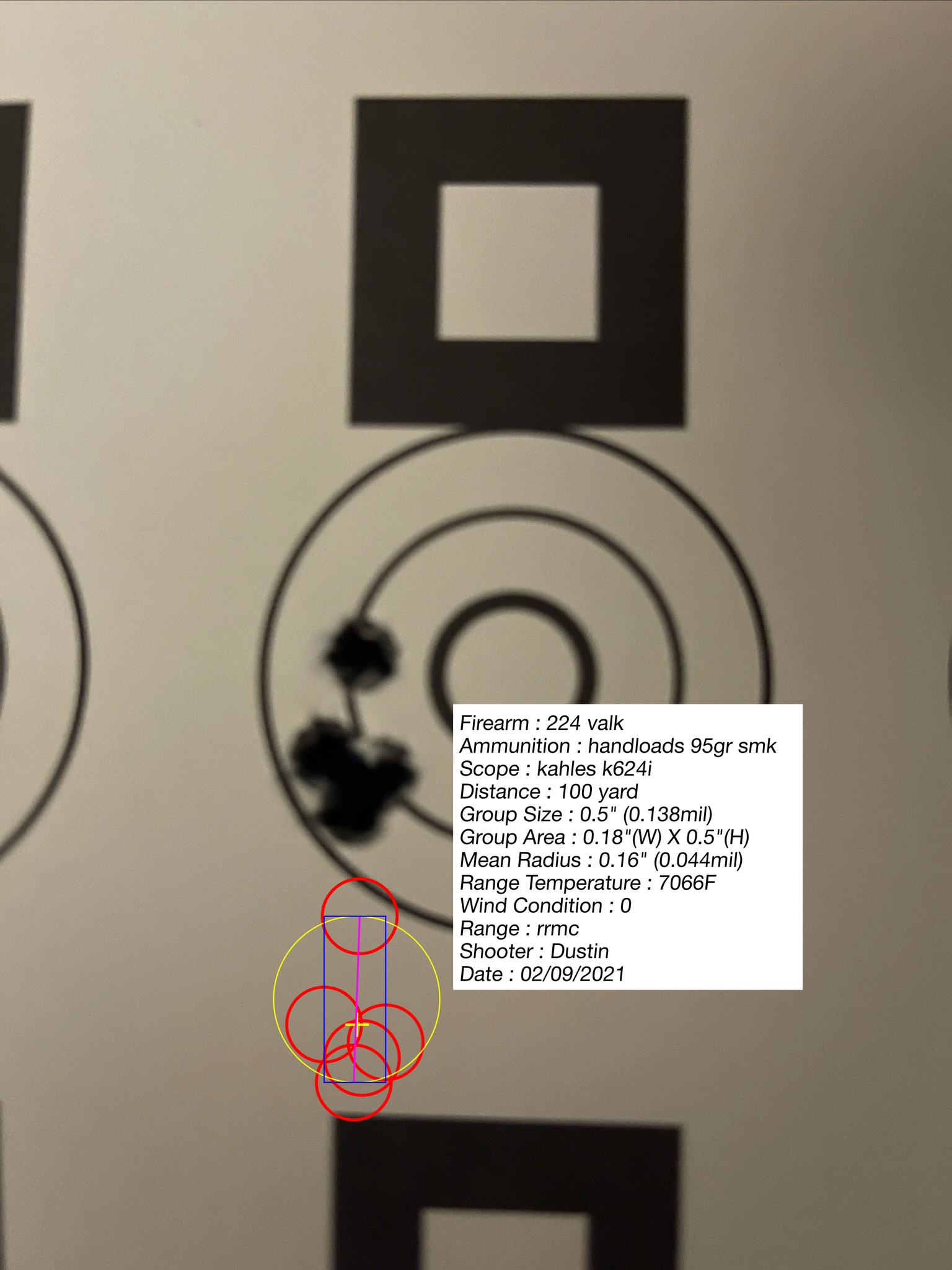

I’ve run them in my Valkyrie and my 223. The Valkyrie is a 22” Shilen barrel 1-6.5 twist gaser. Pushing them around 2370 and getting sub MOA groups, down around .700 if I do my part. The 223 is bolt gun with a Proof 23” 1-7 twist. I’m still playing with the load but everything so far has been close to 1 MOA or better. Had one 4 shot group that was nice then the fifth one was a flyer, still a nice group but would have been nice to have one ragged hole. These are running a little over 2400 FPS. So far I’ve been pretty happy with them. When the weather get warmer I’ll take them out to around 800yds and see how the work.

Your 223 is spitting them out faster than the Valkyrie?
Yes, for now it is. With that powder (CFE223), the higher velocities didn’t get me any better accuracy. I’ll be trying some different powders later once availability is better. Now the 69gr SMK’s are another story. Those like to run a little over 3000fps with the CFE223. I sure miss the days when you could do load work by going to the gun shop and buying 5 or 6 different 1lb canisters of powder to play with.
Isn't the increase in BC negated by the lower velocity? Driving 75's ~200 fps faster yields very similar windage. I could see 95's in a bigger case, but then blowing them up becomes the issue. I'd love to try a really long solid in a 22 creed.
