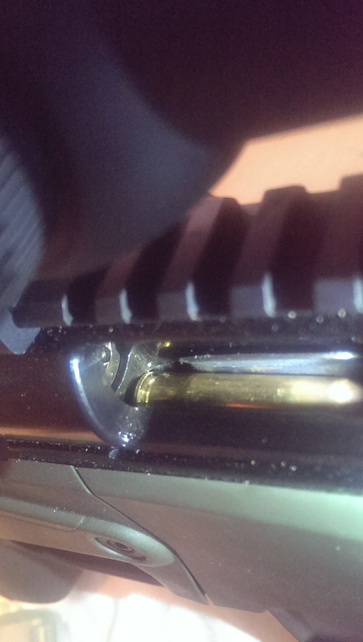

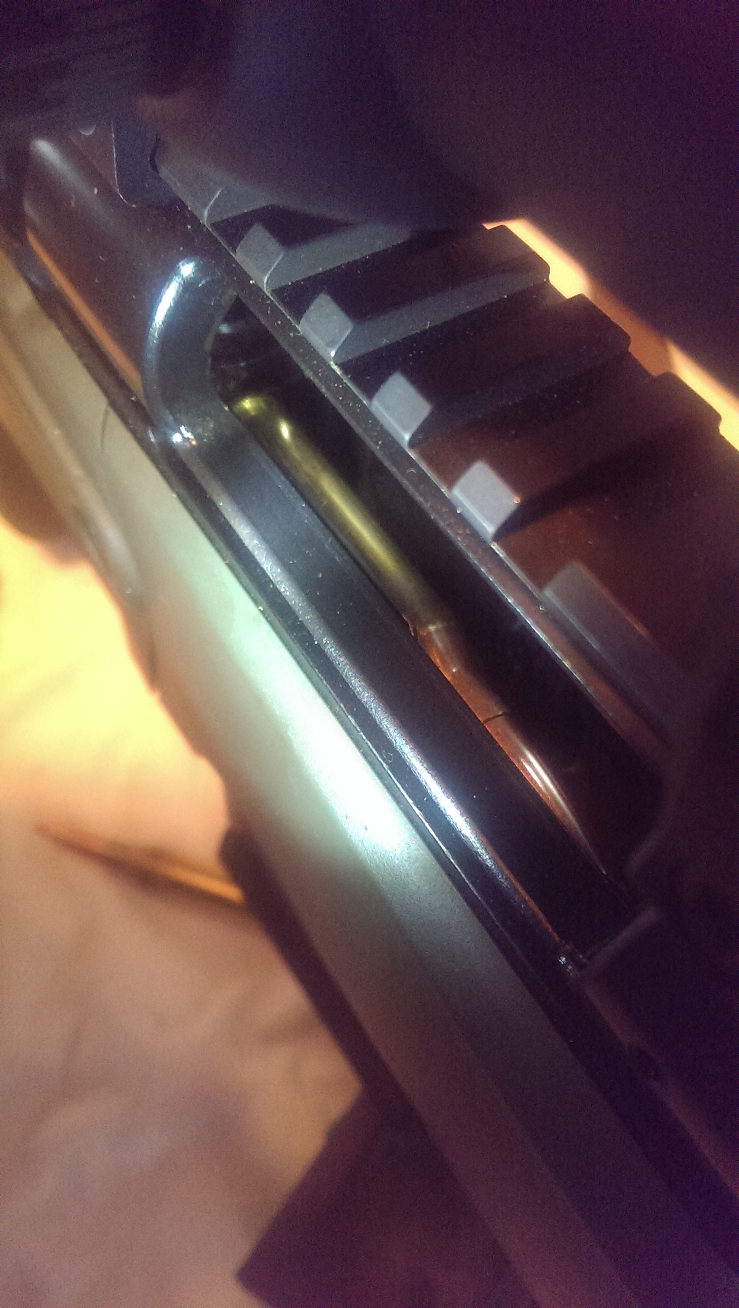

Here is the view from the top looking at the stuck round. Really tough to get in there w the camera. The one of the tip of the amaxs is hard to see but it is actually clear of the top of the mag.

Playing with it, it finally hung up on the other side. Looks like the base of the case is getting hung slightly on the receiver. Measuring the bullet. They are loaded to 2.880" oal.

That might be your problem. I don't what the max length is, but if all of your mags are doing this, it might be time to roll a few rounds that are shorter and see how they perform.

AE mkiii. It was the stock ai mag that it came with and a couple of others I picked up in a trade. The 2.880 fit in the mag with a little room but were hanging up in the back on the action like in the last pic. I seated 10 down to 2.858 and it fed fine. Will have to shoot some now to see how it likes the little extra jump. Hopefully the same as before bc it really shot great.
