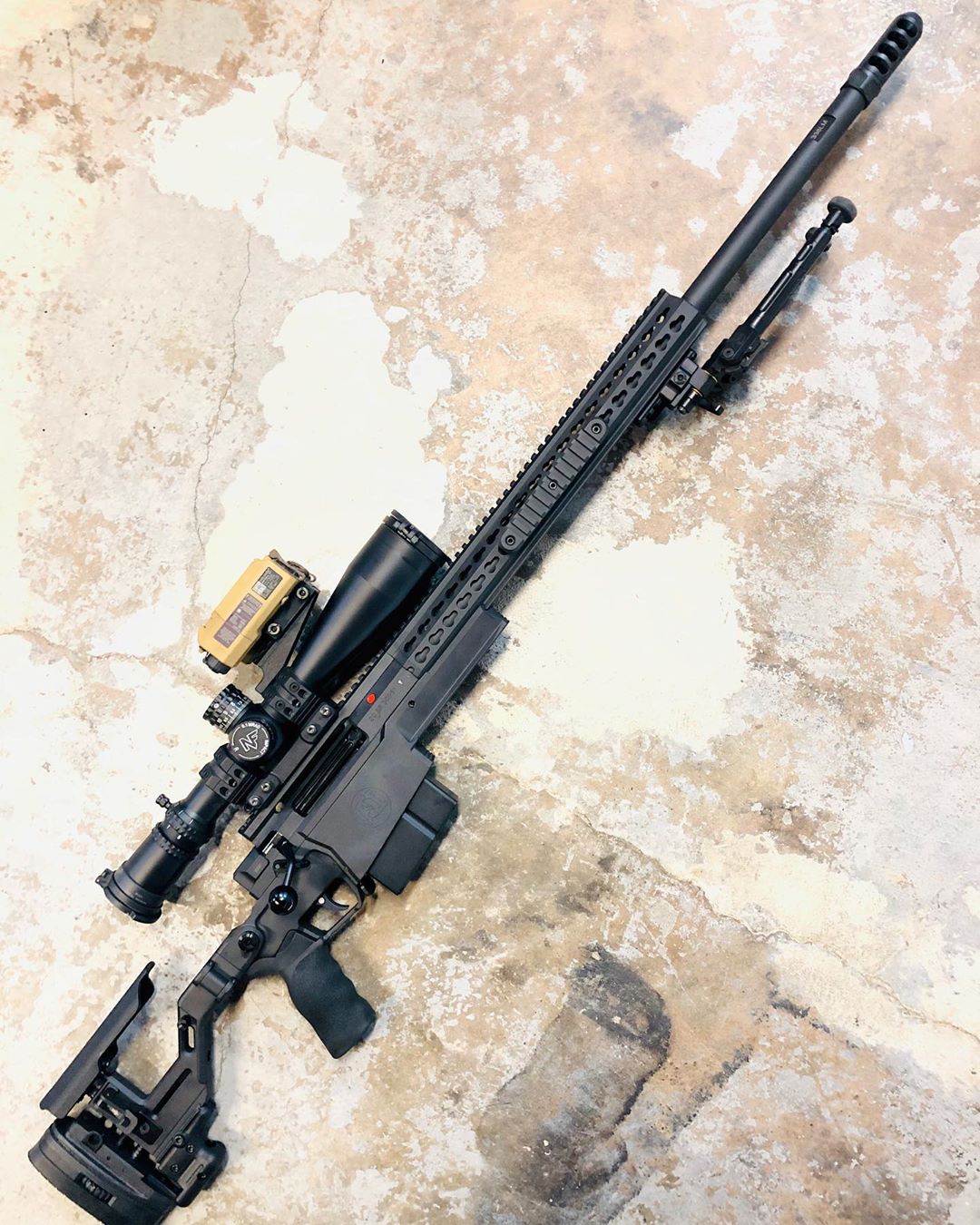

Hi guys!
Looking at doing a new AXSR build in 300WM. I've built up a couple new AXSRs in 338LM for customers and the recoil isn't the most enjoyable. I'm shooting 100-200 rounds a day something too. I have an AXSA is 6.5CM and love it but looking for a little more distance.
What's your though on 300WM as a good happy medium or just shoot 6.5CM and 338 with different barrel kits?

I find that I am not usually happy when I compromise on a 'happy medium', since it will never do either thing particularly well. I run an AXMC, and I went 300 Norma and 308 to get practice and long range without the punishment of 338. My 300WM barrel doesn't get out much...
Reactions: Runnineh
I have an AXMC in 300 Win Mag and have a 26" Bartlein 1/9 twist barrel. Shooting 230 gr Berger Target Hybrids I'm getting 2918 FPS average at 75 degrees temp, 1000 ft elevation, 29.91 inHG and 65% humidity. With brake I can shoot it all day and I'm not recoil tolerant. 200 gr Hornady ELD X at 2929 fps average.
Looks like its approx $5 a round for 300MN. VS $1,10 for 6.5CM and $2 for 300WM.....correct?
this is why I went 300WM. Call it being cheap or whatever, but unless you are an avid reloader it will be very expensive to shoot.
Also, my 300WM build is 19.6lbs fully loaded and suppressed. It shoots like my 6.5CM in terms of recoil.
I shoot a 300 win mag out to 1900 yards along with a 7mm mag. How far are you going to shoot? with alot of shooting in a day i love my heavy 7mm rem mag 197 smk. The 300 win mag is great i suggest getting freebore and the win mag will shine.
Reactions: Chargerguy
i'm leaning towards a 300 PRC for the price point vs the 300 Norma. Also shooting a mile only 2-3 times a year and 1200 yards and less 6 times a year.
I opted to go with the 300WM because I have a proof cf 300PRC barrel on order. I don’t plan on shooting the Norma and thus don’t want the larger bolt face. Just waiting for the FDEs to come in.
@PORTSIDE_GUNNER If you reload, I'd take a heavy look at a 6.5PRC. Or have a shop load you some ammo since Hornady's stuff is iffy as of late.... meaning rounds might not make it to the target LOL.
6.5PRC is a more versatile cartridge. Unless you're regularly going to compete in extended long range matches, but the 6.5 can hold it's own as well.....
Reactions: Surly
@TangoSierra916
Still on the fence with 300PRC or 300 Norma. I'm kinda waiting for the PRC. Issue is I have a 6.5CM AXSA. So thinking I should go for the 300 Norma. Just not fond of $4 a round, because I usually shoot 100 rounds a day when I do.
Federal GM300NMBH1 300NOR 215 Berger - 20rd Box $41 94. Check thru Ammo Seek. This is Classic Firearms - supposedly in stock.
