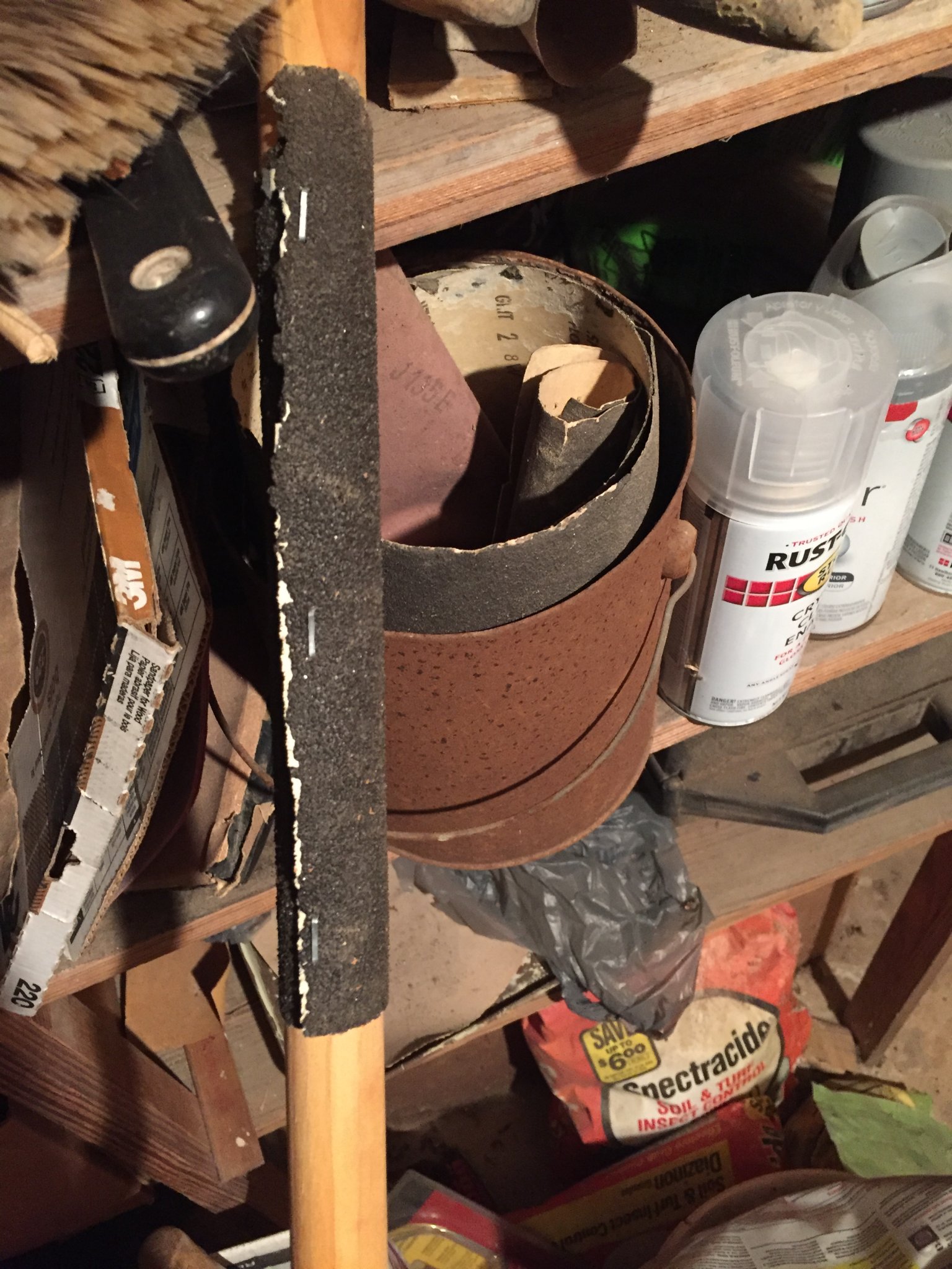

I get a wood dowel, wrap sand paper around it and then sand the barrel channel out as well.
