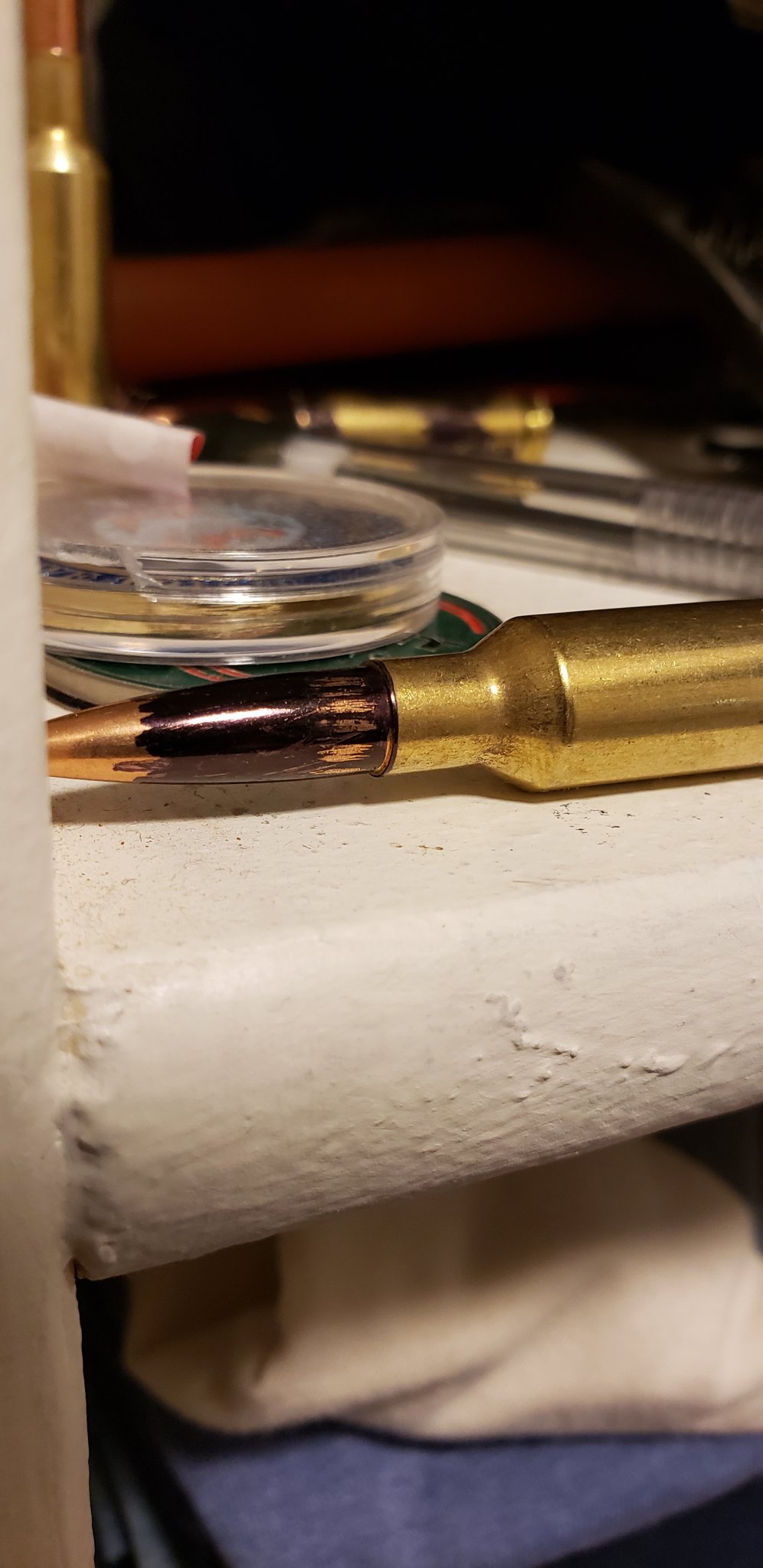

Got a new barrel. Shot fine, until I tried to extract an unfired round. It was jammed! It took me a bit to figure it out. But the bullet is getting jammed and sticking the round.
As you can see the round is rubbing pretty bad. These are factory rounds in a barrel with 2 trips to the range to break it in. I have emailed the barrel manufacture and am waiting for a reply. I'll see if they remedy the situation before I flame them but I will say I don't have faith that they even know what they are doing at this point based on past interactions.

Man, those rub marks don’t even look like lands ans grooves unless you have a 9 or 10 groove barrel on that thing. I can see 4-5 “land” marks on the one side. Plus those are the scratchiest looking lands marks Ive ever seen. I don’t think those are land marks, but who knows these days.
Looks liked ragged tool chatter to me, but I’m not a machinist. I know enough to be dangerous.
I’ve check a ton of rifles for lands that way and never had anything look close to that.
Reactions: Bucket
Honestly it looks like the “freebore” area is not machined enough. Similar to the above suggested cause. I can see lands and grooves in the freebore area and it is interrupted like the marks in the bullet. I mean the 1 land is machined back to make 2 marks as it was not completely machined to the tolerance for the freebore outer diameter. This seems to be the case for each land for each all the way around making what appears told be 9-10 contact points.

Your freebore dia is too small, probably because of chatter in the throat area. This is probably why your picture looks like a 9 or 10 groove barrel. Chatter is over cutting in one place and undercutting right next to that, creating peaks and valleys, and therefore making your freebore dia too tight. That is difficult to remove...
You will burn it out to the correct dia after a while if you keep shooting it as is
