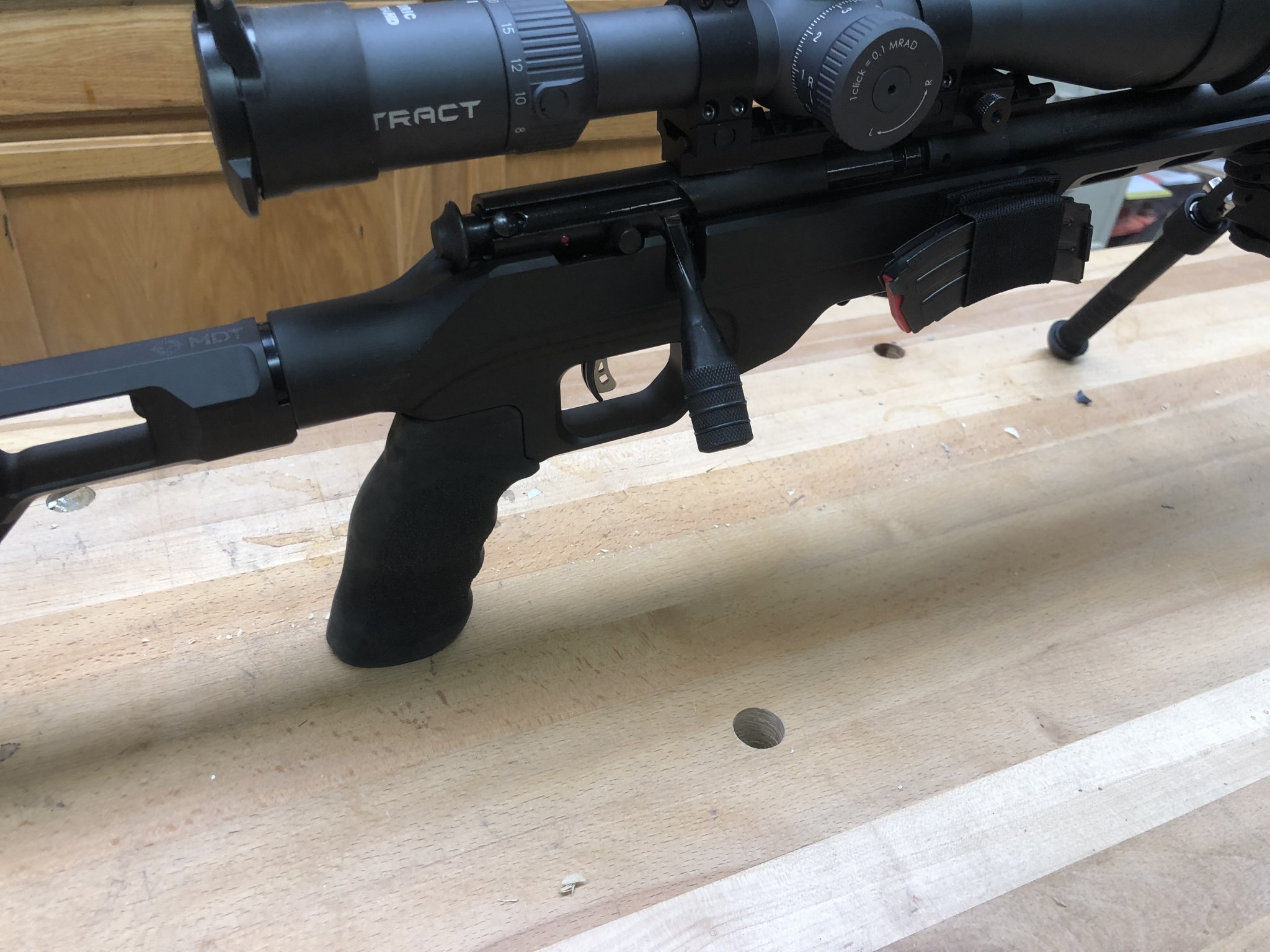

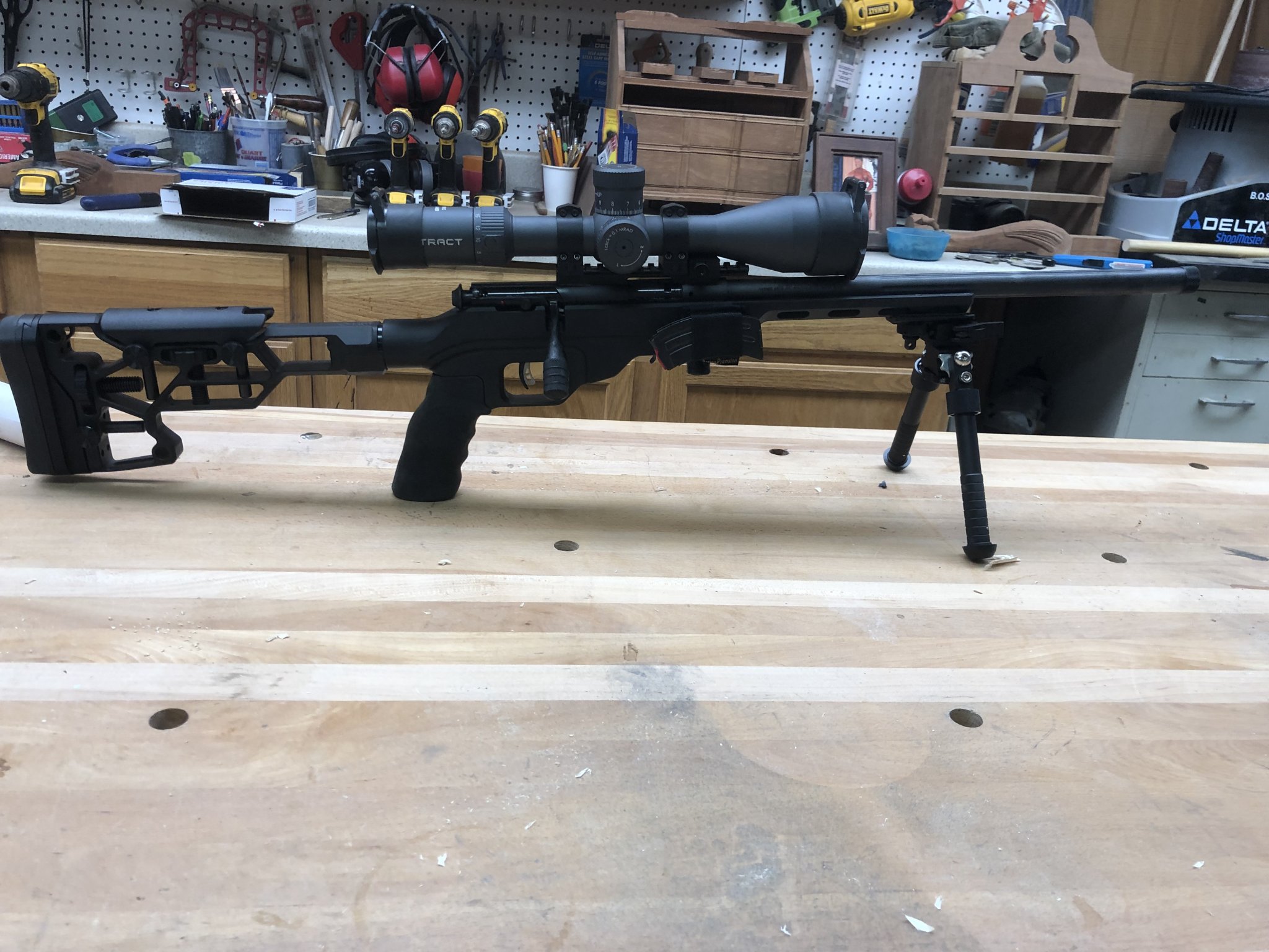

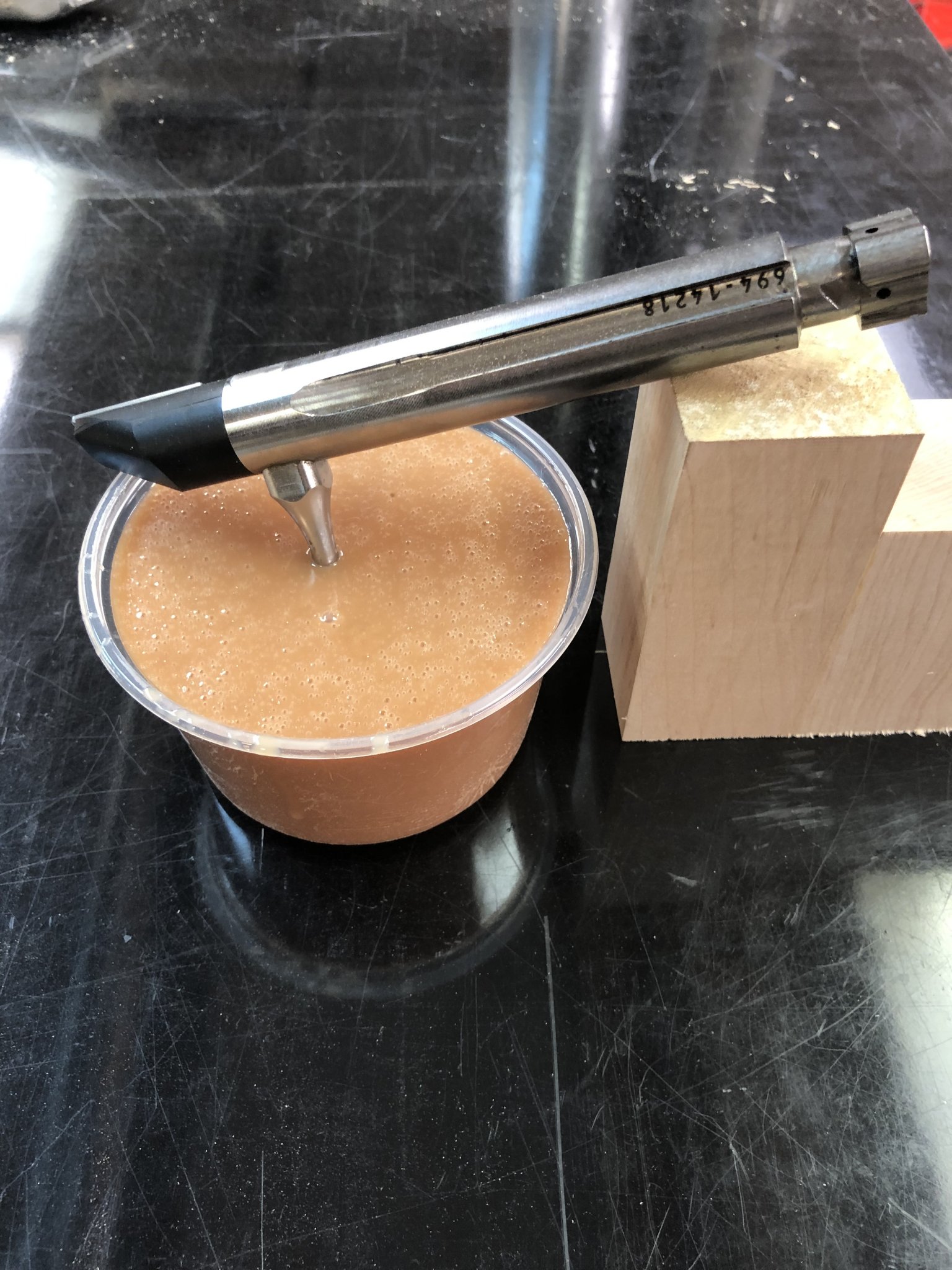

I have a Savage Mkii and I really don’t care for the bolt knob but haven’t had any luck finding a replacement without sending it out and having it threaded. I decided I would take some of my mold making materials and see what I could do. I took a bolt that had a knob that I liked and made a mold of it using a flexible urethane. From there I used an extra bolt handle I had for a Ruger American. I ground down the the ball and centered it in the mold I made then poured a metal filled urethane resin around it. It resin I used is typically used to make tooling so it is some tough stuff. I used a black pigment to color the resin too so I don’t have to worry about the paint getting scratched off. All and all I’m pretty happy with how it turned out. Especially considering I made it with materials laying around the shop.
Here I made a mold of the knob I like.
This is the knob I didn’t care for. I used a metal bandsaw and a grinder to grind it down.
Here is the new knob I cast using resin installed.
I actually didn’t use any tools to make the knob. Just urethane mold and casting materials. I have tons of the stuff in my shop and once the mold is don’t it takes no time at all. I’ll admit that I do have the tools to do about anything and can’t imagine being without them.
