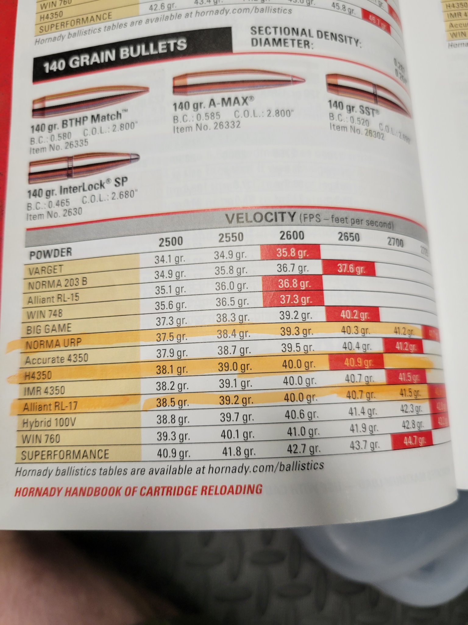

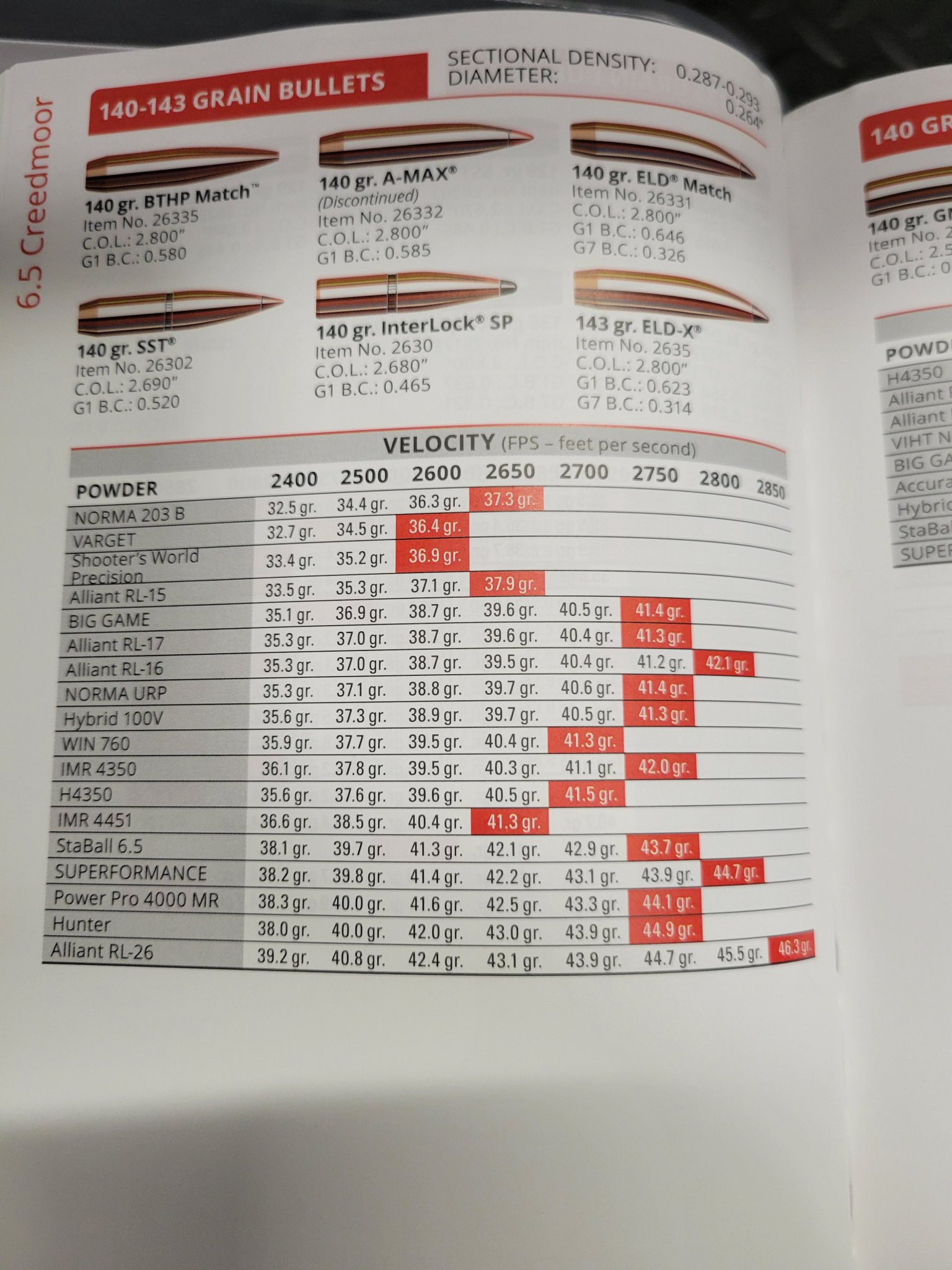

Back when it was printed on the box Hornady brass was a lot lighter and had more case volume. These days, when every brand of brass has less capacity, what you’re about to do is stupid.
Here’s a box here. I use Hornady brass and load 41.5g under a 140g amax/eld all the time without issue. As a general rule this load shoots lights out.

View attachment 8034837Here’s a box here. I use Hornady brass and load 41.5g under a 140g amax/eld all the time without issue. As a general rule this load shoots lights out.
Funny. I remember this as the 41.5 was well over listed max in their 9th edition load manual at the time. Today's 11th edition lists 41.5 as max.
