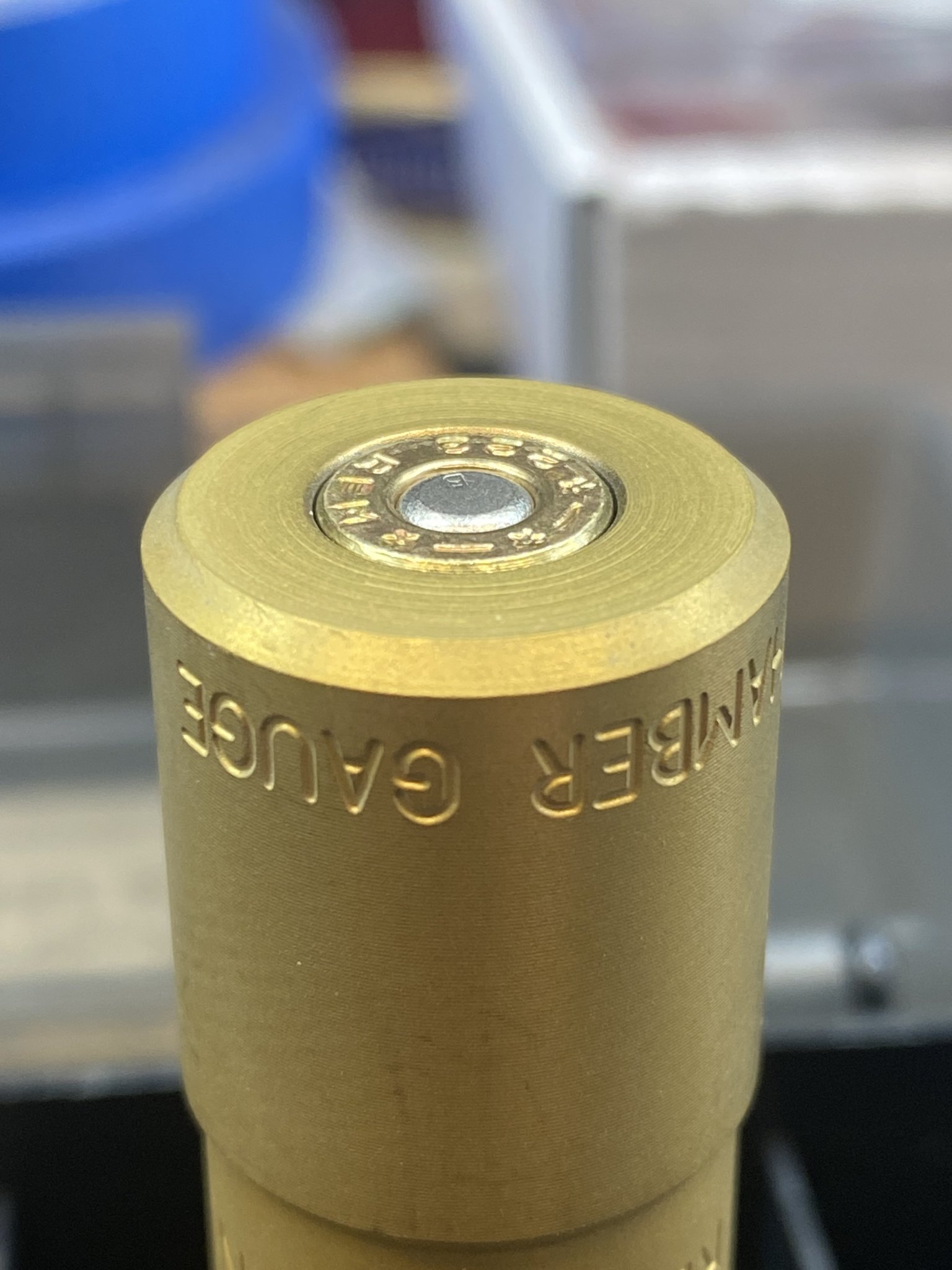

Brand new to reloading. I’m having issues with light primer strikes. I thought it was related to primer seating depth which i’m working on. This round ( the first photo) got stuck and had to be tapped out with a rod. So i tracked down a case gauge and perhaps the new brass isn’t quite to spec. The brass sits down and is not flush.

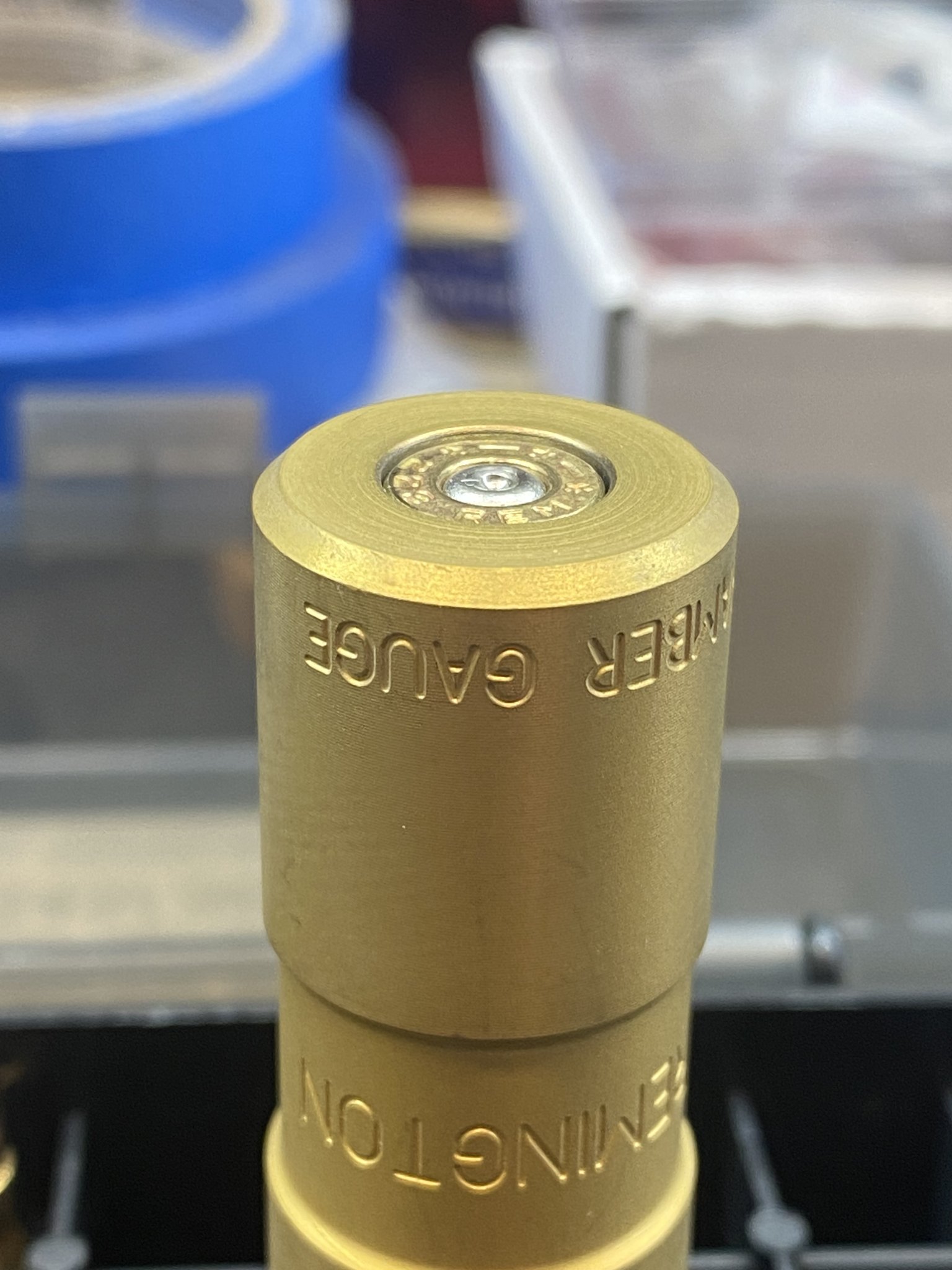

Most of them 90% (second photo) seem fine.

Yup, that case's headspace is too short and will cause light strikes like that. Cases need fire forming. If running these short cases through a sizing die doesn't help, you might simply try using a primers that are thinner (like CCI-400's) where the firing pin might do a better job of igniting the primer. BR-4's are thicker skinned and typically a good choice for your application. But for now and until you get at least one firing on them, I'd use the 400's and maybe even be sure they're seated a little higher (as long as they're not above flush to the bases the the case).

I bought 1000 new same-lot Starline .223 cases several years ago. They do run short. A buddy of mine experienced the same thing with his Starline .223 brass.
I second the previous suggestion to fireform cases using CCI 400 primers instead of your BR-4 (or CCI 450 magnum) primers. I'd do this before fiddling with reduced charges. You may encounter carbon smeared all down the sides of your reduced-charge cases because there's not enough pressure to expand the case tightly against the chamber wall.... and then the question begs, did you really even fireform the case?
