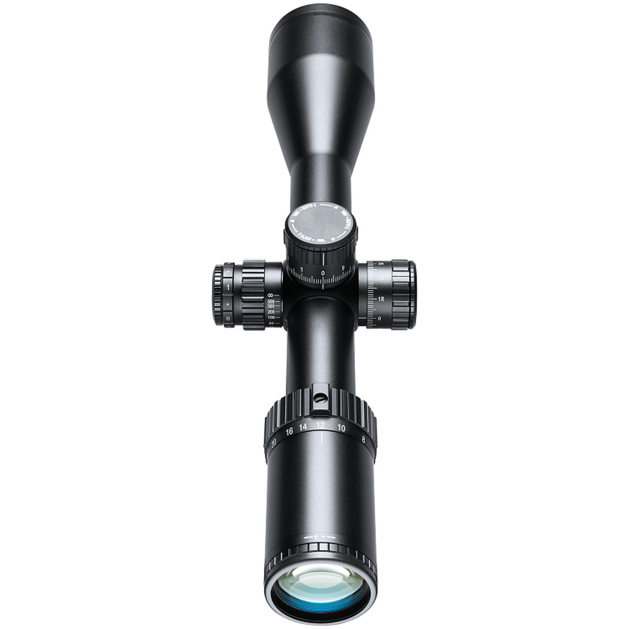

Bushnell just announced a new budget-friendly riflescope for match use - both PRS/NRL and NRL22, but it'll also be a good option for new LR shooters on a budget. I've been involved in testing of the scope, and I have been pretty happy with it for the price point. Mine will be riding on my NRL22 rifle for the forseeable future.
Here's the full specs:
6-24x50mm
30MM main tube
First focal plane with Deploy MIL reticle
6 setting illumination for the first 2 mils from center, and OFF setting between each power level
10MIL locking turrets with splined caps (no set screws)
Tool-free zero reset
18MIL total elevation range
10 yard parallax
IPX7 waterproof, EXO barrier, and fully multi-coated optics
So far, tracking has been solid, but I haven't had time to run a full tall target tracking test on it yet. That will probably not happen until after the PRS finale. Glass quality is on par with the Forge line, so pretty respectable for the price. The turrets are actually really good for a budget rifle scope - the detents feel just right, not overly heavy or sticky. Parallax on my test model has been spot on for the markings, too.
The scope is going to be exclusively sold through Bushnell.com, and comes in much simpler packaging than the other Bushnell product lines as a way to reduce cost to the customer. Price is $499.99 with free shipping, and orders are live now. The scopes are expected to ship out next week.

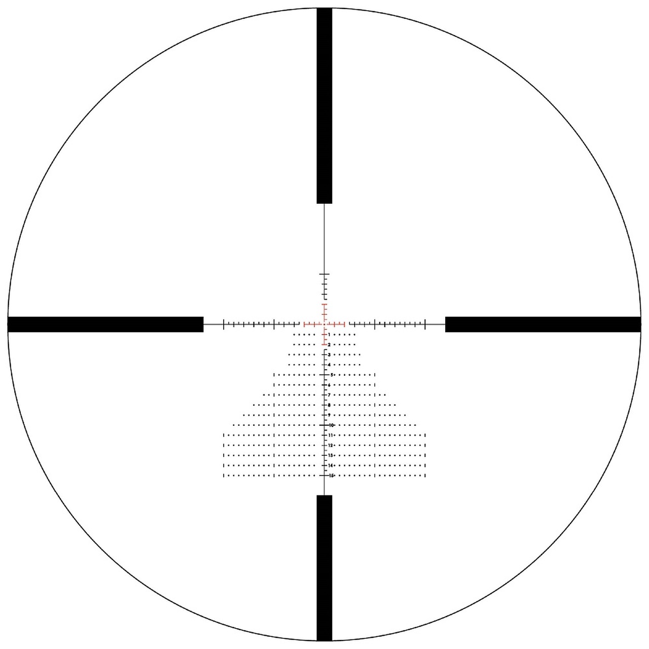

Dumb question, but since the turrets are splined on and not retained by screws, do you just pull them straight off the scope when you want to set your zero? Is there some sort of friction fit or seal to make sure they don't move too much?
There's a top screw that you remove with just your fingers that holds the labaled cap to the adjustment mechanism. All you have to do it unscrew that cap, remove and reset the turret, then reinstall the threaded cap. It takes about 15 seconds to reset the zero.

The glass is honestly on par with the Forge line, but the Match Pro has better turrets than the Forge. Personally, I think it's well worth the $499 asking price. I've been really impressed with mine so far.

I know reticle are a personal thing (I go back and forth between a G3 and h59), but whoever put the graduation numbers on the inside of the vertical tree so you can be forced to shoot a holdover with a number superimposed on top of the target should be horsewhipped.
Yep, the .5's and the numbers next to the vertical make this a total fail to me personally!
Can you elaborate on this a little for me? Also, what scope compares to this that doesn’t have what you mentioned?
Check out the reticle and specs of the Athlon Ares BTR 4.5-27x50. The Gen1 version was/is?? on sale for approx $400. Note the reticle is in all .2 mil hashes, like most of the better reticles in the $3000+ current scope offerings. An advantage with .2's is that .1 can easily be distinguished "in" the reticle, for holdovers and holdoffs.
It was originally designed to beat out the Gen1 Vortex PST, which it easily does.
Now the Gen2 Ares is out and has been improved and thankfully has the same awesome reticle.
But reticles are such a personal thing! Cracks me up that some people get freaked out because .2's seem busy???
