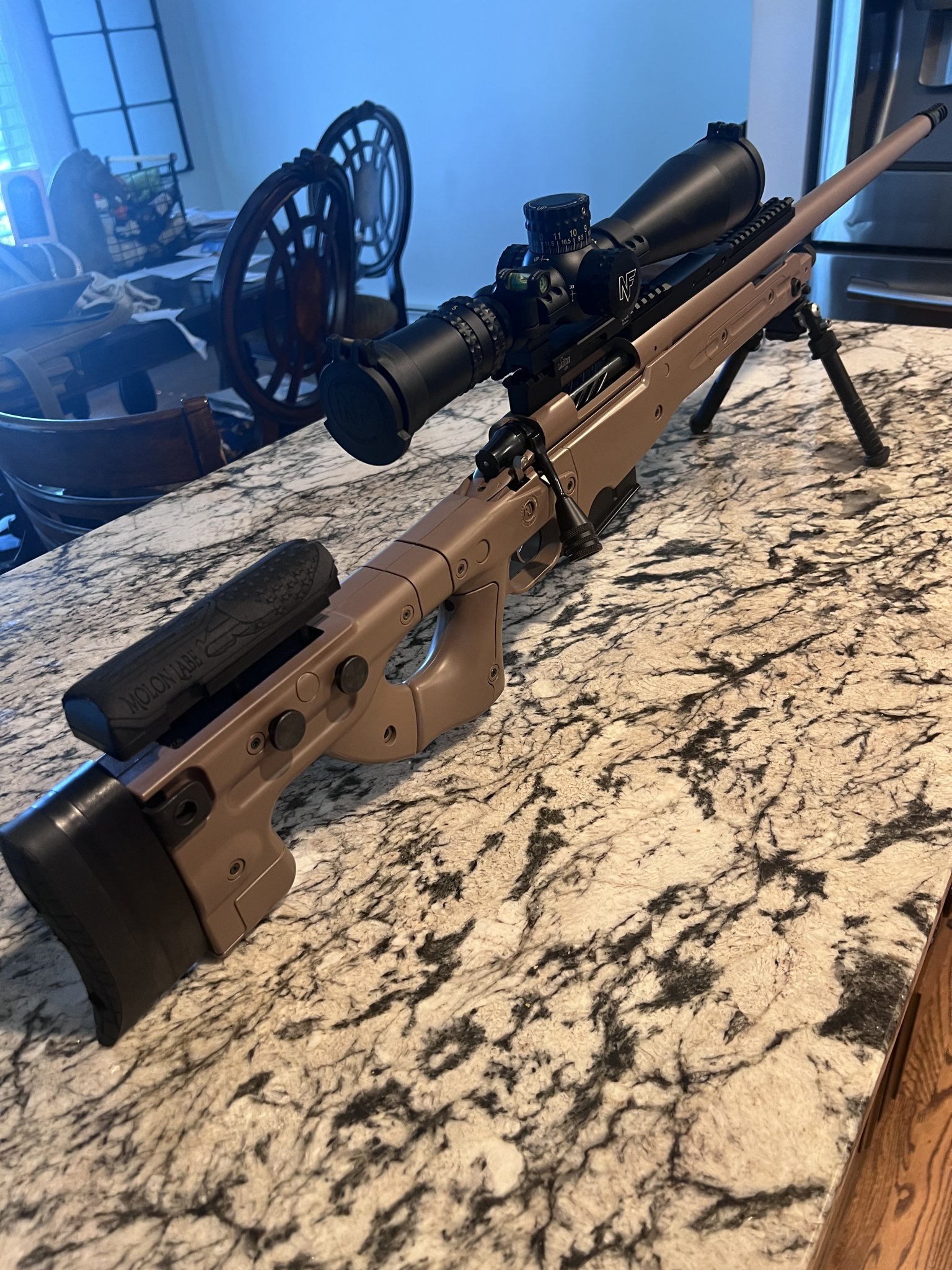

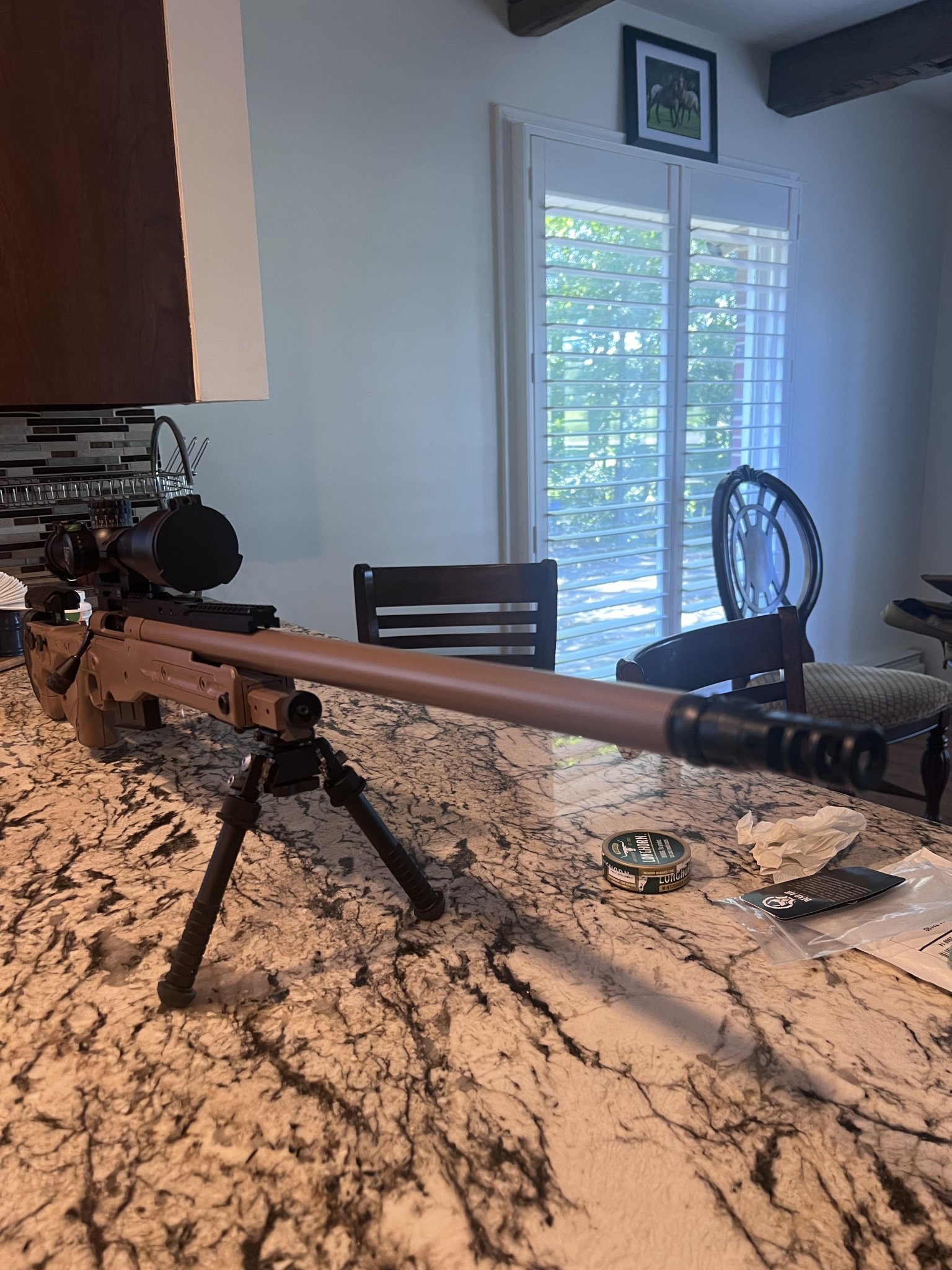

This is my new build just got it done today
Kroger stainless steel barrel
Mac brothers action
AI chassis
Timmy trigger
Night force 5 x 25 x 56 F1

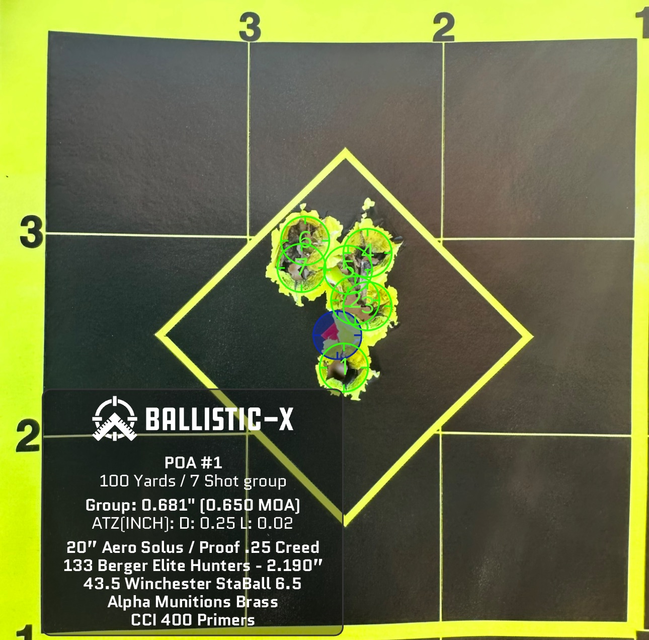

People love to hate and spread internet bullshit rumors, but give a try to the Aero Solus... It's built VERY similar to an Impact 737r for about 1/2 the price when they go on sale (usually all the big holidays). I have 2 and 2 more on order. My current ones wear a Proof CF custom prefit in .25 Creedmoor, and the other wears a custom CarbonSix prefit chambered in 7 SAW.
Solus/Proof .25 Creed is putting in some good work... I'm pleased with the results given that I'm getting around 2,800 FPS MV from a 20" barrel with the Berger 133 Elite Hunters.

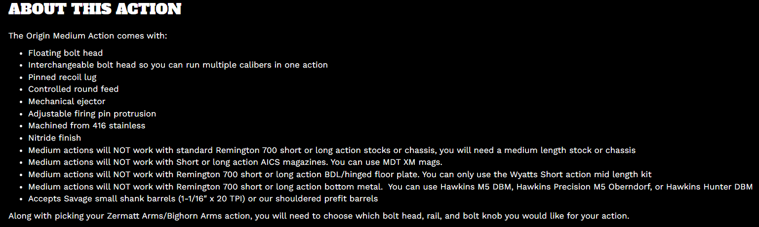

Well this answered quite a few questions about the Medium action choice....... Looks like I may have to stick with a short action and a Wyatt's.
From Northland shooters supply website.
