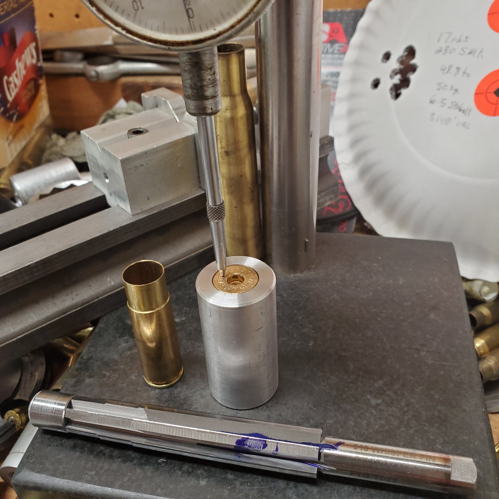

I chamber rifles with usually only a "go gauge" or sometimes no factory gauges at all, but make a gauge with the finish reamer, and a piece of cartridge brass, as a go gauge with a granite surface plate and a drop indicator, to get the exact chamber depth. Then size the cartridges to that gauge, made by the finish chamber reamer. Works great on wildcat, and obsolete cartridge chambering.
Example: one picture is worth a thousand words..
Just finished this chamber gauge : This 510 Whisper brass will be "the chamber gauge," as the finish reamer has been used to make the cartridge gauge will also ream the chamber and be used to size the brass to fit the chamber exactly.
