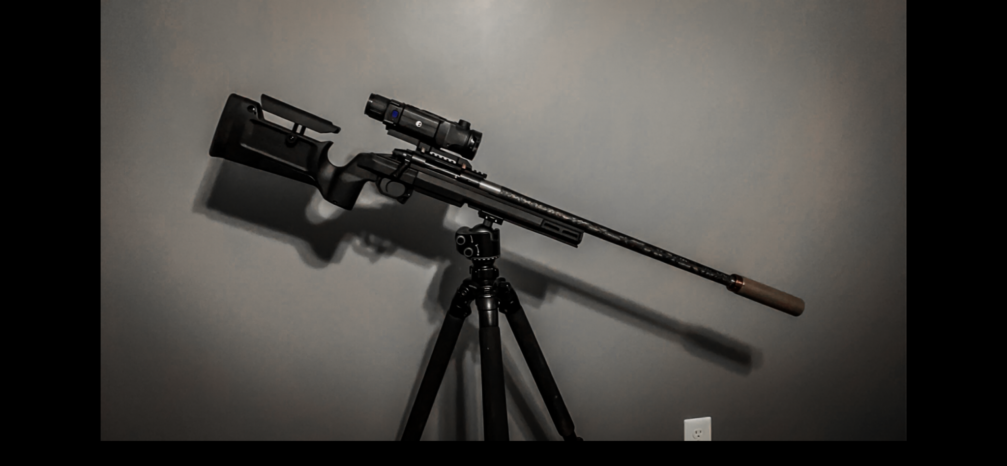

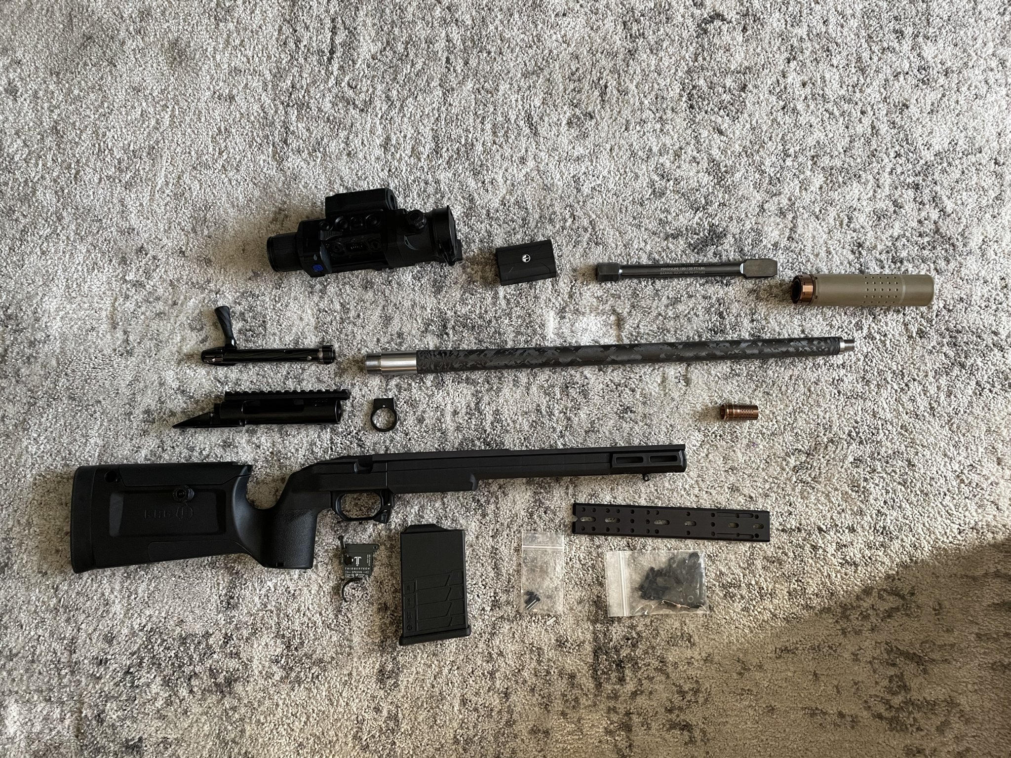

Finally got all my parts in and had my helper in the shop tonight.
Really was pretty simple to slap it all together, less satisfying than I thought it would be lol. Couldn’t find the barrel I wanted in stock and ended up with a carbon proof but oh well. Hoping to blast a few coyotes in the next few weeks with it.
Nice. I also have a small to medium sized game rifle in 6 Creed. On an Origin. I'm pushing 90gr TGKs at 3050fps out of a 22" Proof. I foolishly bought a 22 Creedmoor to push 88ELDMs at 3100. Also a 22" CF barrel. Have you ever put an 88ELDM and a 90gr TGK side by side? LOL, virtually identical....🤦
I don’t reload yet, it’s on the list for later this year.. hopefully. 22 creed would be my #1 choice at this point if I did though, I hunt with a buddy that is pushing at 60 grain vmax around 3700fps sub moa and it decimates coyotes
