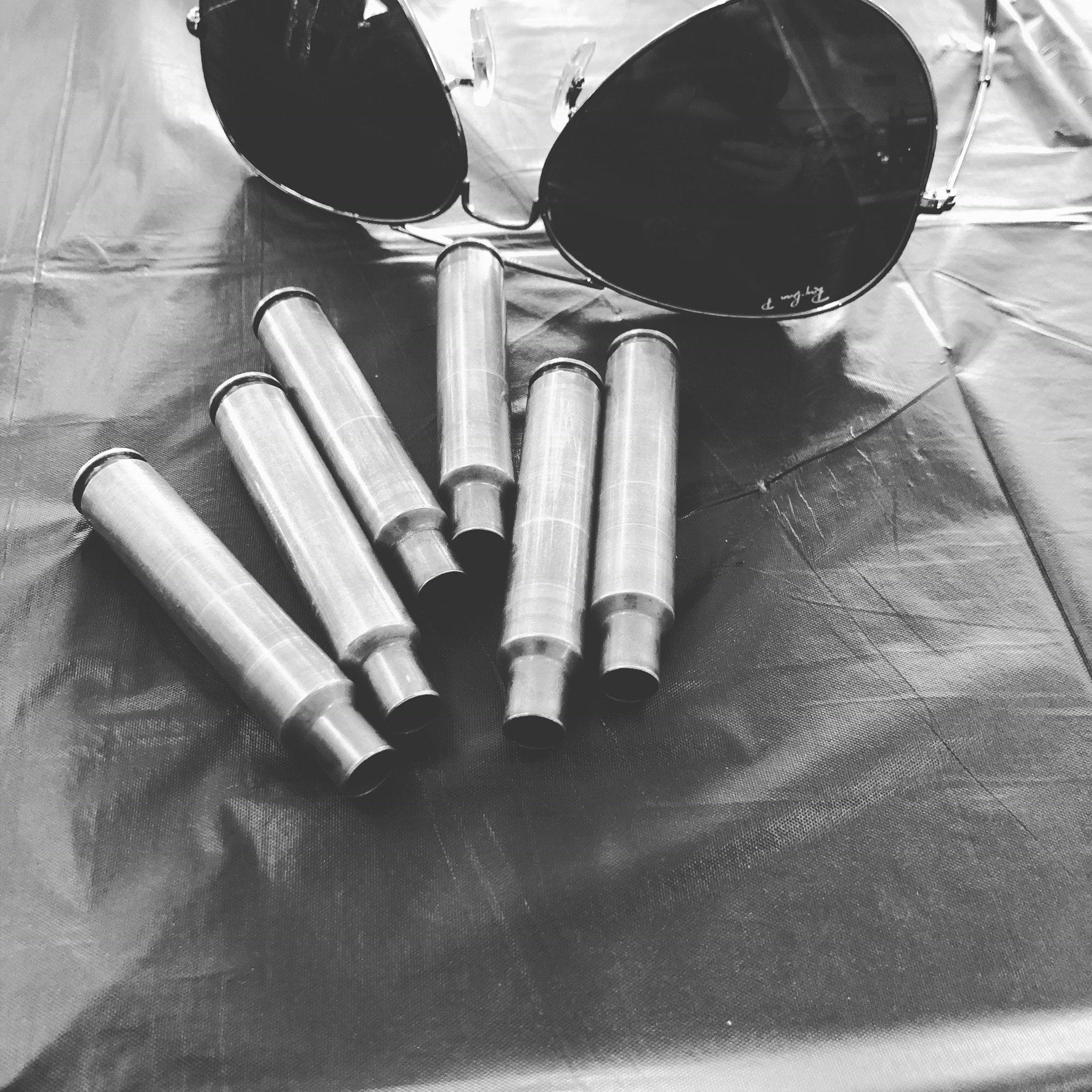

In full disclosure this is a old pic I have had rifles built out of most or traded them to pals. Only two left.

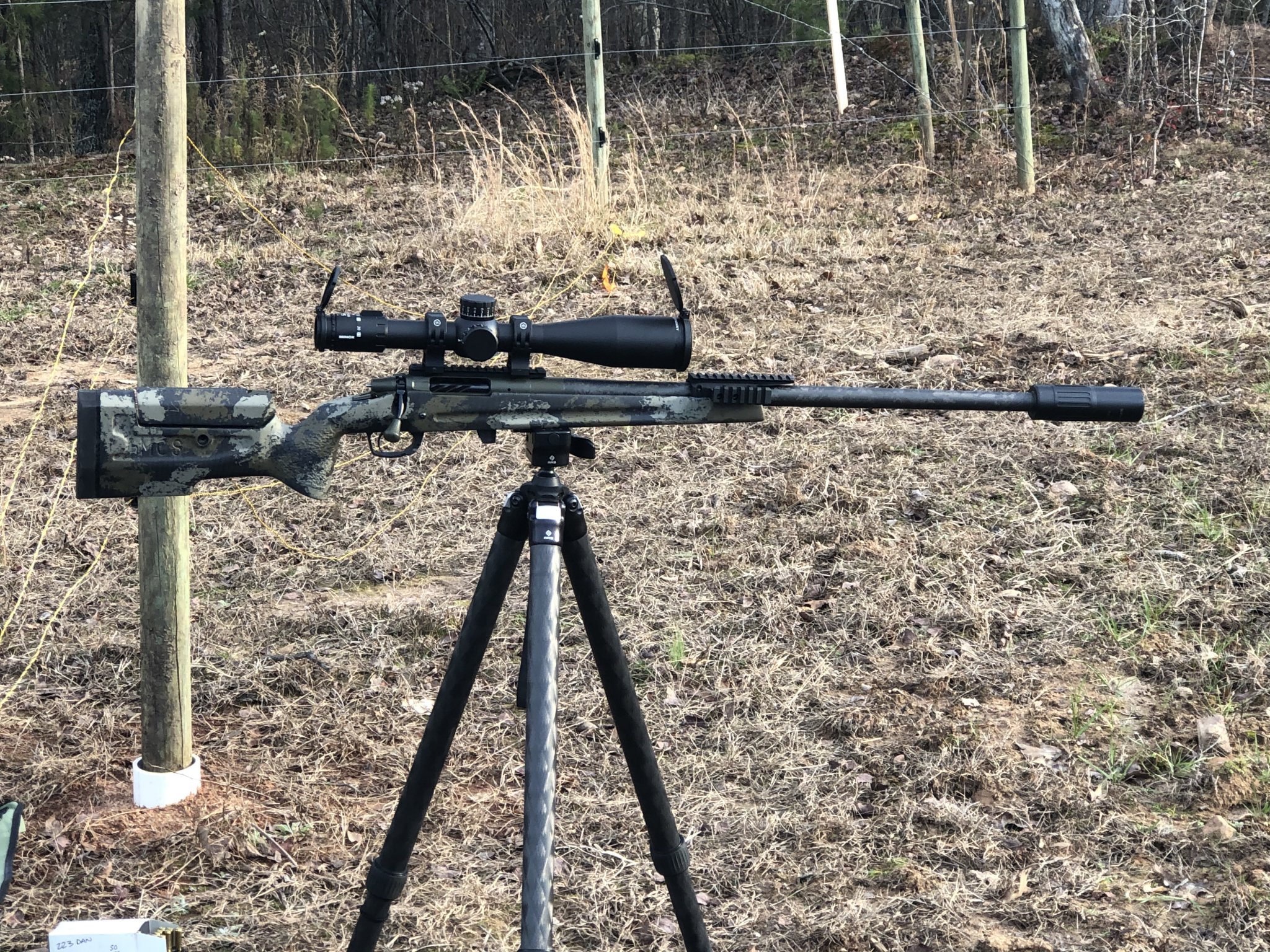

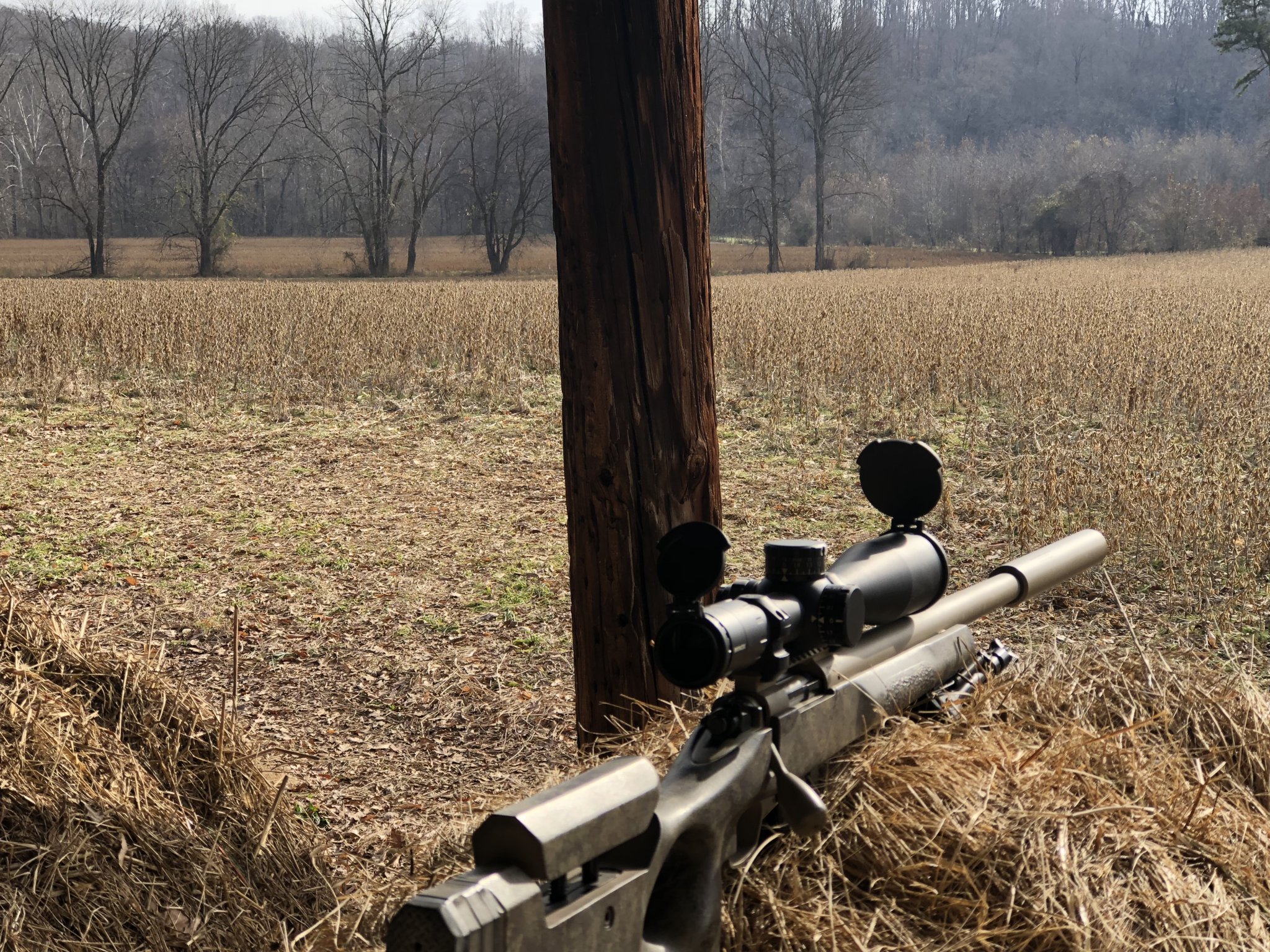

I spun up a Broughton 1-9 twist on an old FN-SPR action I had laying around and got lucky. (Don’t chamber many barrels ) Was pushing 180 Berger’s out at 2975, and then found a load with 162 ELD-Ms at 3100 With RL23 that shot freakishly good so been running that. The throat is getting kinda toasty so gonna send it out for a full go over to LRI and a new tube. And a bit of a weight loss program.
How long is that barrel? Thx
Both are 26inches. The FN barrel is contoured for my OTB style reflex can and it really cuts down on overall length and peace of mind if you drop your rifle on can/barrel and wonder if you bent it and if you’re gonna send half your baffle stack down range next time you pull the trigger. 😁

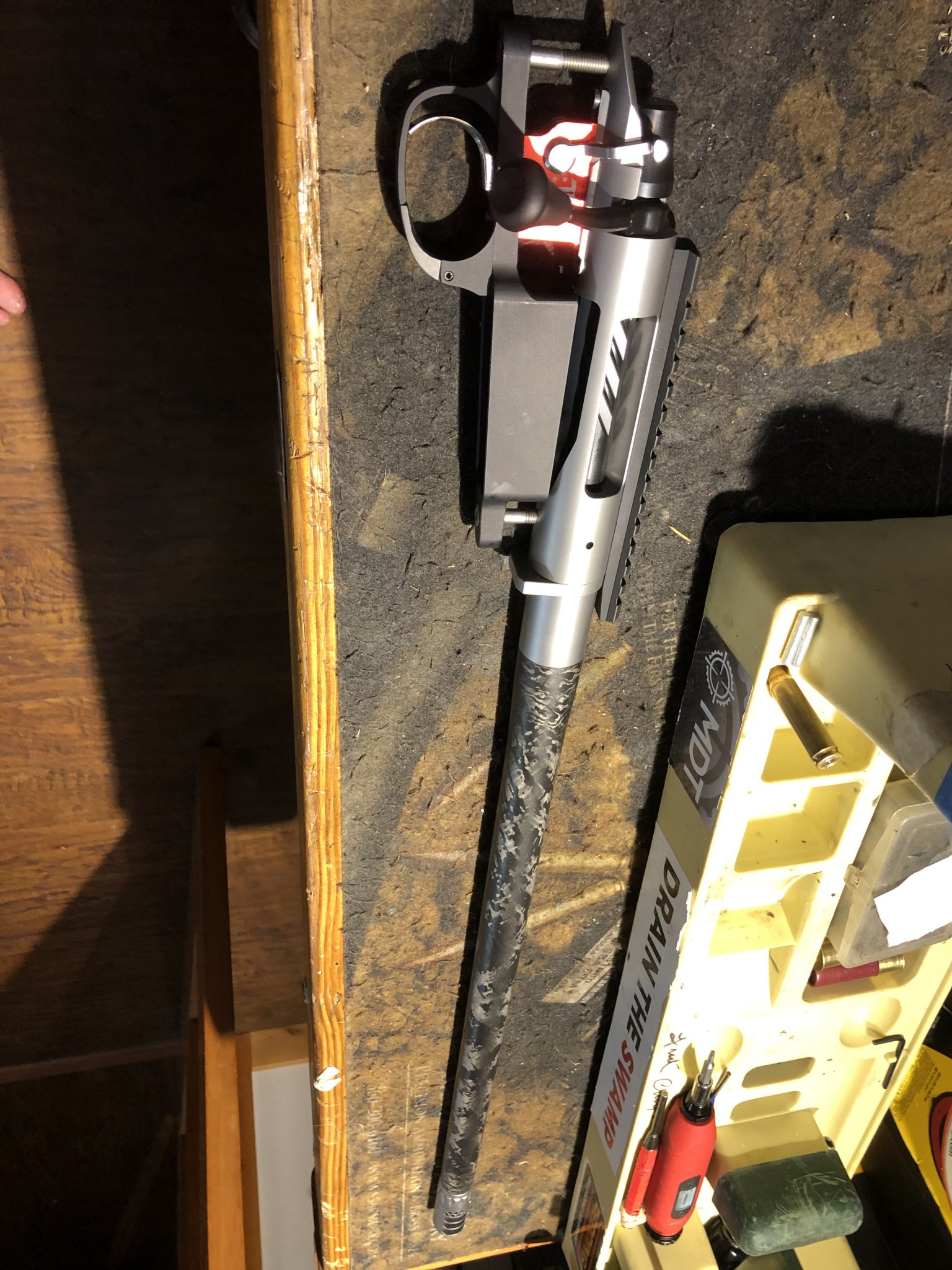

I picked up a CA 280AI with carbon barrel and ended up selling it to my Bro unfired. It wouldn’t shoot for shit, sent it back and they retubed it. It hammers now. We took it outta their stock and popped it into a KRG bravo with a lot of LOP spacers for Magilla Gorilla and worked up a load with the TLR 155s over RL23 and it’ll spit out 3 shots as tight as any of out comp gun builds. If I didn’t already have so much in 7WSM brass and rifles, it Would be hard not to build a few 280AIs. It’s a sweet round for hunting.
