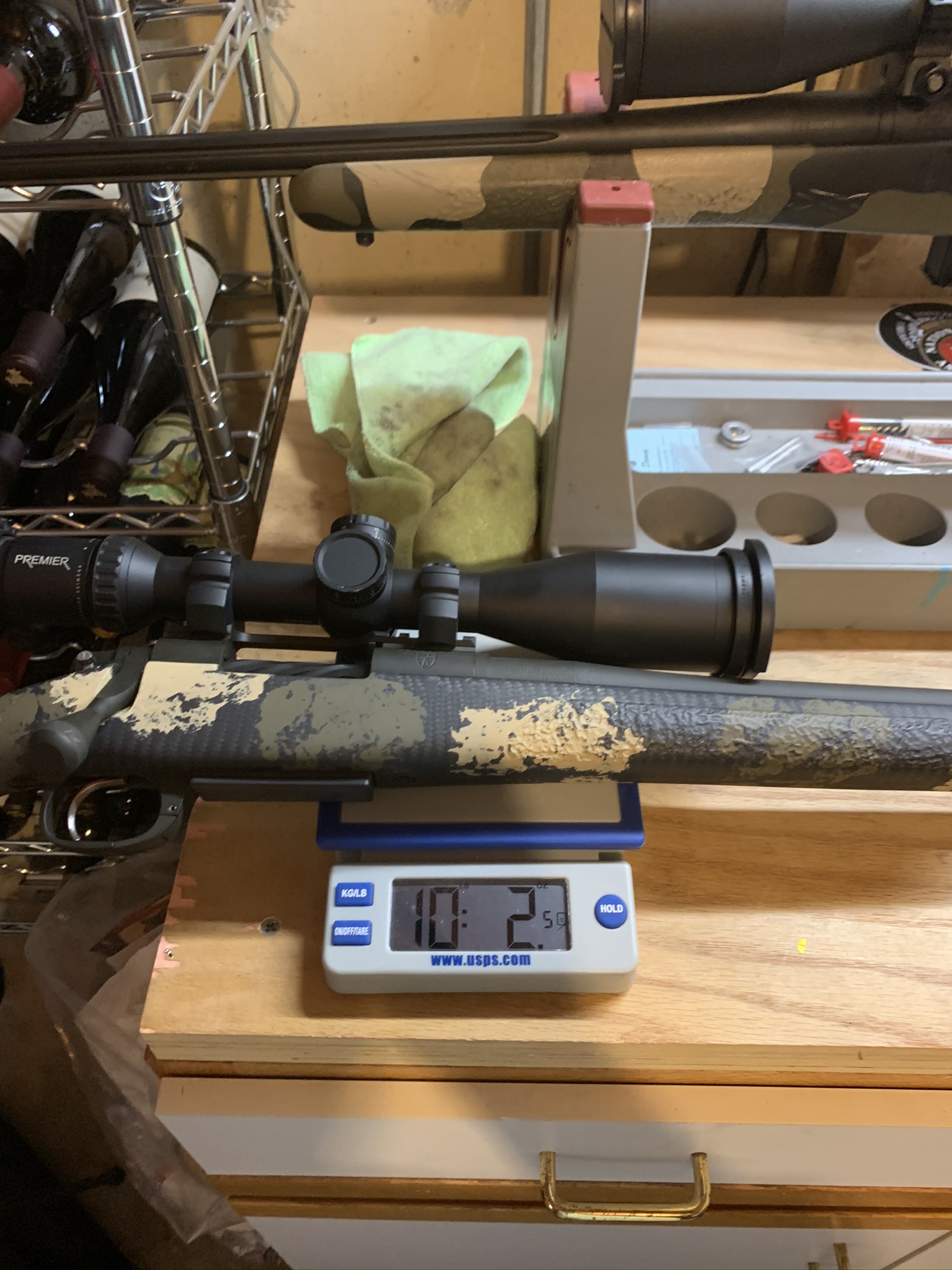

This is my version of your gun. Spitting 90gr TGK's at 3050fps. It weighs 9lbs all scoped up and suppressed. 6 Creed. 22" Sendero Lite, Origin, Jewell, HS Precision Sendero take off stock, HS Precision DBM. March 3x24

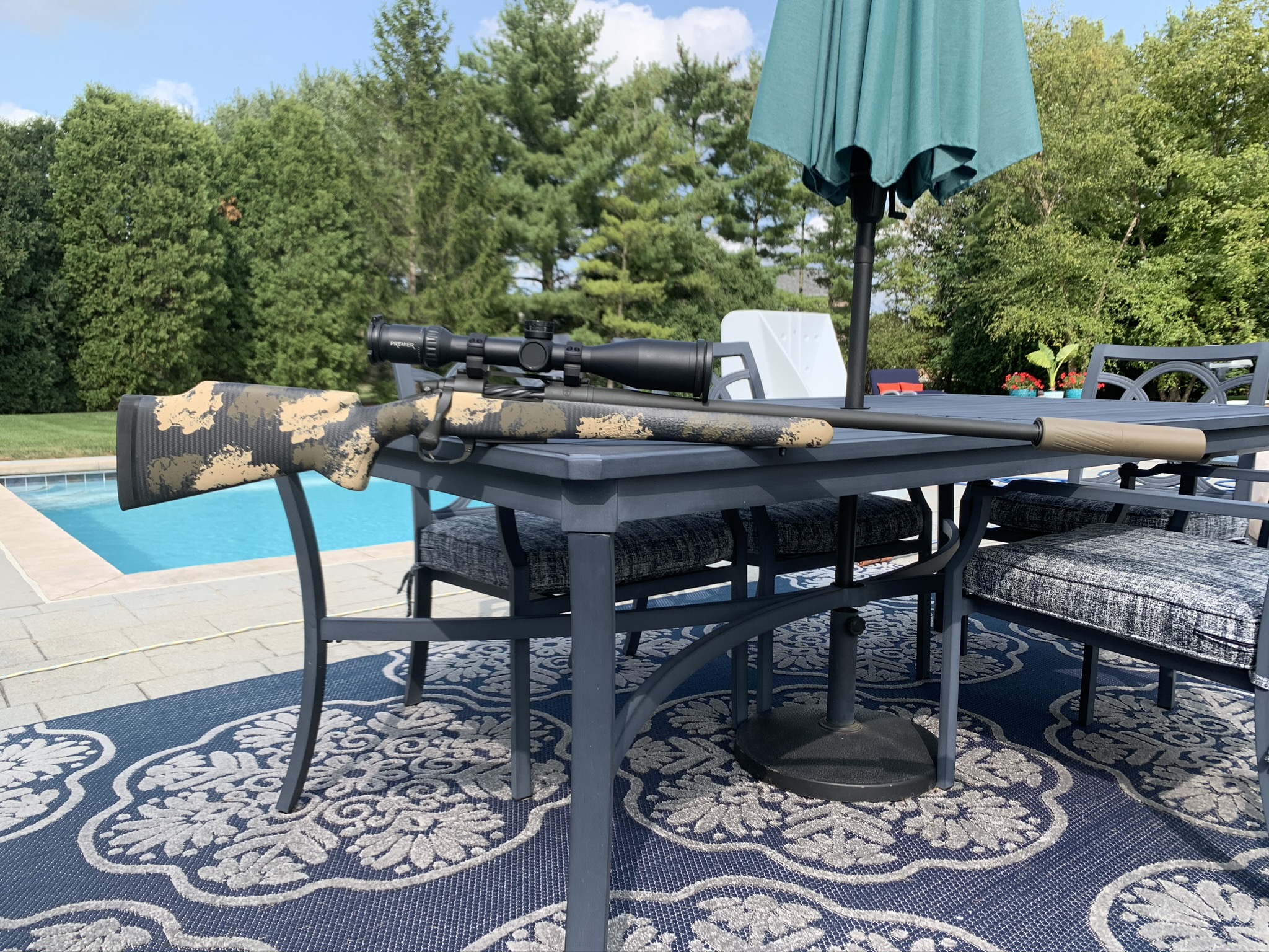

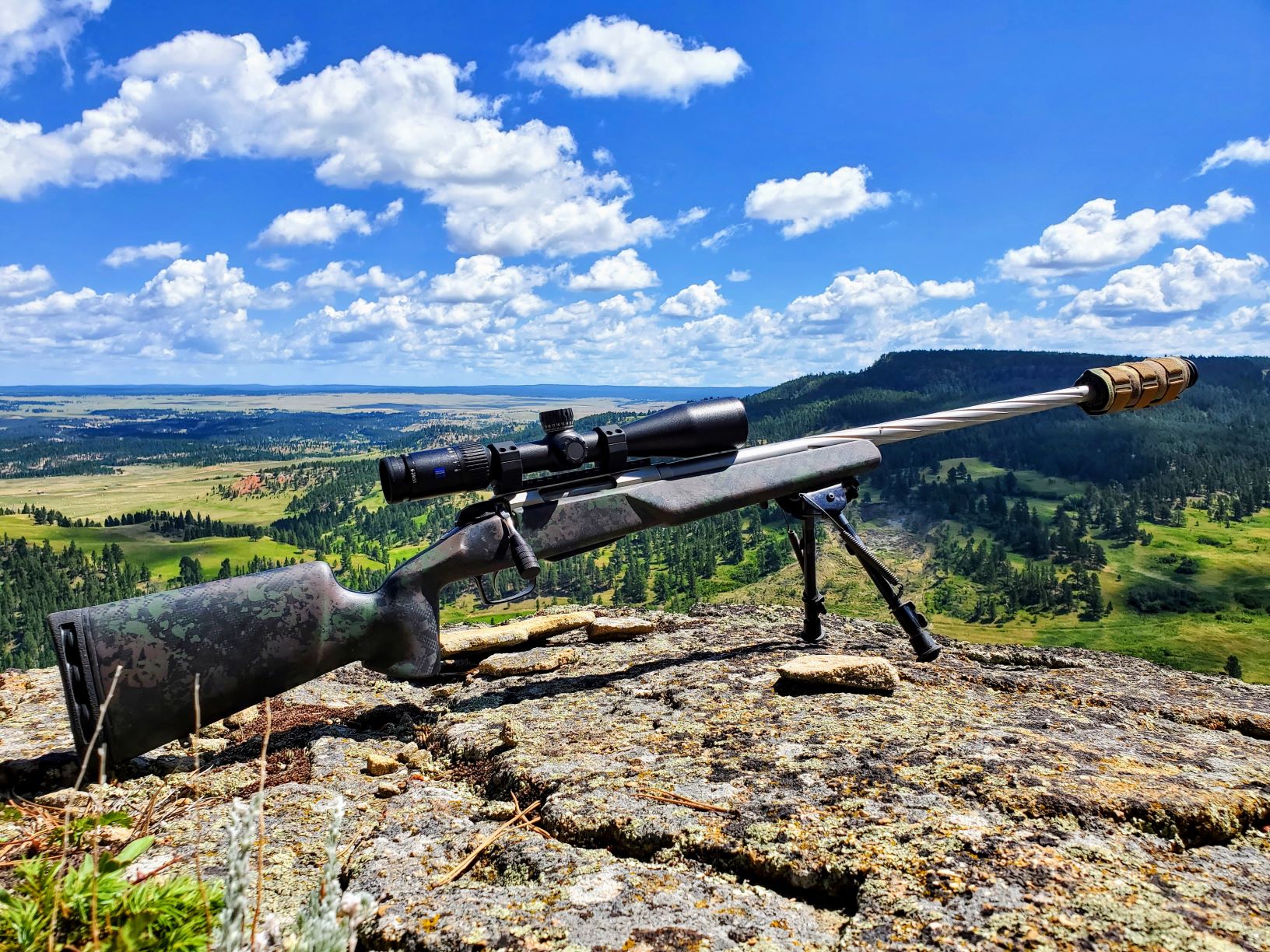

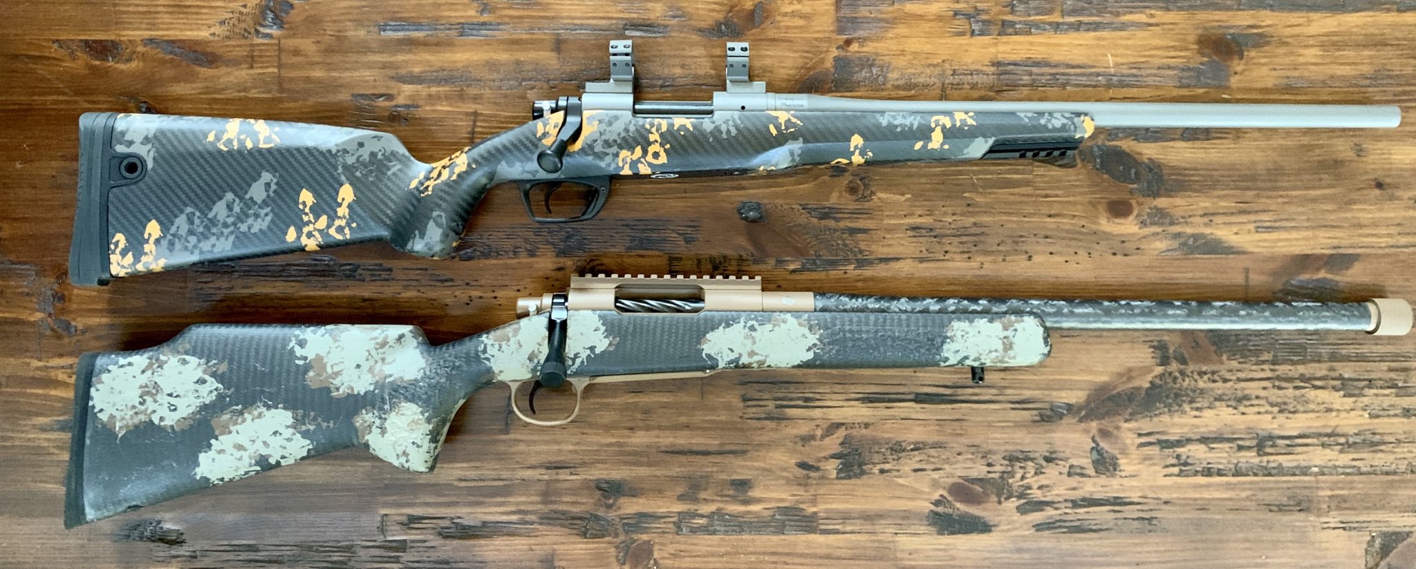

Here are two examples. Top one is a 700 with a 20” Krieger #2.5(smallest they’ll go in stainless) in 6CM, with a gunwerks ClymR stock. Weighs 7lb 1 oz. Bottom is a Lone Peak Razor, 20” Proof Sendero lite in 6.5 CM, with a manners EH4. Weighs 6 lbs 7 oz. These two would be identical in weight if it weren’t for the aluminum bedding block in the Gunwerks stock. The steel barrel gives up nothing to the proof barrel in terms of accuracy. I built these as demos showing two ends of the spectrum, the 6.5 is much more expensive than the 6 due to the components involved.
