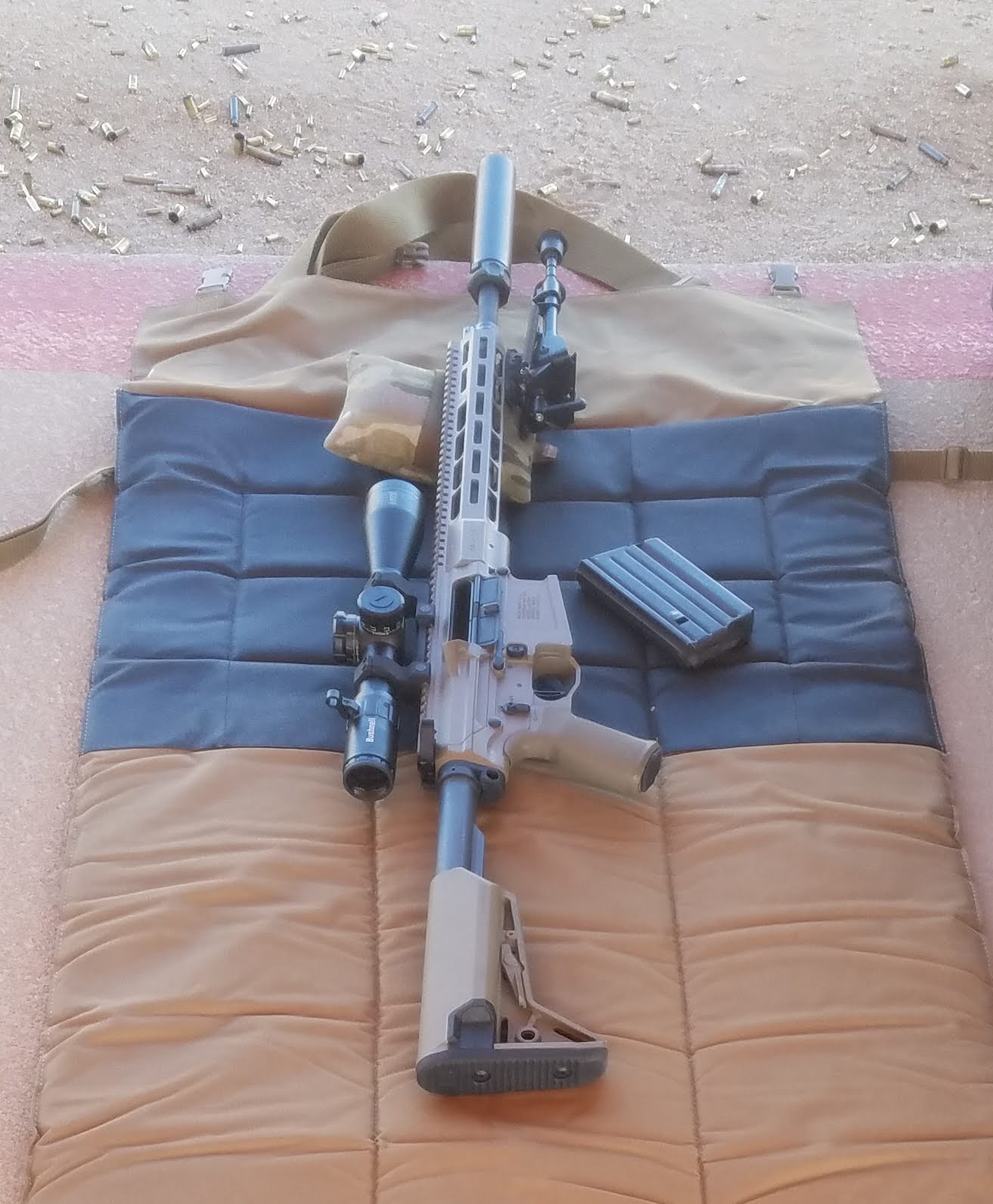

You are almost describing my old rifle! Only thing I had different was a LMT BCG and a KAC receiver extension with an H3 buffer and an LMT MWS spring. I had no issues with that rifle and it was mostly shot suppressed.
